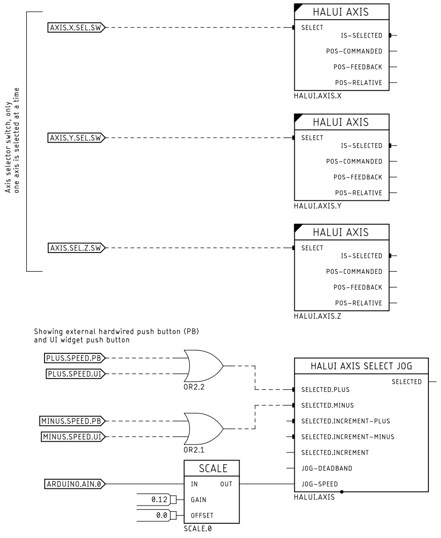

I have a physical pot that is driving halui.axis.jog-speed.
Implementation in postgui.hal is as follows:
# Jog Speed
loadrt scale count=1
addf scale.0 servo-thread
setp scale.0.offset 0.0
setp scale.0.gain 0.12
net jog-pot-in scale.0.in <= arduino.ain.0
net jog-speed halui.axis.jog-speed <= scale.0.out
This works in the sense that I can change the jog speed and then the next jog will use that speed. however if while jogging I tweak the jog speed value with the pot, halui.axis.jog-speed changes however the actual speed does not change (until the next jog). Is there a way to make the jog speed follow the pot/halui.axis.jog-speed value while jogging?

This certainly works for me using panel buttons connecting to hal pins 'halui.axis.L.plus' and 'halui.axis.x.minus'.
Push the jog button and simultaneously change the jog speed with the potentiometer from 0..100%
[edit]
Just noticed that I also feed the potentiometer signal to 'gmoccapy.jog.jog-velocity.direct-value'. So maybe Gmoccapy has something to do with it.

Maybe setting axis.L.jog-vel-mode to TRUE would cause in-process jogging to respond to speed changes?

I found a note somewhere that stated in axis the feed slider responds to halui.feed-override.increase and .decrease, however I'm using a pot feeding halui.axis.jog-speed not up and down buttons, so I think I'm out of luck with axis, unless there is some other method?This certainly works for me using panel buttons connecting to hal pins 'halui.axis.L.plus' and 'halui.axis.x.minus'.

Thanks for that, I tried but axis.L.jog-vel-mode does not help.Maybe setting axis.L.jog-vel-mode to TRUE would cause in-process jogging to respond to speed changes?
At least the feed-override acts dynamically, it even updates the slider in Axis when I twiddle the pot

halui.axis.jog-speed - This pin is for setting jog speed for plus/minus jogging.
To jog an axis you need to select axis, set jog speed using potentiometers and press plus or minus push button (PB) to jog axis.
Most CNC machines built using Linuxcnc use joint (There is a whole spiel about axis/joint, google it if you would like to learn more about it).
Attached are function blocks of halui pins for axis to help visualize the jungle of pins. Halui has over 100 pins, I divided the related pins into function blocks to ease the visualization.For your info I added an external hadwired PB and UI widgets for +/- jog, you can use either or both.
Linuxcnc hal netlisting
# Load realtime Components and their counts
loadrt or2 count= 2
loadrt scale count= 1
# Add functions to threads
addf or2.0 servo-thread
addf or2.1 servo-thread
# Set parameters
# Connect Pins with hal signals/Wires
net arduino.ain.0 scale.0.in
net axis.sel.z.sw halui.axis.z.select
net axis.speed.minus halui.axis.selected.minus or2.1.out
net axis.speed.plus or2.0.out halui.axis.selected.plus
net axis.x.sel.sw halui.axis.x.select
net axis.y.sel.sw halui.axis.y.select
net halui.axis.jog-speed scale.0.out halui.axis.jog-speed
net minus.speed.pb or2.1.in0
net minus.speed.ui or2.1.in1
net plus.speed.pb or2.0.in0
net plus.speed.ui or2.0.in1
