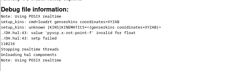

Using a HAL pin in DH parameters
- Abdulkareem
- Posts: 77
08 Sep 2024 14:06 #309657
by Abdulkareem
Using a HAL pin in DH parameters was created by Abdulkareem
- Posts: 4818
- Thank you received: 2176
08 Sep 2024 14:19 #309658
Replied by Aciera on topic Using a HAL pin in DH parameters

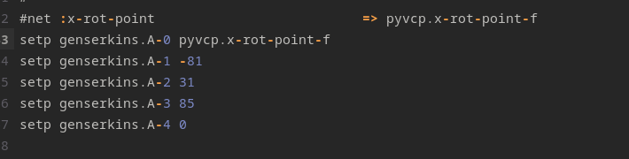

Not sure if 'genserkins.A-0' is a pin or a parameter but try using 'net' instead of 'setp'

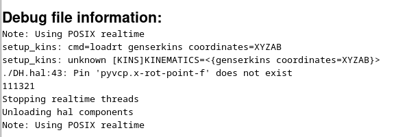

08 Sep 2024 14:28 #309662
The pyvcp panel only exists after the gui has loaded, so you will need to put that line in the POSTGUI_HALFILE

09 Sep 2024 07:07 #309713
by Abdulkareem
Replied by Abdulkareem on topic Using a HAL pin in DH parameters
tried that, but still getting the same error

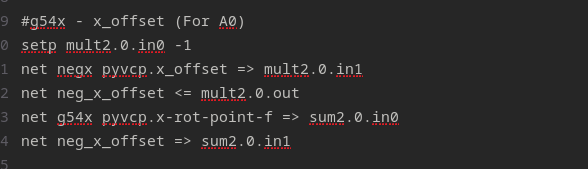

09 Sep 2024 07:41 #309716
by meister
Replied by meister on topic Using a HAL pin in DH parameters
how do you create the 'x-rot-point' widget ?
can you see the pin in halshow ?
have this widget an ...-f output ?
