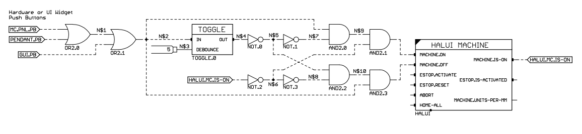

29 Sep 2024 21:31 #311044 by Benb
Replied by Benb on topic Button Toggle
Attached is a Function Block Diagram (FBD) and netlisting for toggling halui machine on/off. Since we are using FBD, signal names are insignificant in this case.  n.1 means net 1 ... etc. Hope this helps
# Load realtime Components and their counts
loadrt and2         count= 4
loadrt not            count= 4
loadrt or2            count= 2
loadrt toggle       count= 1
# Add functions to threads
addf and2.0                   servo-thread
addf and2.1                   servo-thread
addf and2.2                   servo-thread
addf and2.3                   servo-thread
addf not.0                      servo-thread
addf not.1                      servo-thread
addf not.2                      servo-thread
addf not.3                      servo-thread
addf or2.0                      servo-thread
addf or2.1                      servo-thread
addf toggle.0                 servo-thread
# Set parameters
setp toggle.0.debounce                           5
# Connect hal signals to hal component Pins
net gui.pb                     or2.1.in1
net halui.mc.is-on         halui.machine.is-on  not.2.in
net halui.mc.off             and2.3.out  halui.machine.off
net halui.mc.on             and2.1.out  halui.machine.on
net mc.pnl.pb                or2.0.in0
net n.1                          or2.0.out  or2.1.in0
net n.2                          toggle.0.in  and2.0.in0  and2.3.in1  or2.1.out
net n.4                          toggle.0.out  not.0.in
net n.5                          and2.2.in0  not.1.in  not.0.out
net n.6                          not.3.in  not.2.out  and2.1.in1
net n.7                          and2.0.in1  not.1.out
net n.8                          not.3.out  and2.2.in1
net n.9                          and2.0.out  and2.1.in0
net n.10                        and2.2.out  and2.3.in0
net pendant.pb             or2.0.in1

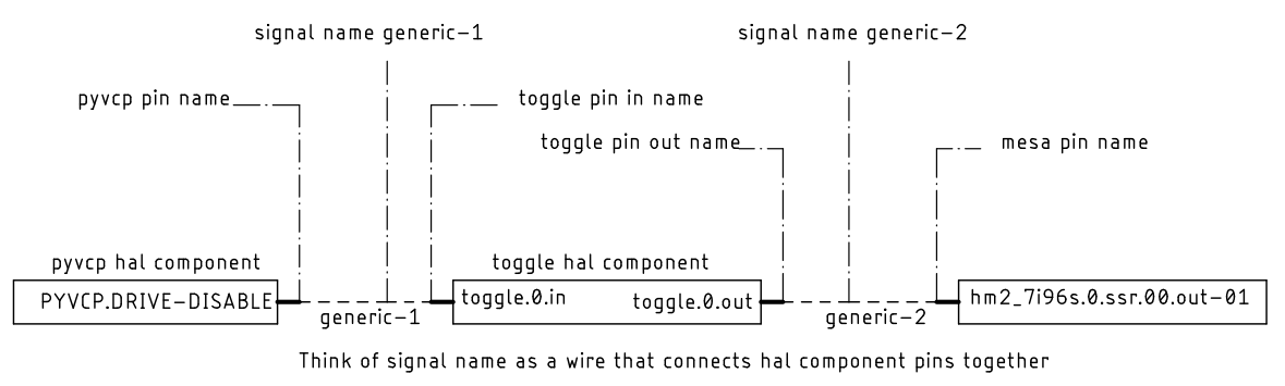

02 Oct 2024 02:24 #311138 by tommylight
Replied by tommylight on topic Button Toggle
Trying to understand why "generic-1" and "generic-2" are necessary.
Those can be "mom" and "dad", it does not matter, they are signal names that you freely assign to connections between hal pins
net generic-1 toggle.0.in <= pyvcp.drive-disable
can also be
net generic-1 pyvcp.drive-disable
and so can
net generic-2 toggle.0.out => hm2_7i96s.0.ssr.00.out-01
can be
net generic-2 hm2_7i96s.0.ssr.00.out-01
But your single line can not as you have it as there are two separate signals that have to be wired to 4 inputs/outputs.
Think of generic-1 (or mom or dad or) as a bus bar, toggle.0.in is one of the wires and pyvcp.drive-disable is the other wire tied together at the bus bar.
The following user(s) said Thank You: Benb, Project_Hopeless

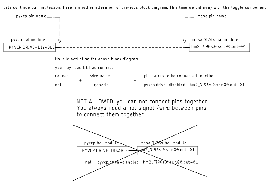

02 Oct 2024 05:29 - 02 Oct 2024 05:30 #311153 by Benb
It looks like you having problem distinguishing hal pin names from hal signal names. It's a common mistake by new linuxcnc hal users. further to Tom's explanation, I draw a block diagram, The dashed lines are your signal names generic-1 on the left and generic-2 on the right. If you connect them together you short circuit the input and output of the toggle component.
Last edit: 02 Oct 2024 05:30 by Benb.
The following user(s) said Thank You: tommylight, Project_Hopeless

06 Oct 2024 01:33 - 06 Oct 2024 01:36 #311382 by Benb
Here as another alteration of previous block diagram. This time we did away with the toggle componentOne thing you should learn is to draw block diagrams before you starting to write your hal netlisting. You will find as you start writing complex hal files block diagrams help tremulously in keeping you sane. I don’t know how to other members write their hal netlisting. In my case there is no way I can write hal without using block diagrams.
 If you look at the first block diagram to control halui machine on and off with one pushbutton. The reason the block diagram is complex because Hal which is real time program is communication with halui a user land non realtime program. The non realtime component timing is unpredictable and make RT comp communication with non realtime comp  difficult It requires trial and error intuition and luck to get to two to talk consistently no matter the jitter of the controllers.
I which someone could convert Halui to run in real time memory.
