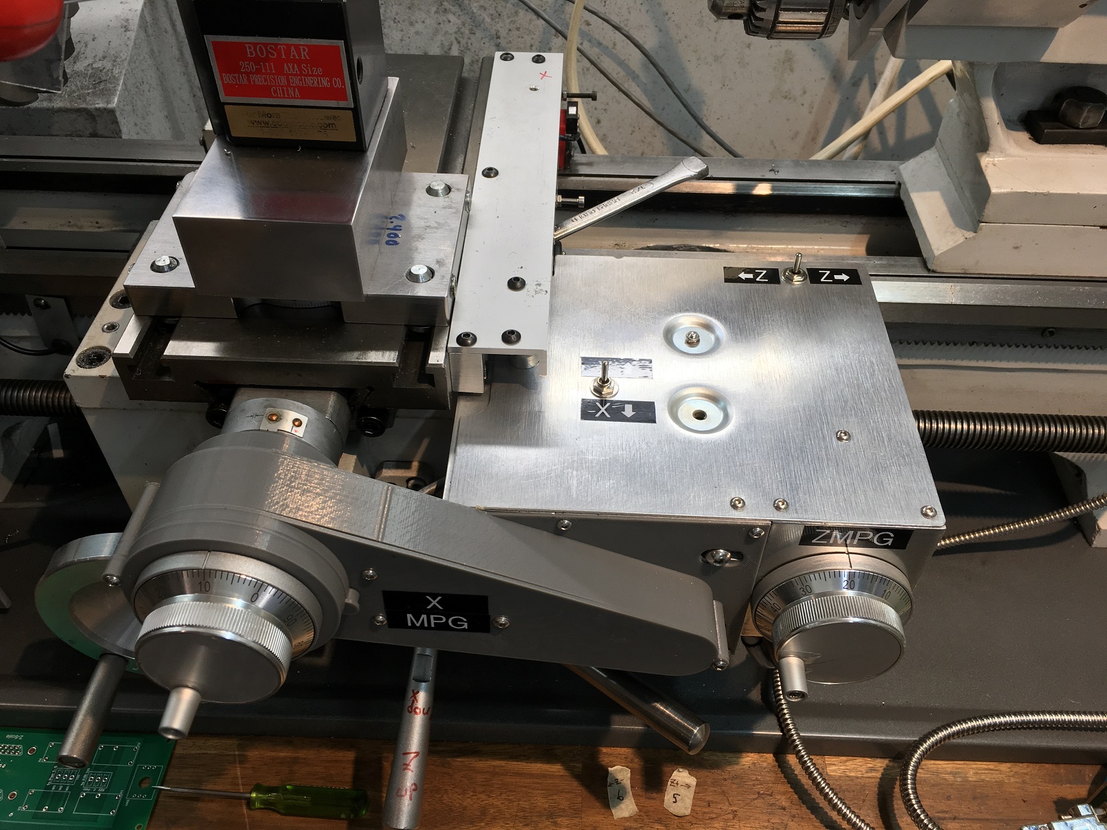

I now have the MPG working for the X axis and it was super simple (the example above gave me what I needed, and I only needed 4 lines to get it working
#MPG
setp axis.x.jog-scale 0.001
setp axis.x.jog-enable true
net encoder-counts <= hm2_7i96s.0.inm.00.enc1-count
net encoder-counts => axis.x.jog-counts
#MPG ENDS
I have switches to manually jog, so I will use those to move significant distances, and then use the MPG to home in on the desired position, should make for a user friendly experience.
I will likely upgrade to ball-screws to fix the backlash, however at least now when I change direction the backlash is automatically dealt with.
I 3D printed a belt cover and mounted the X-MPG where the old manual cross slide hand wheel was.
Thanks for all your help, a Mesa board and HAL make customization really easy.
