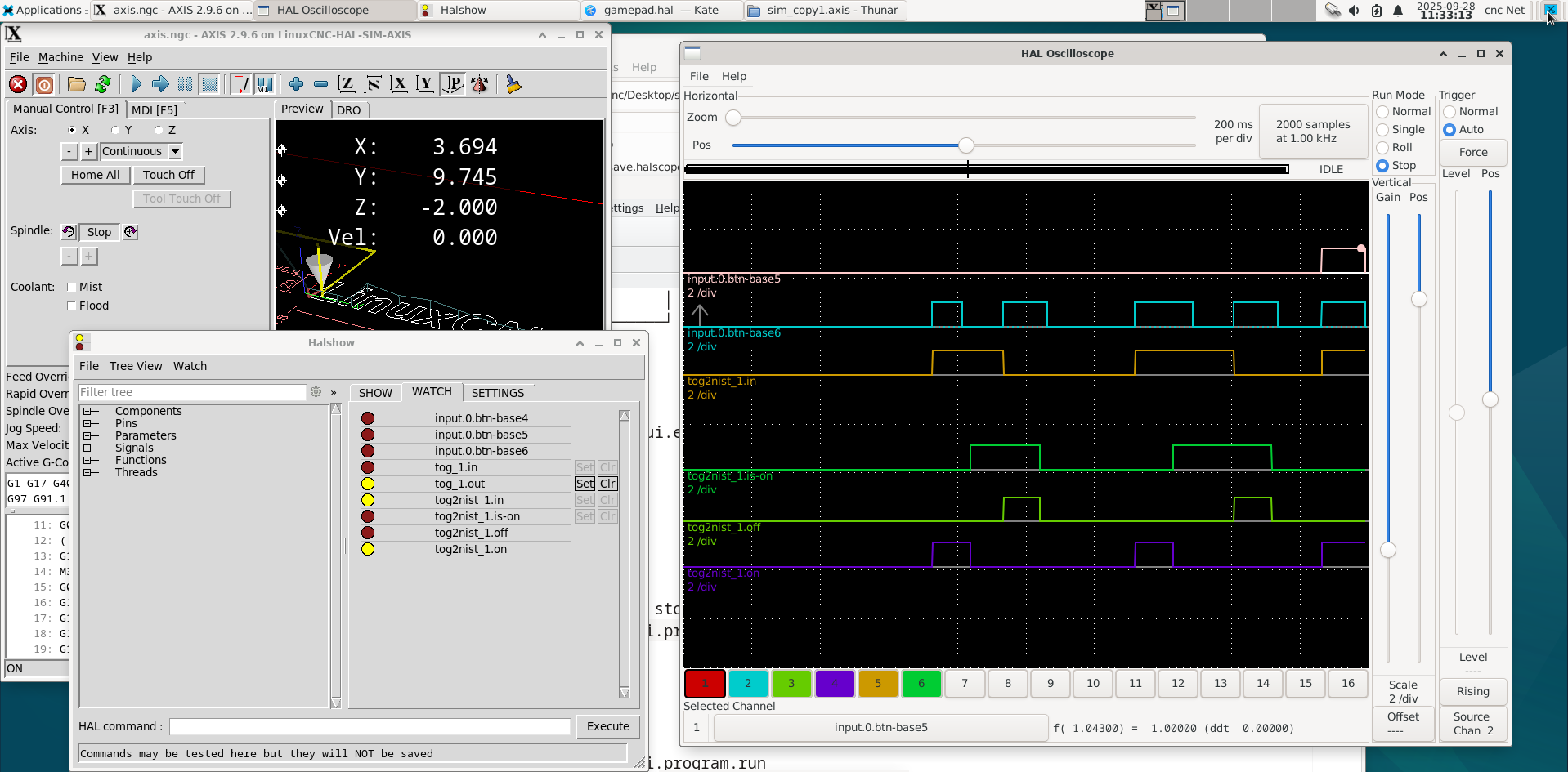

I have this gamepad.hal as an example for my problem.
This is used with the button of a gamepad.I start a program by a button, then I can pause/resume it by another button.The third button is to stop the program.
The problem I have: If the program is started and I press pause/resume and stop at the same time, sometimes the toggle2nist_on get stucked in on state and the pause/resume will not work until I quit linuxcnc and start again. Is this a known behavior, or is something wrong in my gamepad.hal

Replied by Aciera on topic toggle2nist hangs when pressing an other button at the same time
'toggle2nist.comp' up to and including 2.9.x has issues:
github.com/LinuxCNC/linuxcnc/pull/3193
A new version is available in master:
github.com/LinuxCNC/linuxcnc/blob/0bc97e...nts/toggle2nist.comp
which you could install into your version by downloading the new version and using
(sudo) halcompile --install toggle2nist.comp
Note that 'halcompile' requires the 'linuxcnc-dev' package to be installed
Also note that people used to work around some of the problematic 'toggle2nist' behavior by adding hal components between the momentary switch and 'toggle2nist.in'. Looking at your .in pin signal in the halscope sreenshot makes me think that you might have done that. If you use the new version make sure to directly connect the momentary switch to the .in pin.

28 Sep 2025 13:18 #335516
by juergen-home
Replied by juergen-home on topic toggle2nist hangs when pressing an other button at the same time
The Problem is the same as before.
@Aciera
So I did halcompile --install toggle2nist.comp.
I see a new pin toggle2nist_1.debounce so the update should be OK.
I also put the pause/resume signal direct to the toggle2nist without the toggle in front.
@andypugh
I dont understand "output pin from hal_input" my input pins from the gamepad are input.0.btn-base6 ...
@Aciera
@andypugh

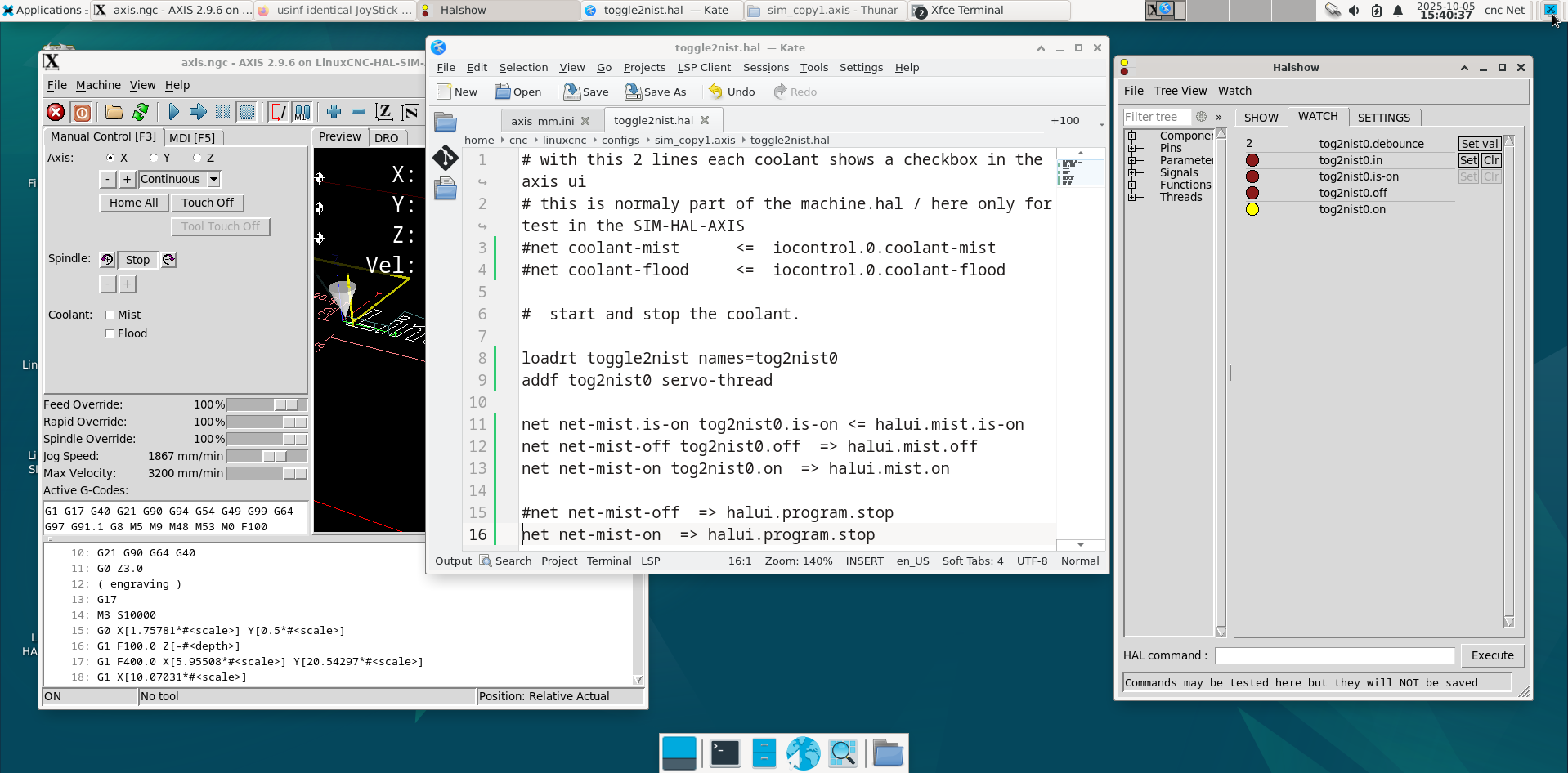

05 Oct 2025 09:01 - 05 Oct 2025 09:05 #335860
by juergen-home
To illustrate my issue with toggle2nist a bit more I have made a simple hal file.
The hal file makes no other sens as to show problem easily for testing yourself.
1. If I comment in
net net-mist-off => halui.program.stop
Linux runs as I expect. I can toggle the nist2 in halshow with set and clear.
If mist is switched off, a running program stops. I can start again and so on.
1. If I comment in
net net-mist-on => halui.program.stop
I can toggle the nist2 in halshow with set and clear only once.
If mist is switched on, a running program stops and the tog2nist.on LED is yellow all the time.
Is this working as expected?
1. If I comment in
1. If I comment in

05 Oct 2025 13:13 - 05 Oct 2025 13:50 #335873
The problem is that stopping a program will also switch off coolants (mist and flood). This is inbuilt behavior so by connecting 'halui.program.stop' in your hal example you are clearing 'tog2nist0.is-on' which upsets the logic.
When 'tog2nist0.in' goes true and 'tog2nist0.is-on' is false it sets 'tog2nist0.on' to true until 'tog2nist0.is-on' goes true. It then sets 'tog2nist0.on' to false. (So it basically produces a pulse on 'tog2nist0.on').
See the logic diagram in the manpage:
In your case:
When 'tog2nist0.in' goes true it sets 'tog2nist0.on' to true which causes a program stop which forces 'tog2nist0.is-on' FALSE so the component waits forever with 'tog2nist0.on' True.
One way around this would be to change the component to have a maximum waiting time for 'tog2nist0.is-on' to change state.
[edit]
Attached is a modified component.
As an example set '.pulse_length' to 1000. Mind you it will only fix the lockup state not the flawed logic behind the hal construct.
In your case:
[edit]
Last edit: 05 Oct 2025 13:50 by Aciera.

- Posts: 4819
- Thank you received: 2177
05 Oct 2025 14:01 #335875
To toggle program run/stop you would need to use :
loadrt toggle2nist names=tog2nist0
addf tog2nist0 servo-thread
net net-mist.is-on tog2nist0.is-on <= halui.program.is-running
net net-mist-off tog2nist0.off => halui.program.stop
net net-mist-on tog2nist0.on => halui.program.runPlease Log in or Create an account to join the conversation.

06 Oct 2025 12:51 #335929
by juergen-home
Many thanks.
I compiled in your magic code in. With a puls-lenght of 50 my problems seem to be gone. This should become the standard toggle2nist.
Many thanks!
