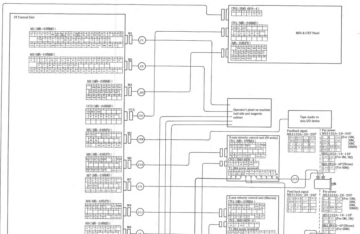

What is the best way to verify the ground? Measure the resistance from the machine frame to the drive frame and mesa boards frame?

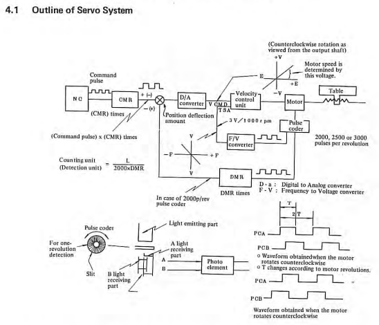

The machine was originally setup with a virtual tach using a f/v converter inside the Fanuc controller. Here is a diagram of the original setup.
Thank you again for the help!

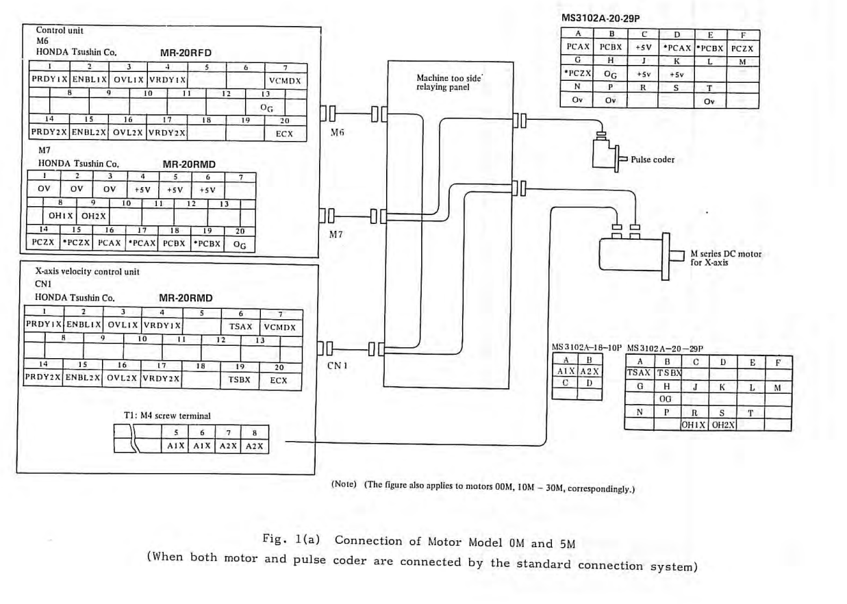

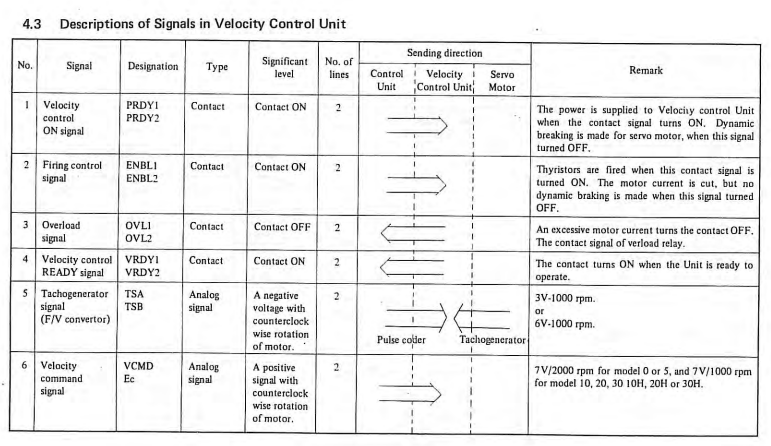

Do you have a document for the actual driver pinout?

Yes. I am connecting to the two honda connectors labeled J10 and J5 on this diagram.
Please let me know if you see any mistakes in this.

Looks OK
Might be worth disconnecting the analog hal pins in hal and just setting them
manually (connected and unconnected to the drive) to see whats going on.
