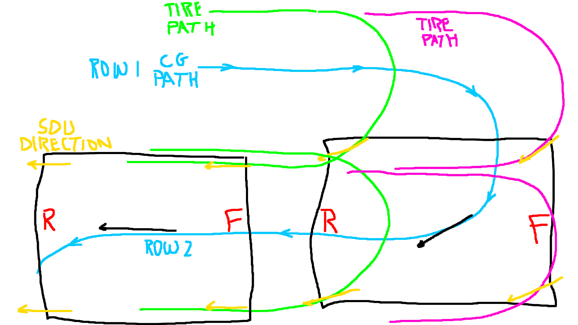

I was having a fun discussion with google AI about trying to build a 4WD 4WS gps guided lawnmower. The idea is to build a chassis with 4 "slew drive units" (SDUs), one on each corner. The SDU would consist of a drive wheel and a vertical rotation axis capable of +- 180 degrees. I currently have a very basic RC lawnmower I built. The only thing I don't like is doing 180s with it, it is only 2WD, but if you're not careful with it, it does dig into the lawn. It's "skid steer", no turing steering, just casters.
So my new concept with the 4 SDUs would have 2 distinct drive modes:

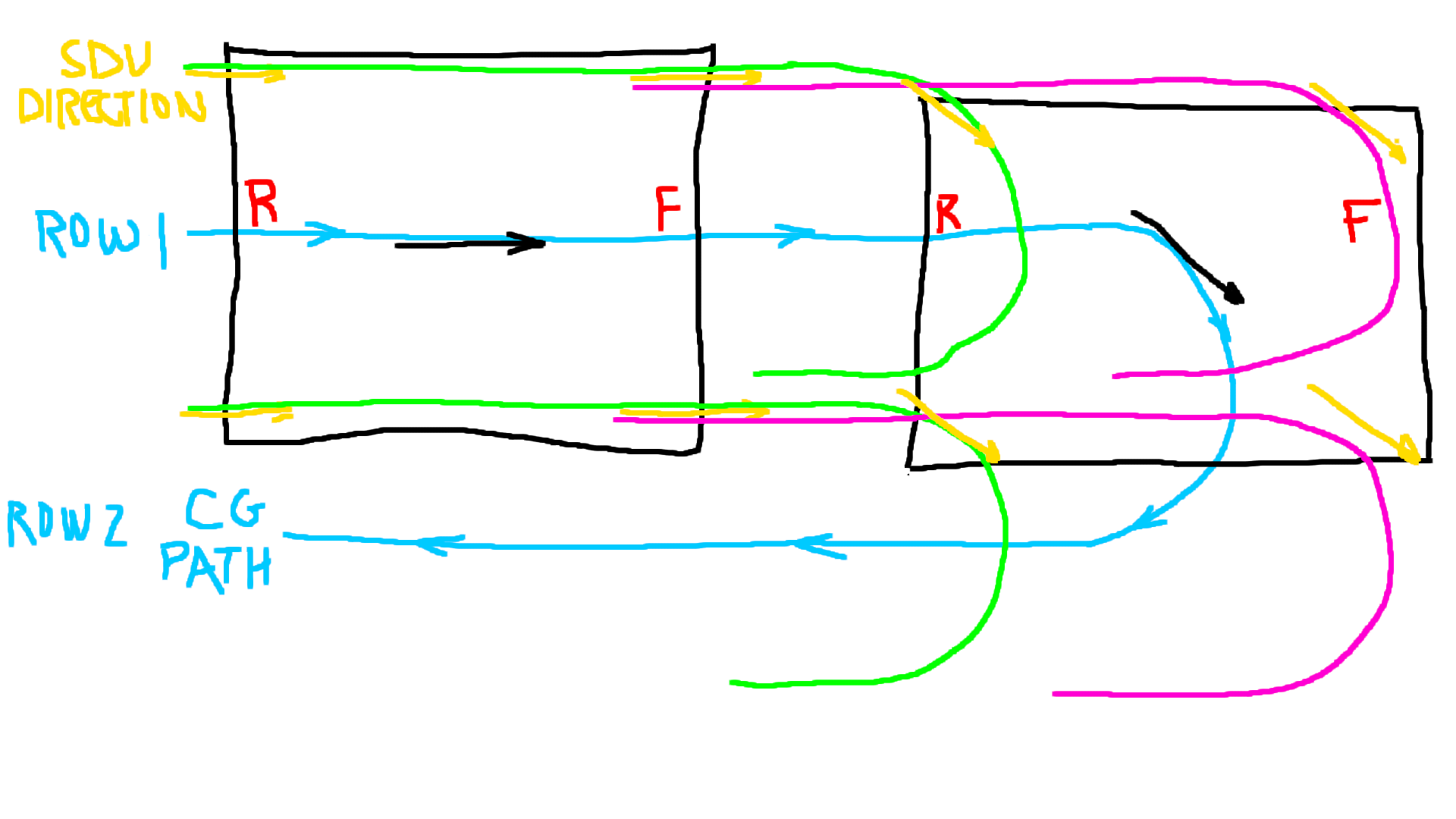

1. conventional curve follow mode. this would pretty much act like a 4WD platform and it would use front and rear steering to gently follow medium size curves up to straight lines. The "body" of the platform would align with the direction of motion following the curve. Say during a mild left curve the front 2 SDUs would turn a bit left and the rear 2 SDUs would turn a bit right to allow a nice following of the curve and keep the platform aligned with the direction of motion.
2. transition to next "parallel" row. this would be kind of like a zig pattern in machining. The idea is to transition at the end of one row to the beginning of the next row without any tight turns or reversing wheels spinning on the grass. If the machine is moving say, directly East and it arrives at the end of it's row, the main platform is pointed East and will maintain that Eastward direction as the 4 SDUs "slew" each steering unit through a 180 degree rotation that drives it to the next row, say to the South, all 4 SDUs would turn say 30 degrees to the right and keep driving "forward". During this transition, "forward" eventually become directly to the West (after each SDU has completed a 180 degree arc), but the platform body is still facing East. Each SDU will follow a "perfect" 180 degree equi-radius path bringing the still-facing-East-platform to the next row. The exact opposite of this would happen at the end of the West running row (and untangling the SDUs wires) to bring everything back to normal at the beginning of the next East facing row.

09 Sep 2026 02:39 #349481 by Johnsinski
Replied by Johnsinski on topic 4WD 4WS gps guided lawnmower.
Please excuse the crudity of these drawings. I didn't have time to build it to scale. (Doc Brown BTTF reference) ;)
09 Sep 2026 03:18 #349483 by rodw
Replied by rodw on topic 4WD 4WS gps guided lawnmower.
It seems to me the lawn is really an XY plane with no motors on the axes and the tyres follow a tangential arc and provide the drive.
I think the new motion.interp.heading pin in master branch could solve this. You give the mmachine fake XY g1/g2/g3 moves including the arc at the end and tell the tyres (eg A axis) to follow the heading. If the front and rear wheels need to follow differing arcs on a turn, you might need to adjust/scale the heading using a real time component. Perhaps the spindle speed (S command) might set the rpm on the wheels.
I think with this new feature, solving your problem is a lot simpler than you think.

12 Sep 2026 07:19 #349594 by rodw
rodw, oh I saw you on youtube! The new motion.interp.heading pin looks to give you the tangent angle of the current point on a path? That seems helpful.
oh well, tried to attach gifs of the two motion strategies, but didn't work.
Yes the heading gives you an arc tangent to a G2/G3 move which is the direction the wheels should be pointing to drive it. When you revert to a G0 or G1 move, the heading is simply the direction of travel which should also be where both wheels are pointing
Now in the case of  the inside wheel needing to travel  a shorter arc radius than the outer wheels, you should be able to calculate that from the outer arc.
