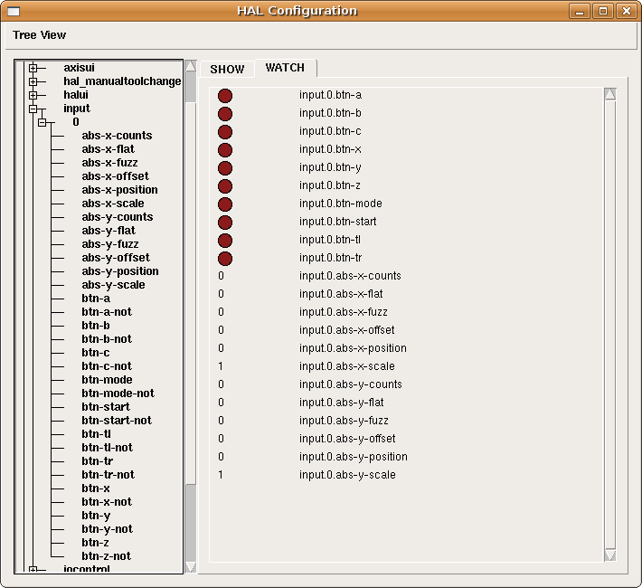

Dear all,
I have try to install my sidewinder (gameport joypad) in ubuntu 8.04 and verify the function by jstest. However when I follow the wiki
wiki.linuxcnc.org/cgi-bin/emcinfo.pl?Simple_Remote_Pendant
to config the .hal and .ini file, EMC2 cannot be run and has following error msg
do I need to switch the joypad from gameport to usb in order for emc2 to config easily?

- BigJohnT
- Posts: 6999
- Thank you received: 1176
22 Feb 2011 11:32 #7372
by BigJohnT
Replied by BigJohnT on topic Re:using gameport joypad in emc2
What did step 2 print out?
John

- lazybug
- Posts: 5
23 Feb 2011 03:43 #7394
by lazybug
Replied by lazybug on topic Re:using gameport joypad in emc2
step 2 identify your joypad
I: Bus=0014 Vendor=0007 Product=0001 Version=0100
N: Name="Microsoft SideWinder GamePad"

- BigJohnT
- Posts: 6999
23 Feb 2011 14:03 - 23 Feb 2011 14:04 #7406
by BigJohnT
I should have told you to attach your hal and ini files...
is your loadusr line similar to the following?
loadusr -W hal_input -KRAL Sidewinder
Best way to trouble shoot is to add one line at a time then run EMC.
Also, did you do the subsystem thing at the bottom of the page?
John

- lazybug
- Posts: 5
24 Feb 2011 04:11 #7422
by lazybug
John, thank for your suppot
here is the hal and ini
Sorry I don't understand what is the meaning of "subsystem thing at the bottom of the page"

- Rick G
- Posts: 27
- Thank you received: 155
24 Feb 2011 12:12 #7430
by Rick G
Replied by Rick G on topic Re:using gameport joypad in emc2
John is suggesting you may need to add the file...
"If your system won't recognize the joypad you might have to look at hal_input man page and perhaps modify the permissions to access the device.
Prepared a one line file as per the description in the man page.
SUBSYSTEM=="input", mode="0660", group="plugdev"
Name the file 51-plugdev.rules and save it in /etc/udev/rules.d "
Rick G

- lazybug
- Posts: 5
25 Feb 2011 10:33 #7447
by lazybug
Thanks for Rick to point out this. I just over look the link. Now the joypad works.
As my SideWinder joypad don't have z-axis control, there is no way for me to jog this axis but it's fine for me. And I find that the name of the button/ctl have a big difference also. Here is my M$ SideWinder (10+years old) HAL configuration window screenshot.
