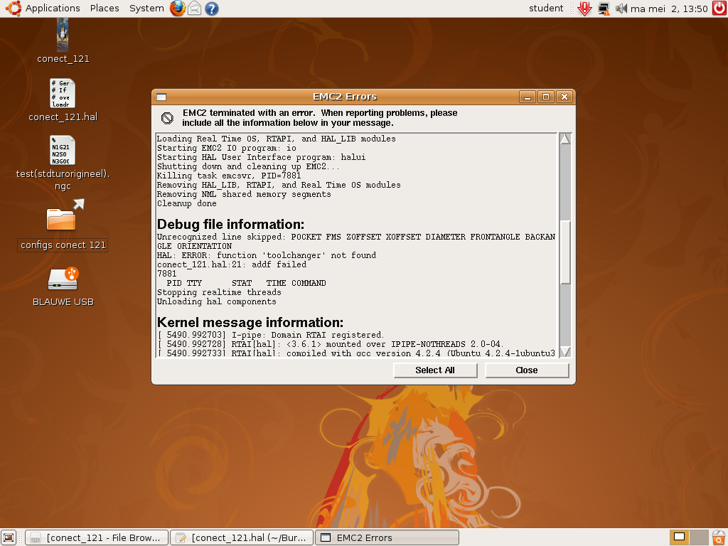

i did the essential,
it already was installed
so i still have no clue on fixing it

Replied by BigJohnT on topic Re:Tool Changer
I think you need to check your spelling and the file name, I just copied the comp from page 1 to another computer in my home directory and named it as required toolchanger.comp and ran sudo comp --install toolchanger.comp with no issues. Then I added loadrt toolchanger and addf toolchanger.0 servo-thread to a config and verified that it is there.
