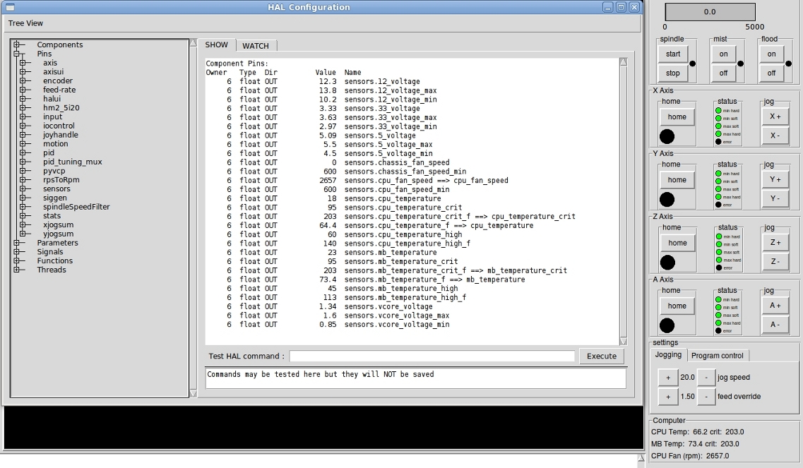

So I wrote a HAL component that I use to extract all the motherboard sensor readings and make them available as HAL pins, and in turn display them in my pyVCP. Attached is a python component and JPG snapshot of it's output (on my computer). I thought this might be handy to someone else out there. It will automatically detect most motherboard sensor readings, parse them, and make them available in the HAL...
Hope someone else finds this useful...

Sure... You'll find the sensors related parts at the very bottom of the attached XML file.
Note: each computer has different types of sensors, and different things will show up in the HAL depending on what the python script is able to find. You'll need to go into EMC and look at what it finds and how it names the pins, then reference those in your pyvcp.xml
Hope this helps...
