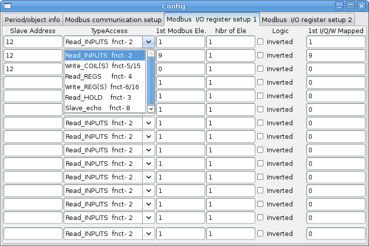

good afternoon everyone, I am trying to do little things at the classicladder, and I looked at the manual, one thing that I find how to do to be able to extend network range of addresses with their respective inputs or outputs
How I can insert another page modbus i / o setup register?
Greetings to all and have if someone can guide me

if I need to extend the range of addresses off with more than 15 as I can place another page address? I never looked manuals and the wiki but i can not find anything about it, can guide me?
thanks
Albet

hello good, I'm trying to find somewhere but can not find information on how to expand the address records, you may not be? could someone help me where to start.
regards
Albert
regards
Albert

integrator manual and looked at me, but that variable is the page which raises the modbus i / o setup register?
regards
Albert
regards
Albert

15 entries is all classicladder has.
not that it couldn't have more but would need to be editted and recompiled.
Why do you need so many?

What version of linuxcnc are you using?
your pic is not from 2.5 ....
