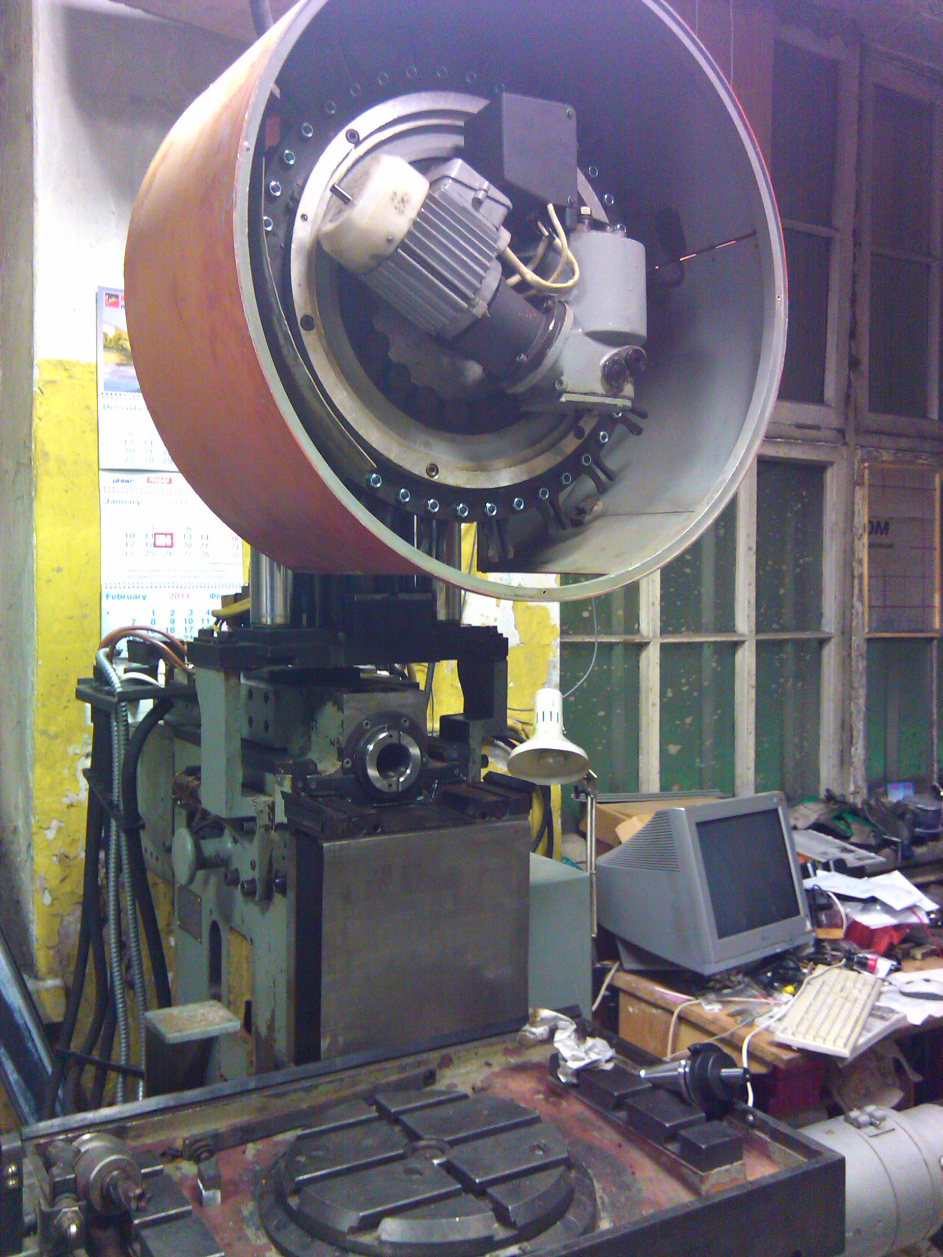

Hello, again!
This is my monster ATC-system for 20 tools:
Tool changing process:
1. Stop spindle, go to y=160.
2. Orient spindle.
3. Tool-magazine go down.
4. Unlock tool.
5. Go to y=205.
6. Rotate magazine for new tool.
7. Go to y=160.
8. Lock tool.
9. Tool-magazine go up.
10. Disorient spindle.
Now i am trying to animate it with Classic Ladder, and the first question is in points 1,5,7 - how to perform movement to exact machine coordinates while process of tool changing (betwen iocontrol.0.tool-change -> iocontrol.0.tool-changed)?
I already try MDI_COMMAND = G0 G53 Y205 in .hal-file by executing halui.mdi-command-00, but it works only when iocontrol.0.tool-change is not started (for example when i start my process with pyvcb button in "hands" mdi-mode).
What is the right way for such type movements??

I think you might want to visit the
tool change remapping
that is in master.
Impressive tool changer! I can't wait for the video...

Looks like i have to implement all tool changing process in phyton, but it's too complicated for me, and i almost finish program for tool changer in Classic Ladder.
Is it somehow possible to control movement of axis by Classic Ladder (i.e. by sending hal-comands? Or maybe i can execute pyton scripts, by sending hal-commands from CL?)

I'm not aware of any way to move an axis via classicladder. It might be possible to write a comp and use a hal pin to hijack the Y axis and move it in and out. Take a look at the thc component to see how I hijack the Z axis for torch height control. Also be aware of the tool change preposition options in the EMCIO ] section of the ini file that allow you to position the axes before the tool change.

It is, however, possible to move a motor without it being an axis. For example you can connect the stepgen or PID to a G-code analogue output pin, or an output from Classic Ladder.
for example instead of
net V-pos axis.7.motor-pos-cmd => stepgen.7.position-cmd
you could use
net V-pos motion.analog-out-00 => stepgen.7.position-cmd
(pin names are illustrative and are not necessarily correct)
What is not so easy if you do this is homing the joint. You would need a homing routine written in G-code or inside Classic ladder.
(I imagine that G-code homing would have to use a conditional loop and a sequence of short moves, so might be a bit inelegant)

No, you can actually program all the moves for the toolchanger as a G-code subroutine, as long as all motions of the toolchanger can be programmed to look like machine axes. (ie, you would set up the toolchanger motors to be be some of the ABCUVW axes).Looks like i have to implement all tool changing process in phyton, but it's too complicated for me, and i almost finish program for tool changer in Classic Ladder.
