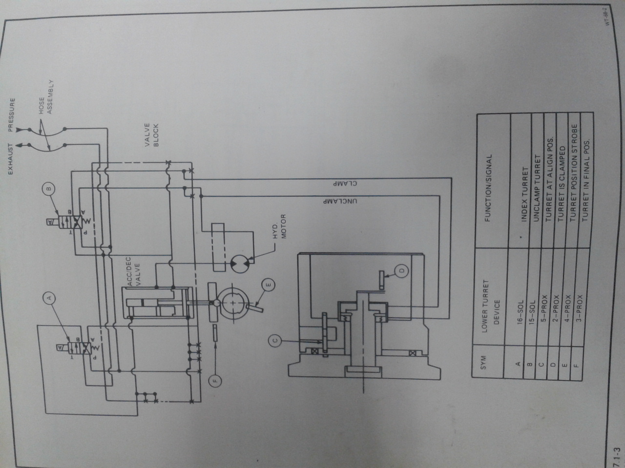

31 May 2013 22:57 #35036
by jlviloria
Replied by jlviloria on topic question counter, problem tool number.
here is the description manually.

31 May 2013 23:02 #35037
by BigJohnT
Replied by BigJohnT on topic question counter, problem tool number.
Ok, one method you can initialize your counter is to create a homing routine in your ladder.
If your in position 1 skip homing and set position counter to 1
If not in position 1 index counter 8 times, when position 1 is reached reset position counter to 1
when finished set tool number and set tool change finished.
You will need 2 counters one to do the homing index and the one for position.
Of course there will be a bit more logic needed but this is the general idea.
To do this in a simple way and make the code easier start in position 1 and before you turn the machine off move to position 1. Issue a T1 M6 G43 from a MDI button to set the current tool.
I hope this gives you some ideas to work with.
JT
