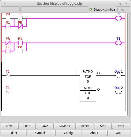

I am trying to get when you push one button, one output fires momentary. Push the same button a different output fires momentary.
Basically it is a flip flop. the monostable is being depricated, so I have to try and do it with the new TM timers.
But classicladder if you have two outputs the same re: two Q4, it treats it as an and. push it once you get first output push it again you get the second output and only then would you get its child contact. With regulat PLC's you can have as many outputs and anyone of them fire you get the child contact.
So I am struggling with this. Anyone have such a ladder or can I do it in HAL?

I'll try with a counter.

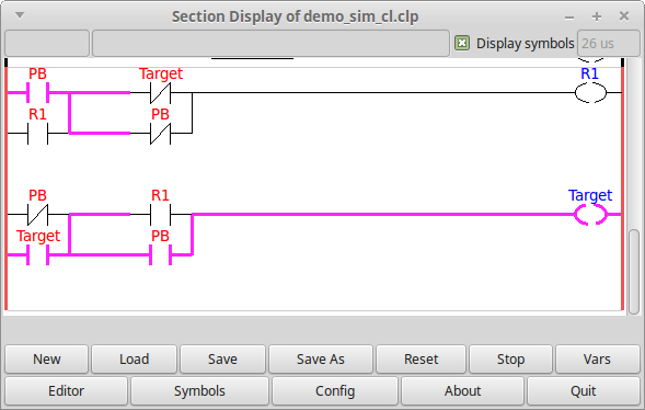

If you put the EIC timer in TP mode I believe it works the same as the mono.
This is similar to what you want I think:
wiki.linuxcnc.org/cgi-bin/wiki.pl?Classi...ret_indexing_counter

This kind of works but sometimes it doesn't flip it just energizes the same output. It will energize the same output twice and I cannot figure out why. The logic looks correct.

switch bounce?

I shortened the delay drastically and it seemed to have worked.
