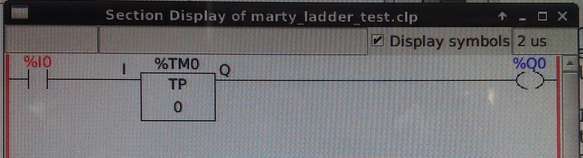

Hello.
I have a pneumatic way lube pump, pressure lifts the plunger, then release of that pressure squirts in lube to the ways.
The cycle is approx once every 4 minutes while the machine is under motion (has a feed rate).
The timer should be cumulative, ie if motion stops 3 minutes in, then when it resumes again, the timer will activate after the remaining 1 minute of motion thereafter.
The timer resets and continues to time up in the same fashion, cycle after cycle.
I thought this would be a great way for me to explore classic ladder in a simple way and learn along the way.
I was hoping someone could tell me how close I am to being on the right track.
I am trying to use a comp function with hysteresis to define when the machine is in motion (ie when a feed rate is TRUE).
I think my syntax on that function is slightly off.
But, here is a copy of my custom.hal and a picture of the world's simplest CL.
Whilst this will progress to being in use on my machine, breaking the ice with CL is important to me too.
I can already see that I need to de-power the air solenoid after its stroke to allow the cycle to recommence correctly from its NO state, but I'm not sure how to accomplish that.
Very intrigued how it all ties together.
Thanks for all the help.
Cheers,
Marty.

It's been a while since I did my Hardinge but IIRC I used two timers one for on time and one for off time and motion.current-vel to know I was moving. I'll try and dig it up in a bit.

The first rung is a self reseting timer. A TP timer the output is on until the count is reached. As soon s the count is reached the first timer resets to 0 and starts to count down again. Might not be the best way but it's what I came up with 2017.
The second rung when the output bit goes from off to on that timer starts and the output from that goes to your pump.
JT
