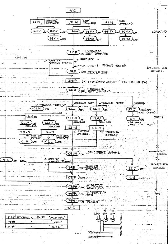

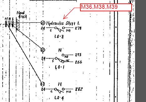

    In the block diagram , there is an "inching" function that slowly rotates the spindle and turns the solenoid on/off for a specific amount of time. I think was to help it shift gear but, i'm not sure. Also, I'm hoping that eventually this could be used with a gearchange component and remapped S code to automatically select the gear based on spindle speed...One thing at a time I know

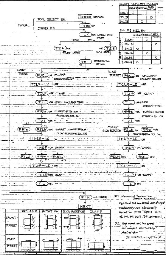

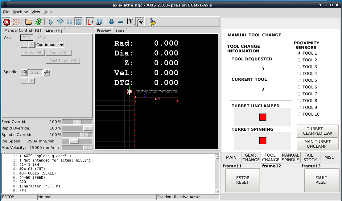

The original block/flow diagrams are attached. I have the remap all set-up for these codes and a glade-vcp that simulates the tool confirmation reed switches, and use bits to simulate limit switches but I can't quite seem to get the logic right in classicladder. Is there a logic guru out there that can sort this out?

Turret logic:
In your case turret has sensing for Turret clamp TCLF.
But no physical sensor for turret unclamp.
So in internal hardware logic they make condition , so that
Turret unclamped confirmation = Turret unclamp solenoid SOL1 ON+Turret Clamped TCLF switch is off +time 1.5sec .
Assume this signal Turret unclamped (TUCLF). Or ok for turret rotation
Once (TUCLF) is ready may enable Turret rotation solenoid.
There are two turret rotation solenoids.
one slow and other for normal or fast
Selection of SOL2A or 2B is decided by (PLC) based on the number of station between current turret position and your required position in AUTO tool command Txxx . If the station difference (distance to go) is < or =1 then only slow solenoid has to be on.
This is to ensure that turret will stop at consistent position during clamping at index position .
Slow Rotation Solenoid should switch off after INDF-LS is switched on.
This is like OK to clamp position.
Now switch off the unclamp solenoid SOL1.
Note that Turret should clamp only when INDF-LS is on.
Otherwise it should keep unclamp solenoid ON as other are improper position.
Regarding the 10 turret position sensor inputs you must convert it into bcd code to compare actual position and T- command
Gear change:
You have 3 position Gear1,Gear-2, Neutral
Gear shifter cannot move to required position unless gears are aligned to move.
So it is normal practice to oscillate the spindle while gear shifting (command value should be slow like 5 to 10 rpm)
If you are using ladder logic you may require minimum 3 or 4 timers
Like timer for Spindle index on /spindle index off / restart index timer / solenoid on time
You must enable the solenoid only when spindle index is off (spindle not enabled for oscillation).
If no confirmation of the required gear position then it should repeat the spindle index sequence
Even you can make with for/rev alternatively with different logic for oscillation.

14 Apr 2018 06:28 #108988 by sivaraj
Replied by sivaraj on topic Mazak Slant-turn 15 CNC Lathe Turret Logic
Sorry I referred Rear turret logic .
Your flowchart meant for twin turret machine .Front /Rear
For you case Slantturn 15 has only Front turret
The Flowchart for Front turret rotation :
1.FUCL > Front turret unclamp solenoid is on
2.TCLF-LS >Turret unclamp limit switch goes OFF
3.TCL >Turret clamp signal off or is unclamped
4.T-L > timer to unclamp un-clamp confirmation
5.T01 >whether goal distance is < or =1
it decides slow speed or high speed
*1 note says for disk type turret it is mechanical.
So I hope it will be FRW only for fast and FRW+FSLW for slow rotation
6.Once turret rotation in slow speed it will rotates till finding INDF index signal is ON
7.If INDF=1 It switches off all three solinoids FSLW FRW FUCL
8.TCLF-LS >Turret clamp limit switch signal will come on
9.TCL> tool clamp confirmation

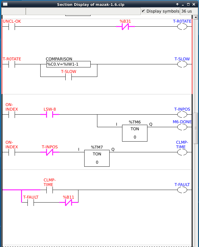

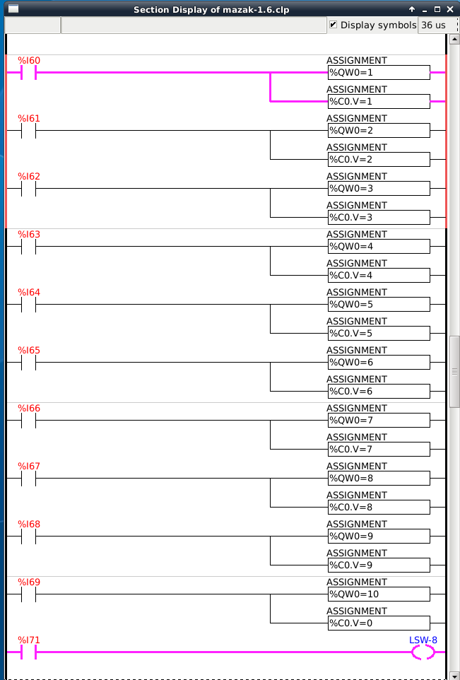

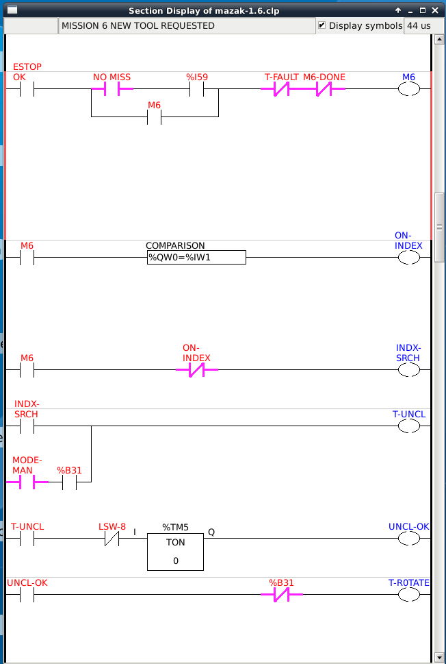

16 Apr 2018 23:45 #109148 by sqmathlete
Replied by sqmathlete on topic Mazak Slant-turn 15 CNC Lathe Turret Logic
Ok, this is what I have come up with.
The proximity switches are simulated by radio buttons in the gui so that only one can be active at a time.
The higher level logic is controlled by a mission pattern. Mission 6 (M6) is called by a tool change request (classicladder.0.in-59) and ended when the tool is in position (T-IN-POS).
The M6-Done coil is delayed so that linuxcnc has time to acknowledge that the tool change is done before M6 is reset. Also by not sealing in the index comparison, if for some reason the index switch is not on when the turret is clamped the cycle of unclamp=>rotate=>slow-rotate starts again...I think.
The fault coil at this pint doesn't do much but, I think it could be used to time the closing of the turret?
An unseen counter takes care of looping from tool 10 to tool 1
Any thoughts or questions?
P.s. I'm still working on the gear change.
