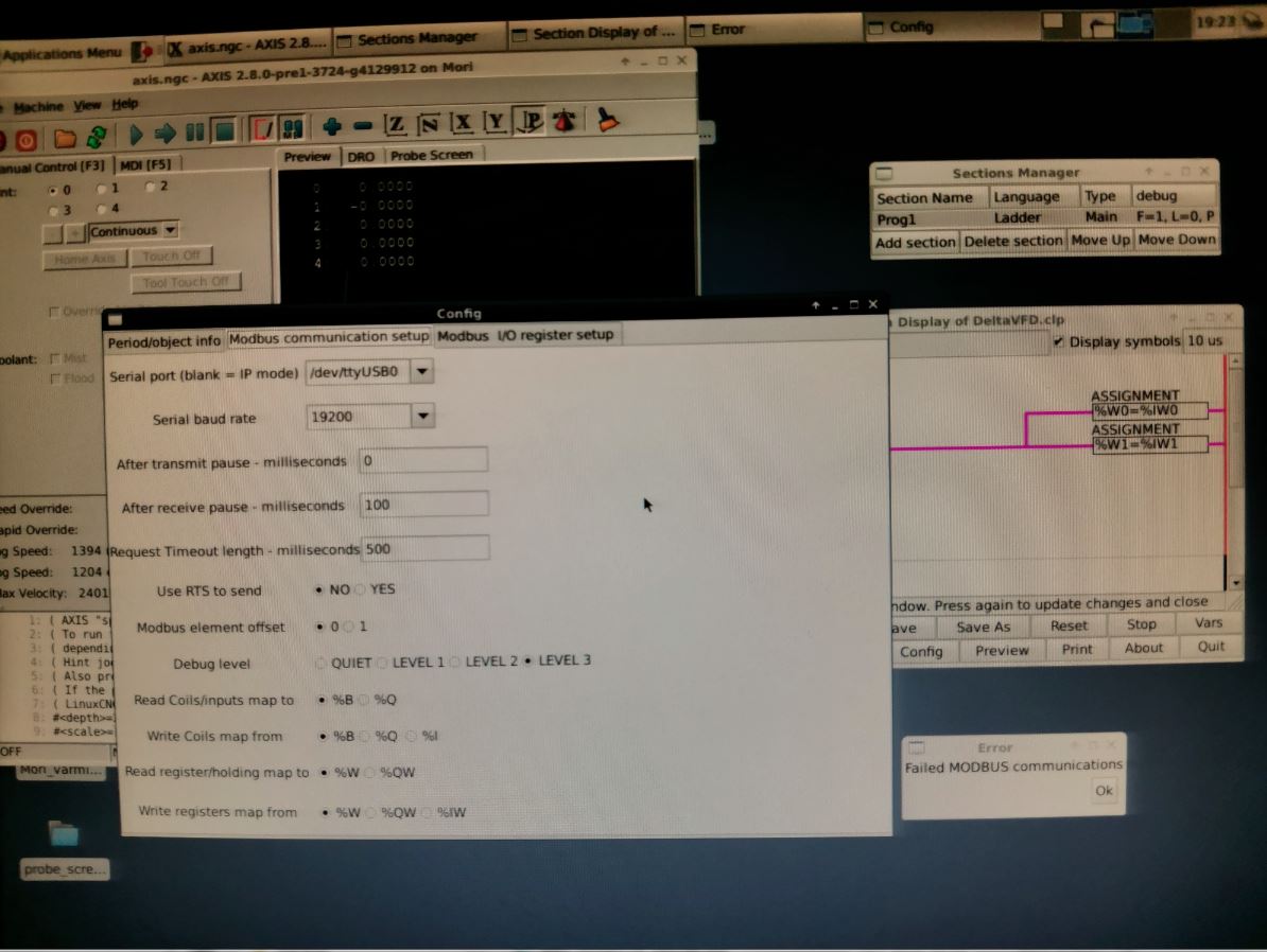

Hello
I am converting my Spindle to RS485 modbus to get one servo axis more.
My idea is to use HW COM port: ttyS0 and rs232 to 485 converter.
I have tested that RS485 converter works with VFD setup software.
Also I verified that baud rate is correct and it is in correct mode 19200, RTU and 8-N-1.

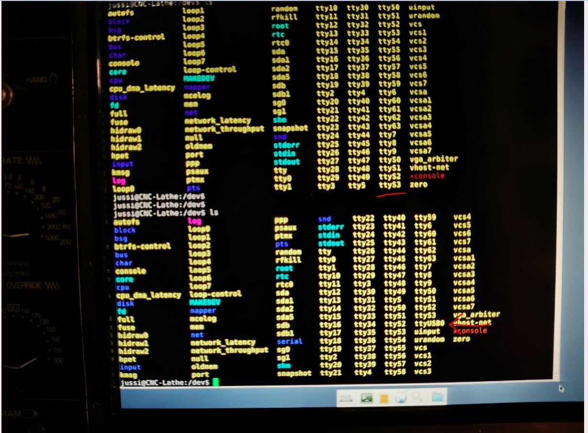

I Tested Linuxcnc with this USB to RS232 to verify that there is no HW problem.
ttyUSB0 is found:
Here is Config for modbus:
It was trying to send something (indicated by TX led in usb to rs232 conveter), but no modbus connection was made.
I was using same setup usb to rs232 + rs232 to rs485 converter to test connection with VFd softaware and it works.
Any Idea what i am missing?
Clearly something in Linux or linuxcnc..

Have you tried RTS on?
RS485 needs switching of direction

It's been awhile since I did classicladder modbus but ...
run linuxcnc in a terminal and set classicladder's modbus debug setting high.
that should show the raw commands being sent and received on classicladders's side.
Sometime changing the element offset, timeouts etc. also if you can try at a slower baud rate first might be helpful.
Chris

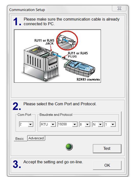

Hello
If you look at my first post, second picture.
There is there is two messages i tried trough ModBus.
First one is read register 2100, this went OK.
Then write register 2001, again ok.
and you can see answer from VFD to those requests.
I did look a manual and all requester and written register exists.

Looks from your setup software that the function should be 3 (read hold registers)not 4 ....

Serial config...
Serial writing...
Writing done!
select() for serial reading...
Serial reading...
5 chars found
INFO CLASSICLADDER- Modbus I/O module received: Lgt=5 -> (Slave address-1 - Function code-83 ) 2 C0 F1
ERROR CLASSICLADDER- MODBUS-EXCEPTION RECEIVED:83 (Excep=2)
ERROR CLASSICLADDER- MODBUS-INCORRECT RESPONSE RECEIVED FROM SLAVE!!!
Serial flush all!
- Posts: 7368
- Thank you received: 2181
20 Jan 2020 11:18 #155245
Replied by cmorley on topic Modbus communication error
It did make a difference - the exception code is now 2 - illegal data address
So the function (3) is corrected but seems the address is wrong
is address 2101 legal? in your test you used 2100
- Posts: 7368
20 Jan 2020 11:29 #155246
ahh I bet you did set 2100 in classicladder - try setting 'modbus element offset' to 0
Chris
Chris
