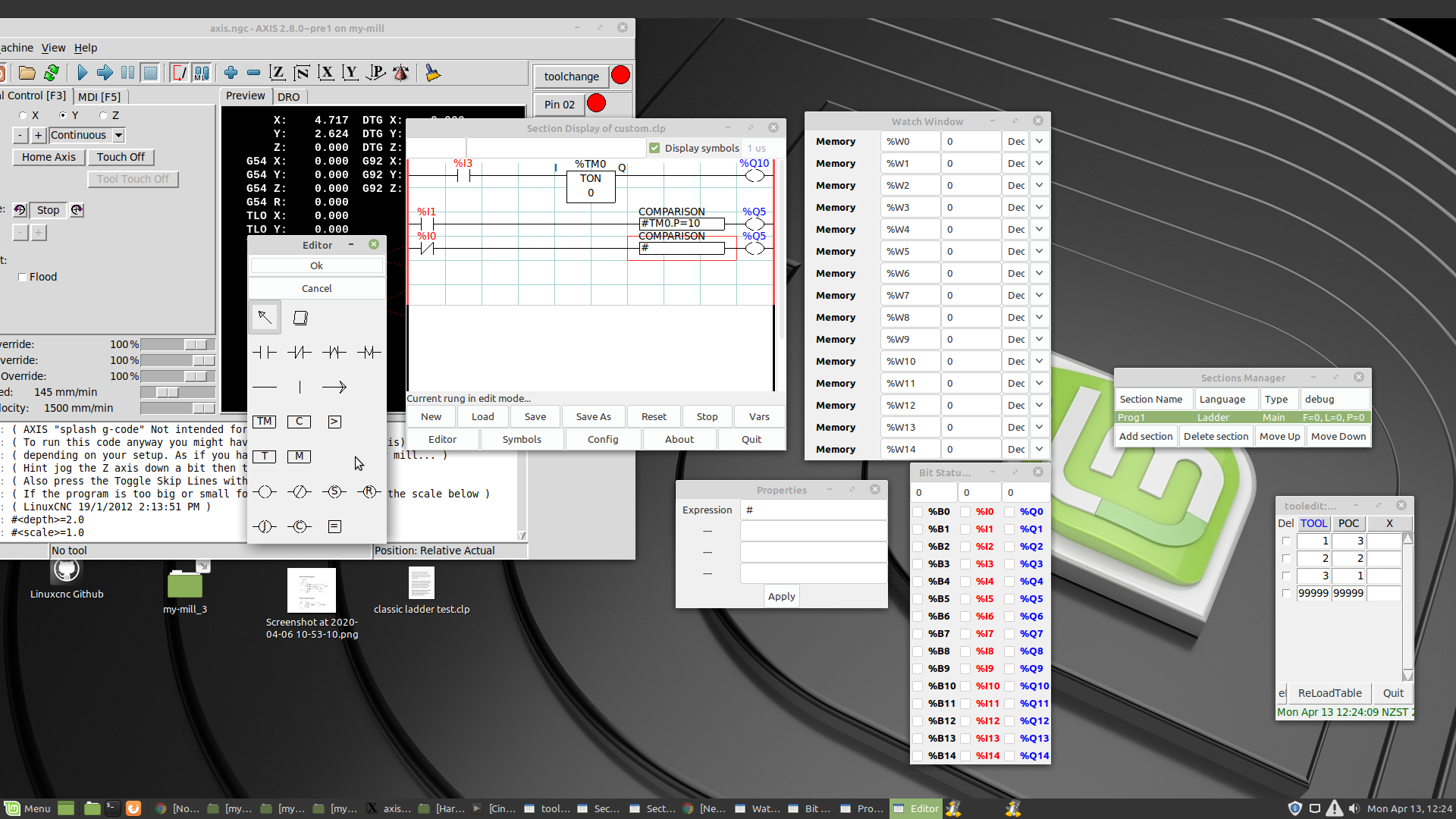

Hi guys I am learning classic basics here and starting from the most basic stuff and going from there.
just got a problem which I cannot find out anywhere when I search for it.
There is so many versions of classic ladder now that I am getting confused. I am trying to find out where the "operate" variable box is on the ladder editor? I can find the compare box and use it but not the operate box. it doesn't seem to be anywhere.
I am just trying to get this tutorial working here
ladder tutorial and be able to read a s32 number
(eventually I want to connect it to the io control toolchange prepare numbers but that is another issue once I actually find my problem lol)
regards
Andrew

Hi. I'm not sure what you mean by "operate" variable box....
AFAICR you can assign variables and compare them.
You mentioned a tool changer in another thread. There may be easier ways than ladder to get it working depending on how it is controlled
Henk

Oh, I see now what you mean.
The operate box in the tut is a variable assignment box. It's just re named "operate"
