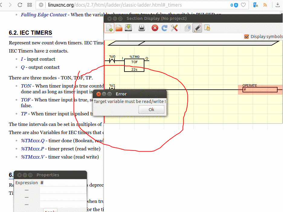

10 Jun 2021 10:32 #211684
by nkp
read write TIMERS variables was created by nkp

10 Jun 2021 15:17 #211706
by BigJohnT
Replied by BigJohnT on topic read write TIMERS variables
Quite likely a mistake in the documents. The timer value appears to be read only.

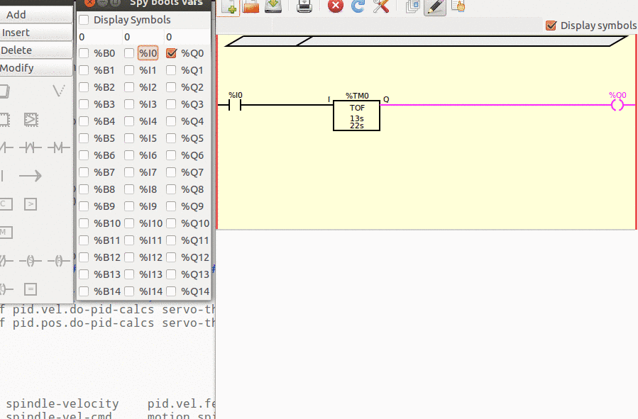

- nkp
- Posts: 143
- Thank you received: 39

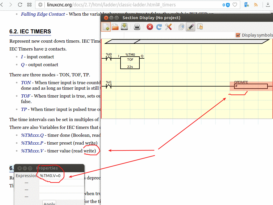

10 Jun 2021 17:55 - 10 Jun 2021 17:59 #211720
by nkp
Replied by nkp on topic read write TIMERS variables
there are several similar mistakes
and how can I reset the timer TOF ?
Last edit: 10 Jun 2021 17:59 by nkp.

11 Jun 2021 00:11 - 11 Jun 2021 00:46 #211755
Replied by cmorley on topic read write TIMERS variables
TM.0.V stands for the current value of the timer (can only be read)
TM0.P is the preset time and it can be written to.
all .P variables can be read/written
the counter's .V can be read/written to
all output pins can be read/written to.
B variables can be read and written too.
We could probably make the .V variable writable if there is a good use case.
Also, can you explain what you are trying to do?
Chris
Chris

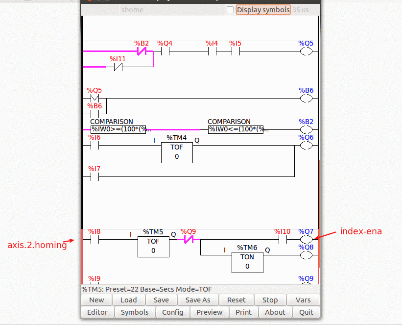

11 Jun 2021 06:31 #211778
by nkp
The task is this: it is required homing the spindle.(with resolver)
This must be done at the beginning of work.
(let's say together axis.2.homing)
With a timer (TM5) we give time for this procedure .
Q7 - enable resolver index-enable
Suppose that during the shoming_procedure,
the operator turned off the machine and turned it on again.
I would like the index to turn off.
But the timer continues to run.
So I would like to be able to forcibly reset it.
(this is one example.
this is often required in other cases as well )

12 Jun 2021 00:57 #211837
could you put a NC B variable inline with I8?
open the b variable would reset the timer.

- Posts: 7358
- Thank you received: 2172
17 Jun 2021 00:01 #212239
I did modify the timers to allow writing to the value, but it didn't seem to work as you wished.
It's a one word change in vars_name_list.c - if you want to try it.
