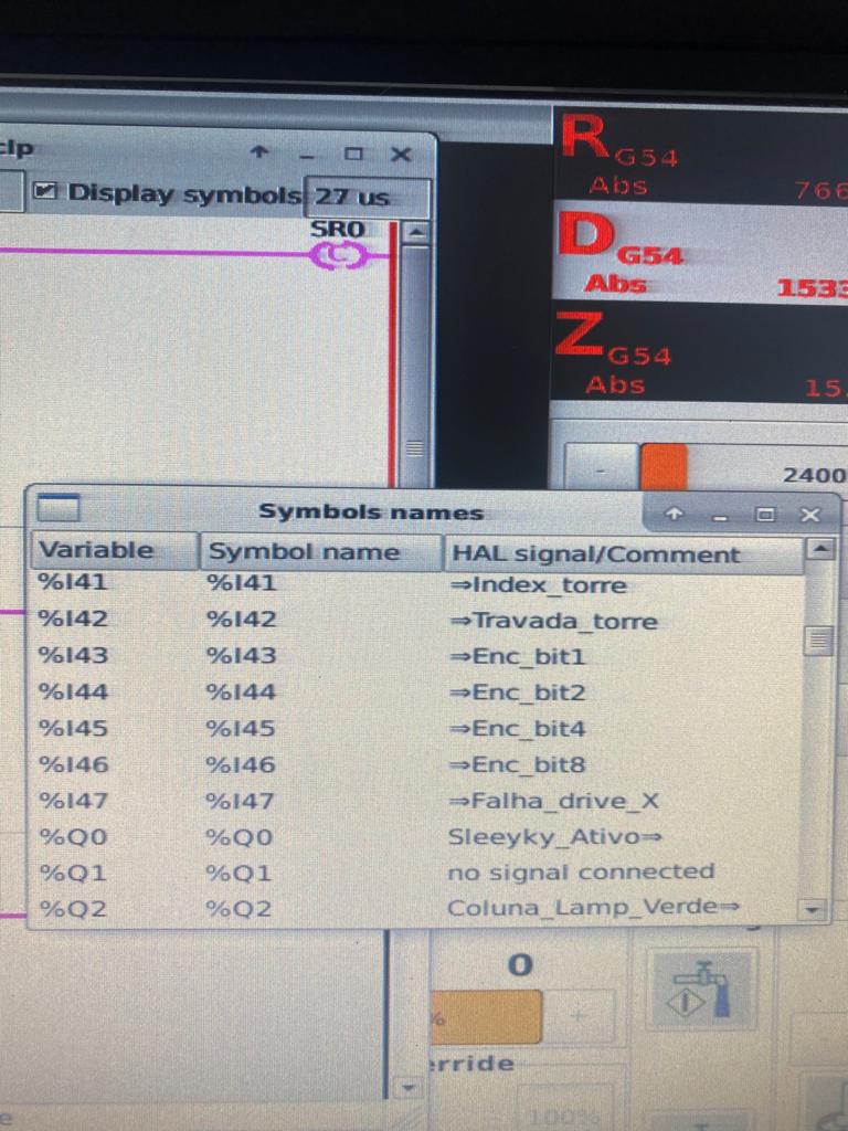

I loaded 80 in the inputs (numPhysInputs=80) in the Hal file plus maximum accepted is 50, the problem is that I have more inputs than that (52) and they are insufficient…. I read the link you gave me I went to Pncconf and edited it in the ladder the same thing. Do you have any idea?
- Posts: 4801
- Thank you received: 2161
23 Jun 2021 20:39 #212765
Replied by Aciera on topic Assembling Classicladder
I also have more than 50 inputs and even more outputs in classic ladder. If I remember correctly it's the graphical variable interface in Classicladder (the one in your screen shot) that somehow doesn't show all the available inputs and outputs. I had to add the %Ixx and the %Qxx in the .clp file directly (ie. the variable names) then you can use those in your ladder schematics. But I think you have to type the names you defined in the .clp manually as they don't show up in the variable browser in the gui.
So the signals do work but you cannot see them in the list in the gui.

%I22,btn-y-,
%I23,btn-a0,
%I36,btn-wzOut,
%I37,btn-usr3,
%I38,btn-wzIn,
%I39,btn-g91,
%I40,btn-usr5,
%I41,btn-usr4,
%I42,btn-drsEn,
%I43,drv-fault,
%I44,btn-splEn,
%I45,Err-Varm,
%I46,Err-Hspdl,
%I47,Err-Estp,
%I50,Mach-isOn,
%I51,mode=man,
%I52,mode=mdi,
%I53,mode=auto,
%I54,mode=jnt,
%I57,a-homed,
%I58,a-hmng,
%I59,a-prsnt,
%I60,spl-atRst,
%I62,spl-emcEn,
%I63,spl-emcDr,
%I70,m7-isOn,
%I71,m8-isOn,
%I75,led-prgRn,
%I76,led-prgPs,
%Q0,Q0,
%Q1,Q1,
%Q2,Q2,
%Q3,Q3,
%Q4,Q4,
%Q5,led-home,
%Q6,led-m4,
%Q7,led-m3,
%Q8,led-m8,
%Q9,led-m7,
%Q10,led-usr4,
%Q11,led-usr5,
%Q12,led-wzout,
%Q13,led-usr3,
%Q14,led-g91,
%Q15,led-wzin,
%Q16,led-usr1,
%Q17,led-usr2,
%Q18,Q18,
%Q19,led-prgps,
%Q20,led-prgst,
%Q21,led-4achs,
%Q22,rly-fan,
%Q23,Q23,
%Q24,Q24,
%Q25,Q25,
%Q26,Q26,
%Q27,Q27,
%Q28,Q28,
%Q29,Q29,
%Q30,Q30,
%Q31,rly-wzRls,
%Q32,rly-wzLck,
%Q33,rly-dose,
%Q34,Q34,
%Q35,led-splEn,
%Q36,led-drsEn,
%Q37,Q37,
%Q38,Q38,
%Q39,Q39,
%Q40,emc-en,
%Q41,btn-mach,
%Q43,drvs-en,
%Q45,home-all,
%Q46,home-aMan,
%Q47,jog-aSpd,
%Q51,spl-drv,
%Q53,m3En,
%Q54,m4En,
%Q55,m5En,
%Q60,m7-On,
%Q61,m7-Off,
%Q62,m8-On,
%Q63,m8-Off,
%Q70,prg-ps,
%Q71,prg-rsm,
%Q72,prg-stp,
%Q73,prg-run,
%Q80,zero-x,
%Q81,zero-y,
%Q82,zero-z,
%Q83,zero-a,
%Q85,btn-g91,
%Q87,btn-mode,
%B0,B0,
%B1,B1,
%B2,B2,
%B3,B3,
%B4,B4,
%B5,B5,
%B6,B6,
%B7,B7,
%B8,B8,
%B9,B9,
%B10,B10,
%B11,B11,
%B12,B12,
%B13,B13,
%B14,B14,
%B15,B15,
%B16,B16,
%B17,B17,
%B18,B18,
%B19,B19,
%B20,B20,
%B21,B21,
%B22,B22,
%B23,B23,
%B24,B24,
%B25,B25,
%B26,B26,
%B27,B27,
%B28,B28,
%B29,B29,
%B30,B30,
%B31,B31,
%B32,B32,
%B33,B33,
%B34,B34,
%B35,B35,
%B36,B36,
%B37,B37,
%B38,B38,
%B39,B39,
%W0,%W0,
%W1,%W1,
%W2,%W2,
%W3,%W3,
%W4,%W4,
%W5,%W5,
%W6,%W6,
%W7,%W7,
%W8,%W8,
%W9,%W9,
%W10,%W10,
%W11,%W11,
%W12,%W12,
%W13,%W13,
%W14,%W14,
%W15,%W15,
%W16,%W16,
%W17,%W17,
%W18,%W18,
%W19,%W19,
%IW0,%IW0,
%IW1,%IW1,
%IW2,%IW2,
%IW3,%IW3,
%IW4,%IW4,
%IW5,%IW5,
%IW6,%IW6,
%IW7,%IW7,
%IW8,%IW8,
%IW9,%IW9,
%QW0,%QW0,
%QW1,%QW1,
%QW2,%QW2,
%QW3,%QW3,
%QW4,%QW4,
%QW5,%QW5,
%QW6,%QW6,
%QW7,%QW7,
%QW8,%QW8,
%QW9,%QW9,
%IF0,%IF0,
%IF1,%IF1,
%IF2,%IF2,
