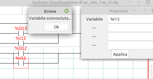

he because completely new on classicladder i run my example using some tutorial ... all good I connect in/out with EL1008/2008 ...
these my ladder-glue.hal file (only first row):
Question: is possible to use "pressulre-low" for example instead "I0"?? .... because I try with error .... seems not possible but I ask to classic ladder expert .....
Plus I have an annoing warning about error on period 0 of 50.000ns .... but I run all on rt-preempt system so no one use base period ... only servo period instead ... where become these warning? My ini file is without BASE_PERIOD .... need to used because classicladder? I can put it on 100.000 .... so system can be happy.

I means inside classic ladder in graphica ladder gui programming ( -| |- or -|\|- not able named "mary" instead %I0 ..... for example).
AZny how tomorrow try again and take a screenshot ....

These appear when try to insert "in2" intead %I12 .... in my .hal file I write these that is perfectly legal obviusly
Replied by bkt on topic ClassicLadder named input
net in2 <= lcec.0.1.din-2
net in3 <= lcec.0.1.din-3
net in4 <= lcec.0.1.din-4
net in5 <= lcec.0.1.din-5
net in6 <= lcec.0.1.din-6
net in7 <= lcec.0.1.din-7
net in2 => classicladder.0.in-12
net in3 => classicladder.0.in-13
net in4 => classicladder.0.in-14
net in5 => classicladder.0.in-15
net in6 => classicladder.0.in-16
net in7 => classicladder.0.in-17

Check Display symbols and create your symbol names for each variable with the Symbols button.
JT

On Dysplay Simbols can see name assigned from .hal file .... thanks ... but not possible assign a arbitrary name on new var .... so think is possible to assign only if not included in some manner on some .hal file .... or when total virgin program is created. Not try but seems to me is right .... you can confirm or not?
Maybe I misunderstood.

Double click the Symbol Name in the Symbols names interface and change the Symbol Name there.
JT
