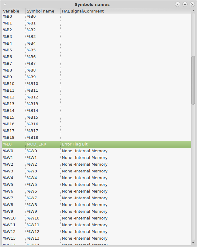

I can watch the status in the Watch Window by typing %E0 but my main problem is that all the modbus error bits %E0..%Exx are not available in the symbol names
How can I add there the Error Flag bits %Exx?

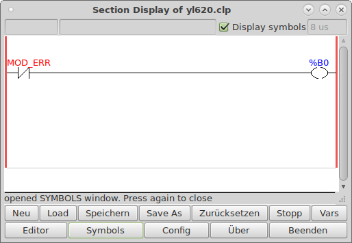

In the Symbol Names Windows I didn't find any Error Flag bits so I edit one random column to %E0 and edit also the Symbol name to MOD_ERR also added a comment. I hope this is the right way.

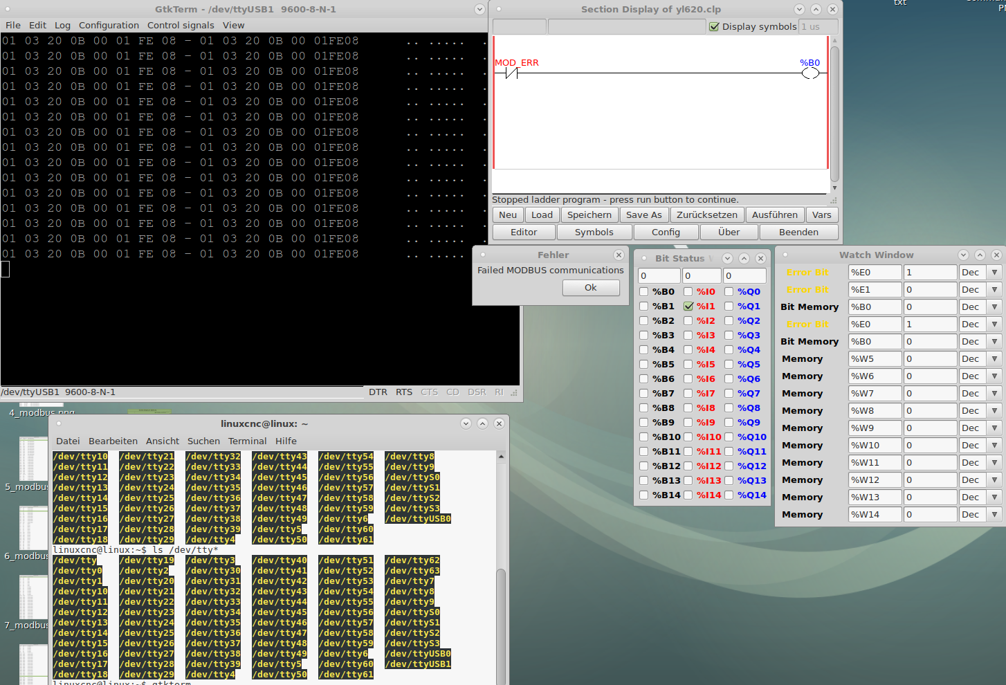

When I stick in my USB to RS485 converter I can see that linux recognize the USB as ttyUSB0.
If I than stop the clp reset it and then start again the %b0=1 shows up only once than a modbus fail opens.
Altough the data is send out (I made a loop to a second converter) and the data is reading correctly. But the %b0 is not set.
I expected that it should be set if communication is ok?
