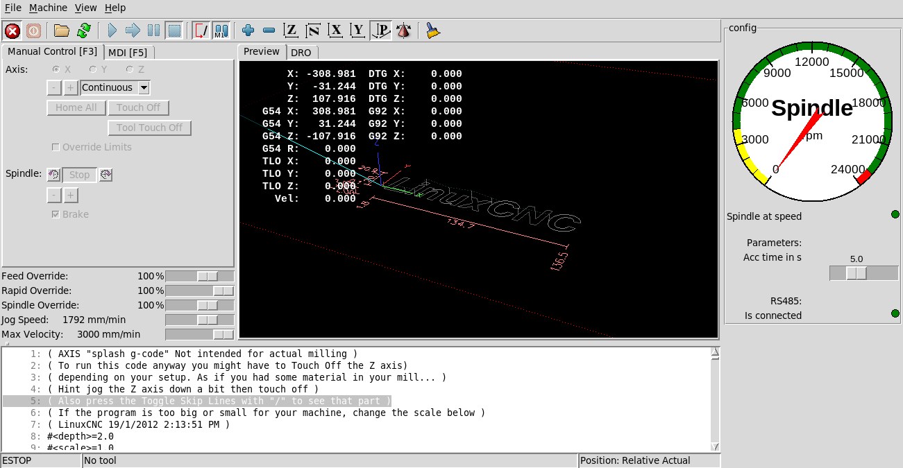

hi guys, im new to linuxcnc and all things linux, im running linuxcnc 2.8.2 on the axis gui, and have built a printnc cnc thats made from a kit that came with a vfd and spinde kit yl620-a and 2.2kw water cooled spindle. i am using this
www.waveshare.com/usb-to-rs485.htm
usb to rs485 adapter, and have managed to setup the vfd to control the spindle with classic ladder following this github tutorial
github.com/xsnoopy/LinuxCNC-Yalang-yl620...Modbus-ClassicLadder
i can get the spindle to start with the and - buttons or an mdi command " m3 s***** " ect and stop, forward or reverse ect, and have a very stable modbus connection with the adsapter to vfd, so it should be great for running gcode, but the PYVCP panel that has a dial for speed feedback and a light to indicate spindle at speed and rs485 connection are not working! i cannot get them to work, ive tried looking in HALSHOW and the spindle at speed is permanently on regardless for some reason, the other pins for the spindle are giving feedback also when turning on and off the spindle the brake pin goes on and of, theres a pin and a readout for the speed and hz and that seems to be working but the funny thing is if i turn the vfd off and start the spindle the pins still show feedback in halshow, i would love to get this working properly and have been reading up on the basics of HAL and PYVCP python virtual control panels, and from what i can understand the vfd.clp file is the file that classicladder uses to control the vfd with the rs485 adapter, the vfd.xml file is what creates the PYVCP panel and the vfd.hal file tels the panel how to connect the pins to the panel, but ive spent hours trying to get my head around it and its took me months to get this far, i at least can run the vfd via modbus with the adapter through linuxcnc which most people with this vfd have just given up on trying to get it to work, so a big thankyou to mbender for getting it to this point im very grateful for the tutorial, if i post my files can someone take a look and see why the panel isnt working

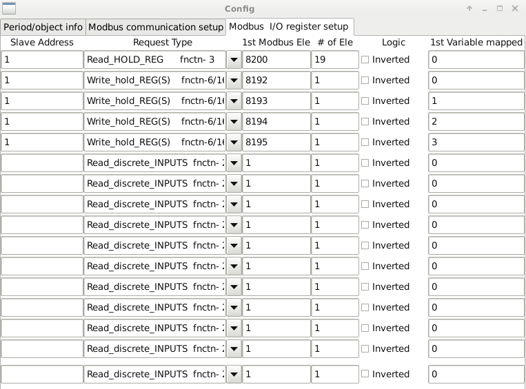

ok i got it working all the lights and dial work great now giving feedback, the tutorial was a little misleading but i learned a lot about hal and pyvcp panels and pins in the process, i take no credit for the tutorial as i say as mBender was the person who did all the work i just got it working for me also this should help others who got stuck with this vfd combo and rs485 connection
the readme file from the files in the github repository
says to add this to the end of your .ini file which is incorrect it is meant to be put at the end of your .hal file without the last line
" POSTGUI_HALFILE = vfd.hal" which belongs in your ini file in the [hal section]
loadrt classicladder_rt numS32out=100
loadusr classicladder --modmaster vfd.clp
net spindle-on classicladder.0.in-00 spindle.0.on
net spindle-brake classicladder.0.in-01 spindle.0.brake
net spindle-forward classicladder.0.in-02 spindle.0.forward
net spindle-reverse classicladder.0.in-03 spindle.0.reverse
net spindle-cmd-rpm <= spindle.0.speed-out
net spindle-cmd-rpm-abs <= spindle.0.speed-out-abs
net spindle-cmd-rps <= spindle.0.speed-out-rps
net spindle-cmd-rps-abs <= spindle.0.speed-out-rps-abs classicladder.0.floatin-00
so copy and paste this excluding the last line into your .hal file
and as mentioned above the last line belongs in your .ini file so in your machine .ini file edit these sections:
in the [DISPLAY] section add "PYVCP = vfd.xml"
in the [HAL] section add "POSTGUI_HALFILE = vfd.hal"

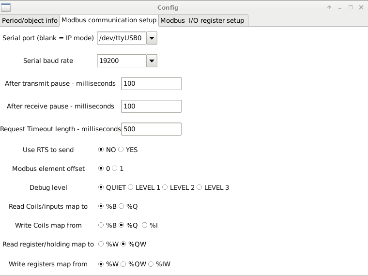

also to point out if you use the usb to r485 adapter linked above it will show up as /dev/ttyACMO and the classicladder configuration tab doesnt have this as a selectable option so to remedy this open the vfd.clp file towards the bottom you should see this text
MODBUS_MASTER_SERIAL_PORT=/dev/ttyUSB0
MODBUS_MASTER_SERIAL_SPEED=19200
MODBUS_MASTER_SERIAL_DATABITS=8
MODBUS_MASTER_SERIAL_STOPBITS=1
MODBUS_MASTER_SERIAL_PARITY=0
MODBUS_ELEMENT_OFFSET=0
MODBUS_MASTER_SERIAL_USE_RTS_TO_SEND=0
MODBUS_MASTER_TIME_INTER_FRAME=100
MODBUS_MASTER_TIME_OUT_RECEIPT=500
MODBUS_MASTER_TIME_AFTER_TRANSMIT=100
MODBUS_DEBUG_LEVEL=0
MODBUS_MAP_COIL_READ=0
MODBUS_MAP_COIL_WRITE=1
MODBUS_MAP_INPUT=0
MODBUS_MAP_HOLDING=0
MODBUS_MAP_REGISTER_READ=1
MODBUS_MAP_REGISTER_WRITE=0
_/FILE-com_params.txt
(this is the line that needs editing with /dev/ttyACM0)
when you open linuxcnc and open up the config window in classicladder you will see it has changed to/dev/ttyACM0 and it will now work
also i set the vfd to 19200 8 n 1 and kept the same in the the classicladder config,
also you need to add your user to the dialout group and configure your usb adapter to the correct setting
