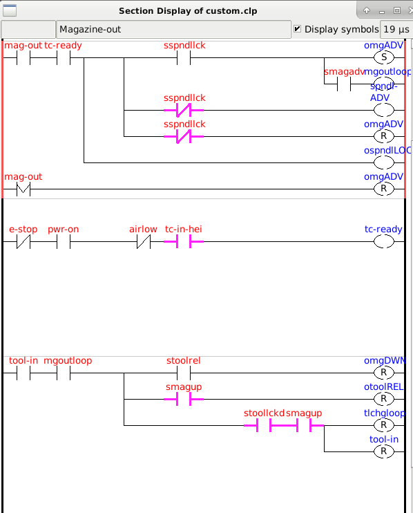

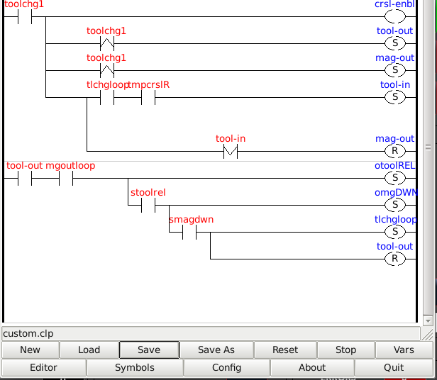

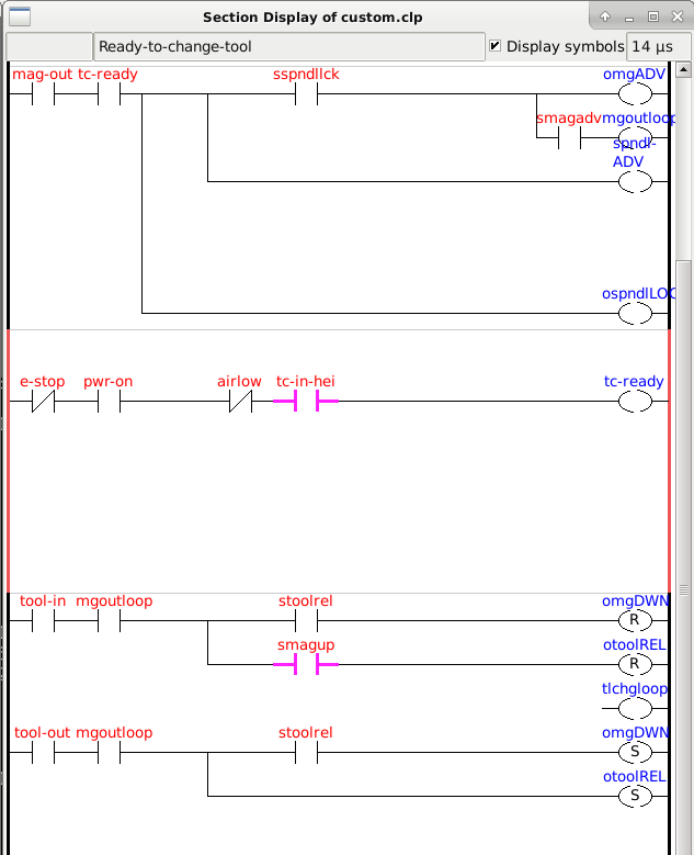

I've made some progress over the weekend, stepped away from the machine and the thoughts started to come.
I've setup 3 rungs and tested them:
1) Tool Change ready - sets an internal signal when we're ready to change (machine-on, air-pressure etc)
2) Magazine out - sends the magazine out once the spindle is locked and sets and internal signal to true once complete.
3) Tool-in / Tool-out - Releases the tool, drops the mag and holds, then puts the tool back and locks
So I've got the movements sorted now I need to do the following:
A) Work out how to 'move' with a single HAL pin so the spindle lock can kick in (doing by hand atm)
"B") Connect the CL lines to the Carousel
C) Home the carousel when the machine homes
D) Figure out how to hook it all together
E) Cleanup the HAL and add in more safety/protections/timeouts.
F) Connect it to the 'machine' so when a tool is asked for it can do it's thing
I've attached the HAL and the ladder.
Apols the HAL is super messy as I was using another config from someone else as inspiration.

Motion is working now, and co-ordinated.
Steps:
-VAR %B5 triggers the mag-out, then tool-out.
-Waits for %B11 which will end up as the carousel is ready flag
-Then continues with the tool-in
-The mag-out ends
Next steps:
-Work out a single HAL pin to Advance the spindle so that the spindlelock drops into place.
-Work out the signal to wait for on the carousel
-Work out how to hook into the carousel
-Get the tool change signal from g-code or the gui to call the toolchg1 signal.
-Add safety logic and cleanup the files.
