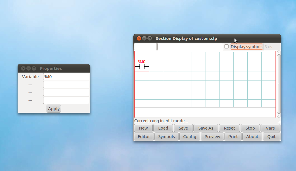

10 Dec 2010 01:35 #5953

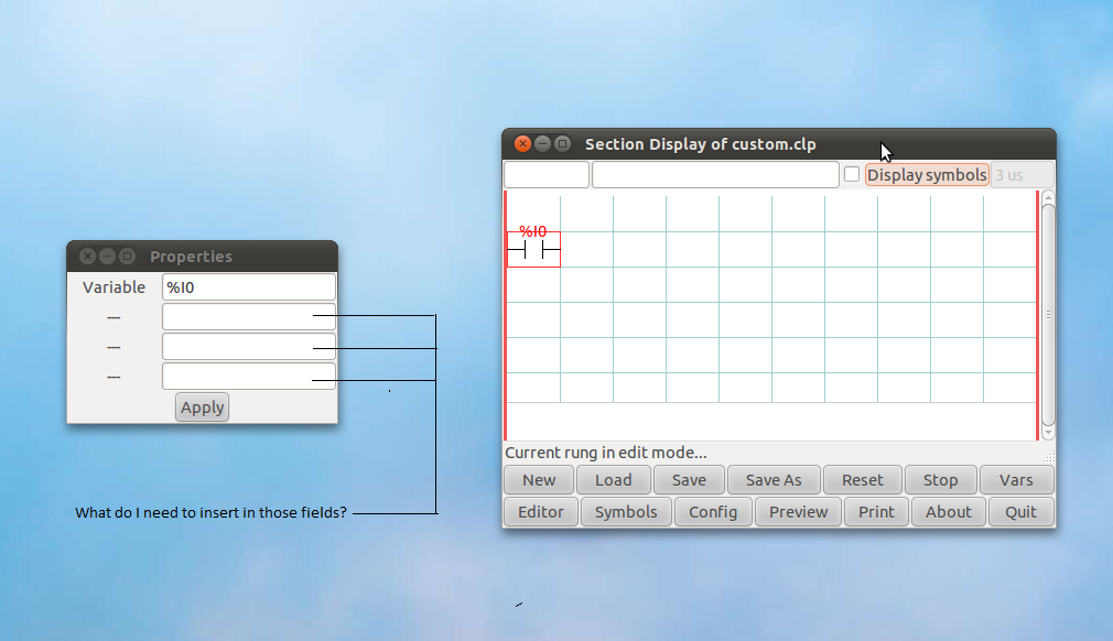

Replied by cmorley on topic Re:help classic ladder
on the screen you posted variable %I0 is a bit input.
if you change that to %Q0 that is a bit output
and if in either you change the number to (for example) 2 then you a referring to the third bit input (%I2) or the third bit output (%Q2)
CL starts counting from zero.
- andradela
- Posts: 114
10 Dec 2010 16:38 #5960
by andradela
Replied by andradela on topic Re:help classic ladder
- Posts: 7959
- Thank you received: 2162
10 Dec 2010 20:03 #5964
nothing.
Those spaces are for other ladder objects that need extra information such as timers.
The variable name is the only option. that is why there are dashes in the other fields.

10 Dec 2010 22:09 #5967
by andradela
Thanks now I can to use correctly instrutions.
My problem was when i tried to insert a instruction and pressed enter nothing happened, now I know how to do.
