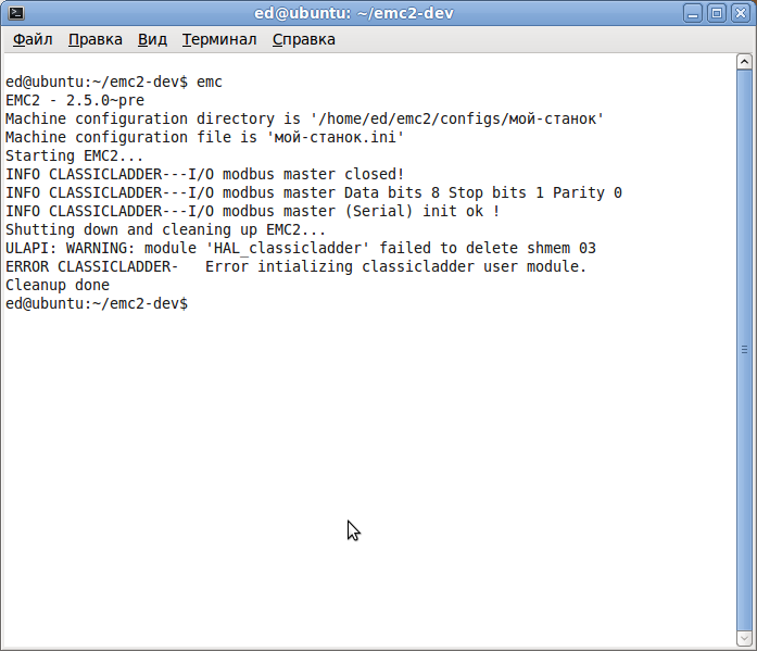

- myed
- Visitor
08 Mar 2011 19:20 #7654
by myed
Replied by myed on topic Re:Serial ModbusRTU without GUI
- Posts: 7959
- Thank you received: 2162
09 Mar 2011 04:58 #7662
Replied by cmorley on topic Re:Serial ModbusRTU without GUI
I think it is safe to ignore this error.
you can get the same warning if you load classicladder with a gui then 'unload classicladder' in the HAL environment.
It happens because when you unload a component it doesn't use the regular exit point of classicladder, it forces it to close.
This should probably be done better...
Chris M
Chris M
