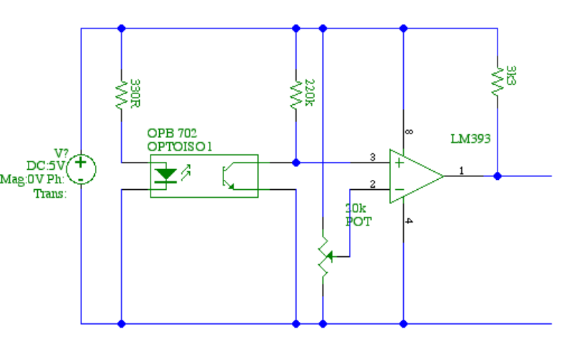

26 Feb 2012 10:00 - 26 Feb 2012 10:01 #18093 by ArcEye
Replied by ArcEye on topic Re:pyvcp tachometer
Hi
I'm thinking of ditching the belt driven encoder and going with the more common multi-hole disk.
If you have a working belt driven encoder, I would keep it if possible.
I had one but it was fried, along with many other components in a power outrage at some point before i bought it.
Thats the reason I went to other indexing methods
This is my set up, as posted previously.
www.linuxcnc.org/index.php/english/compo...imit=6&start=6#14832
What's realistic with software counting ? 100 holes ? Does it matter ?
Excluding the disk, are there bolt-on electronic kits available or do most people roll their own ?
There are no kits I am aware of, but the components are simple and quite easy to put together.
This is the circuit I use, kindly supplied by Andy Pugh some years ago.
I have a 120 hole disc, which is approaching the limit of practicality in terms of disc diameter and the number of holes that can be drilled along its circumference, for the space available to me. The holes are 3mm and 3mm ish spacing between.
I chose to work in multiples of 60 for sheer convenience of calculation, both with spindle velocity and the initial PCD calculations for making it.
I also hypothesised that if all calculations within software as to the exact position of the spindle were in numbers that divided exactly into 360, the accuracy must be better.
Whether this is true I don't know, but it threads very smoothly.
regards
Last edit: 26 Feb 2012 10:01 by ArcEye. Reason: put image where it should be!
