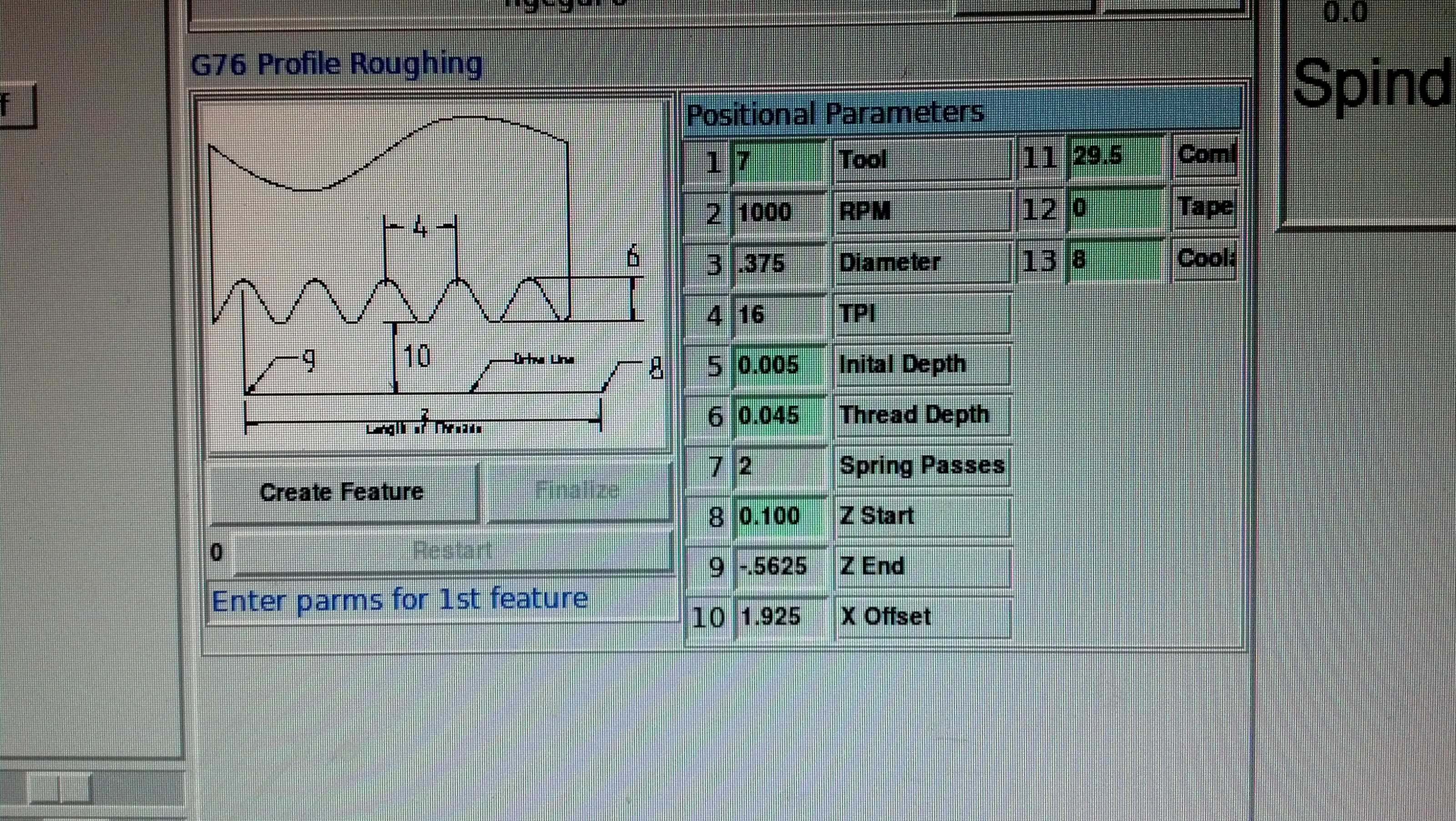

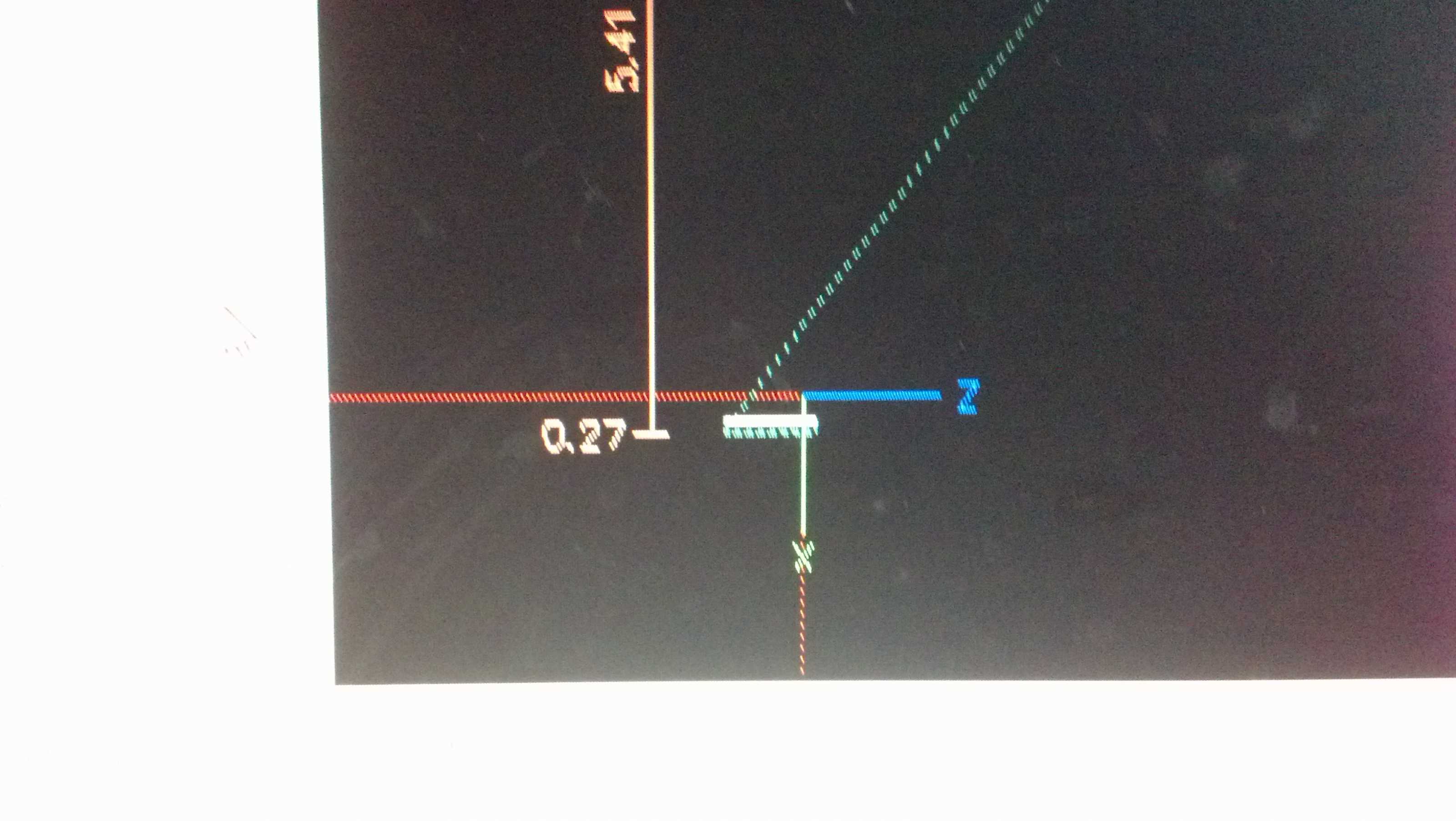

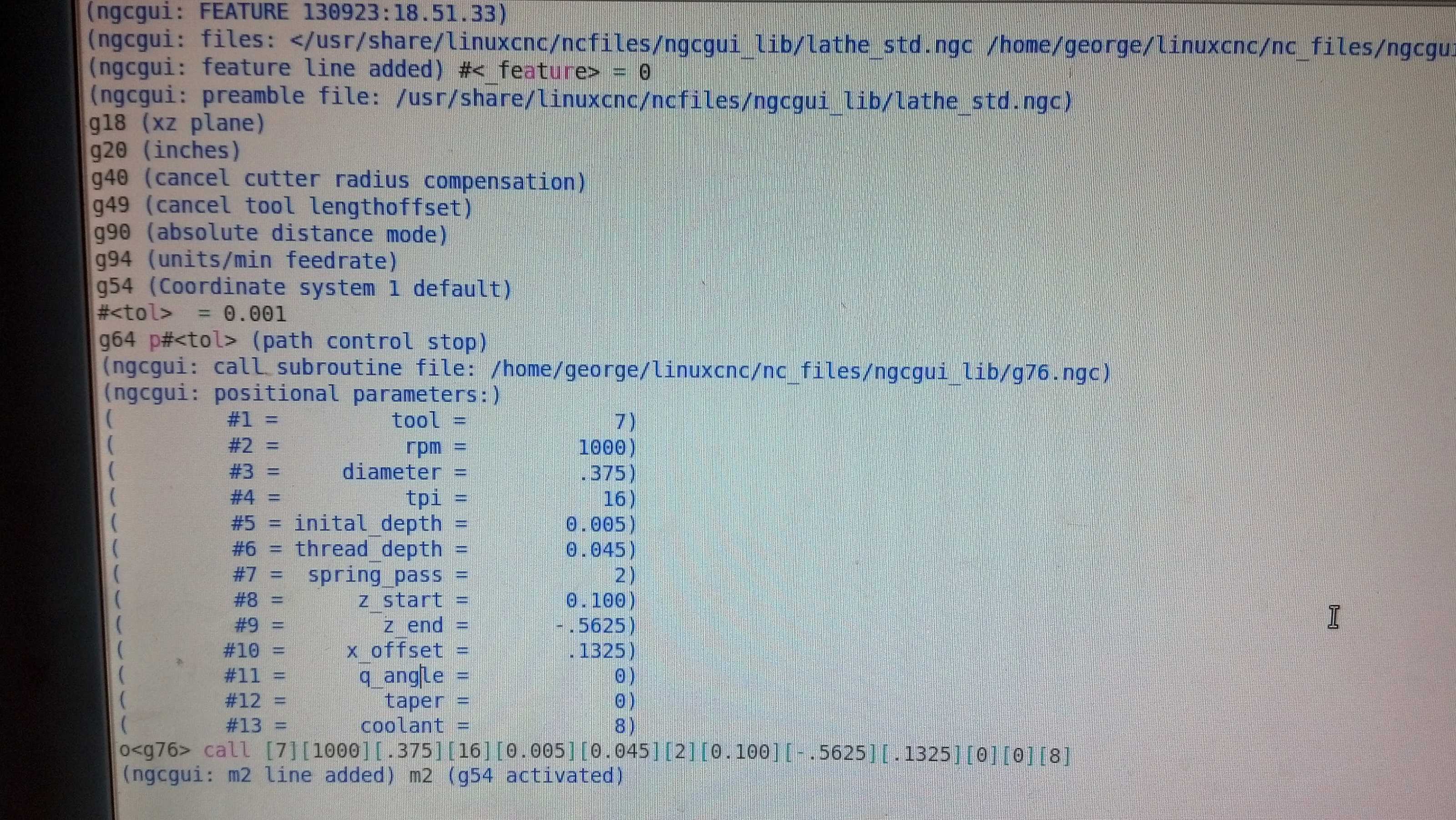

I've been making some 3/8-16 threads there coming out mint. But for the life of me I cant figure out how stop this from going the wrong way at the end of the program. I had to adjust it so it doesn't crash the bit and the part. I included some pics.

As you are using someone elses ngcgui file to do this, rather than my code posted earlier, will need to see the g76.ngc file and any post amble file if used.
The plot makes it look as though you have a front tool lathe but are returning to a position behind and above the workpiece ( slant bed lathe home?! ) and cutting through the workpiece.
Are you using gang tooling and homing behind the Z axis line or something like that?
Just need to remove the command that is causing that move, G28 or G53 X0 Z0 probably
regards
