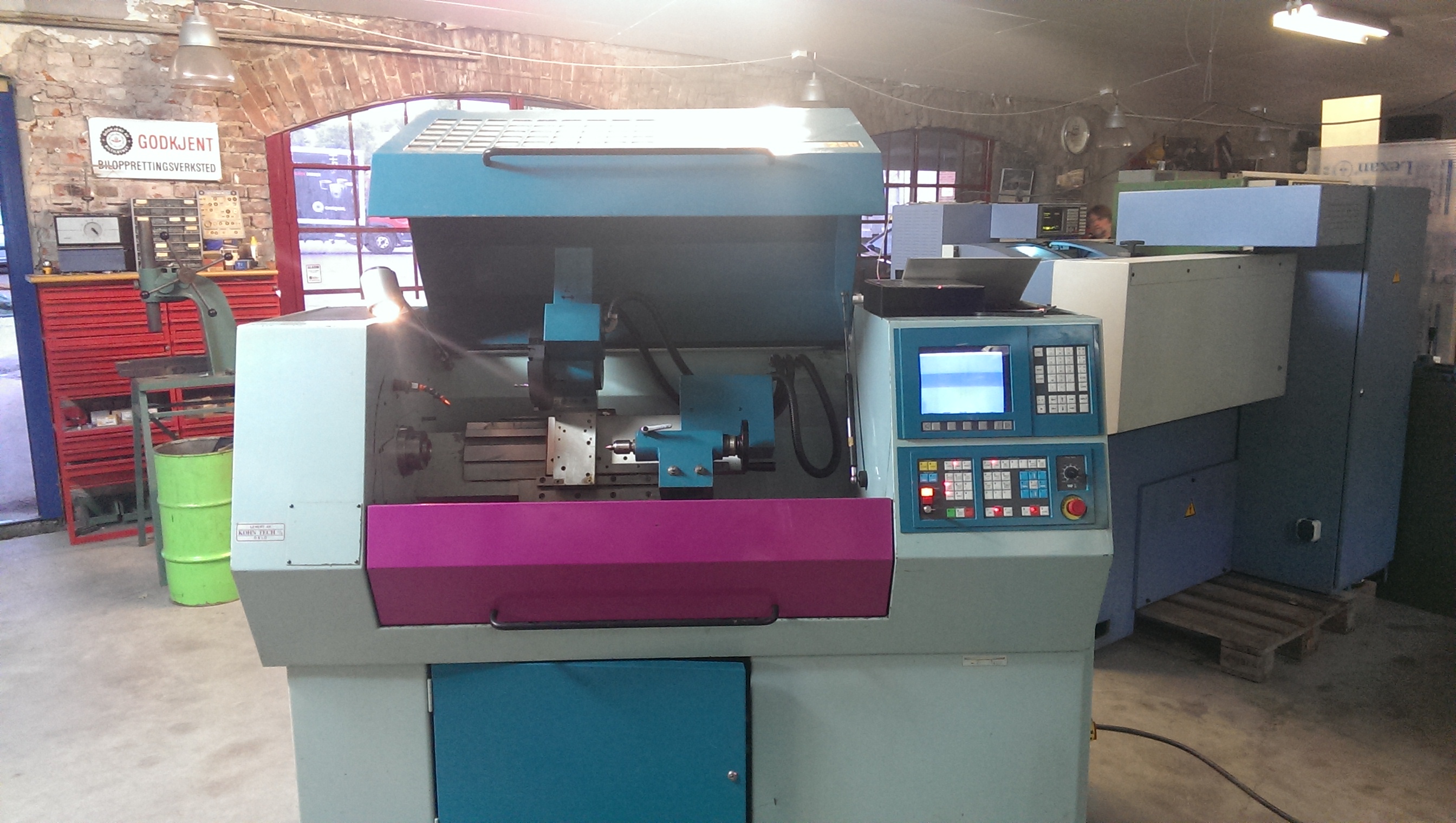

A few years ago I got hold of a fully functional Okuma LC20 twin turret lathe for free. After it was placed on my yard I discovered it needed 240V/125A. I only have 64A, bummer! It went for scrap this summer, all 6,5 tons of it.
then I just bought a Boxford 250B CNC lathe born Feb. 2. 1995. Just the right size and only needing 32A.
It is in full running order. So I figure I just have to do something about that. :P

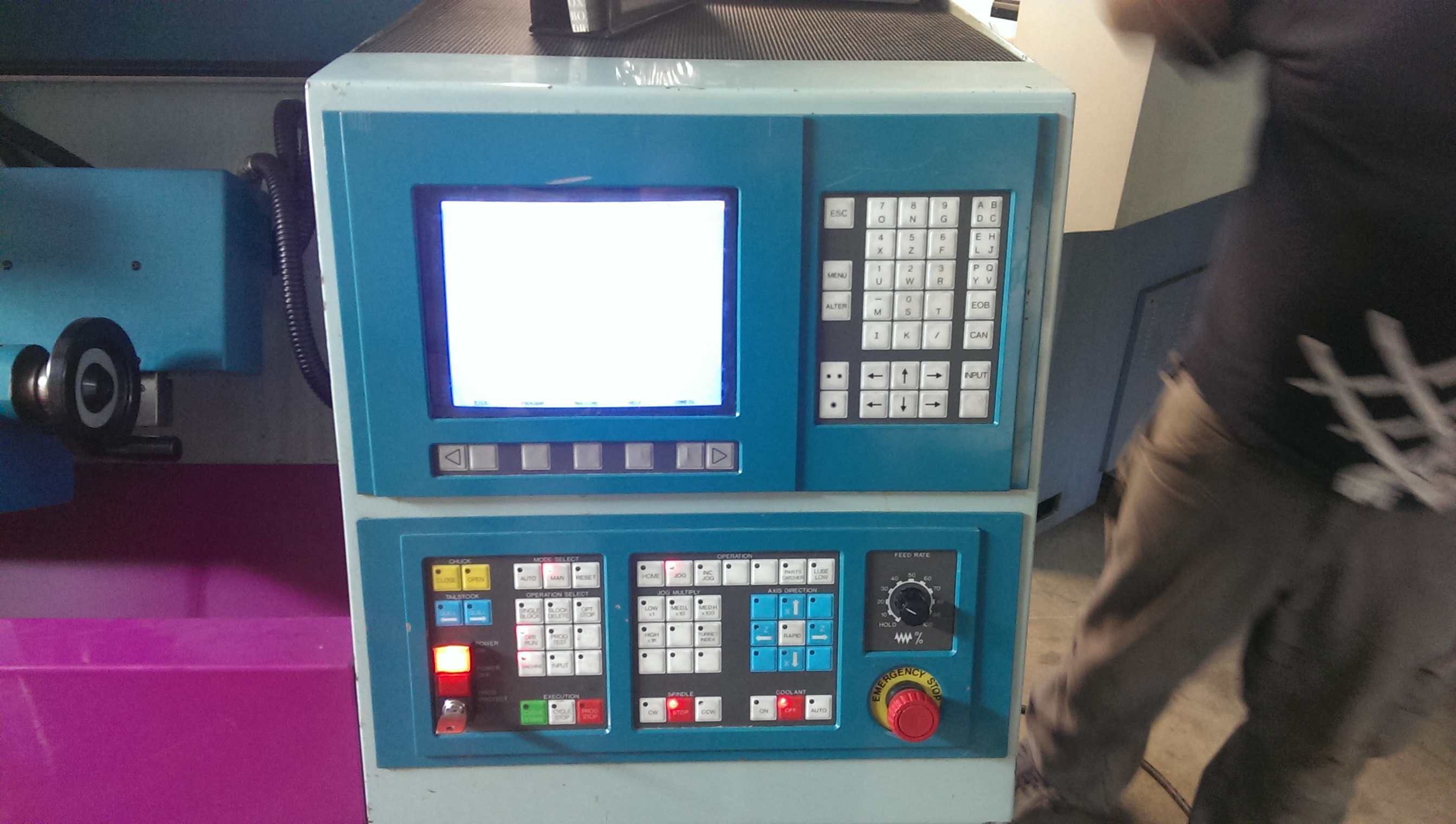

The user interface is just terrible! So thus a retrofit is needed.
It has steppers on X, Z and the 8 position tool turret. The drivers are old, but standard with step & dir inputs.
There are some kind of home switches (sensors?) that I have not figured out yet. And an adjustable limit switch to avoid chuck crash.
The spindle drive is AC ansync motor driven by a IMO Jaguar VFD and voltage input speed control. The drive does have an RS485 port but Google cannot find a manual for it, so forget that. It also have a multi hole optical reader and an optical index reader.
There are a coolant pump and some safety switches too.

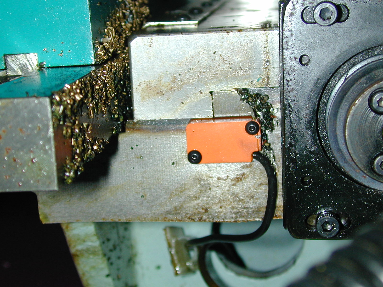

And I found only 1 homing switch, plus an inductive sensor at the end of the ballscrews. It obviously use these in the homing sequence.
These are just indexes so it seems this one switch is able to give a position with better than one pitch accuracy for both axes.
How it can do that is beyond me, but I'll just treat is as a fact. My aim is that this be an electronic only upgrade.

The inductive sensor is under the chromed plate on the Z axis and matches a void to register, it may also match one on the X axis which crosses it, I assume the axes homed seperately with the original software.
Yes, I found that sensor using one of those "camera on a snake" thingies. And I was assuming it is like you say. Thus the inability of the original controller to home in Z only. It must home in X first, then Z. The thing I don't understand is how does it do it? There is quite some distance from this switch to the cross slide. There may be a plunger inside it or something. Anyway as long as LinuxCNC can be configured to use it, that's all I need. :cheer:

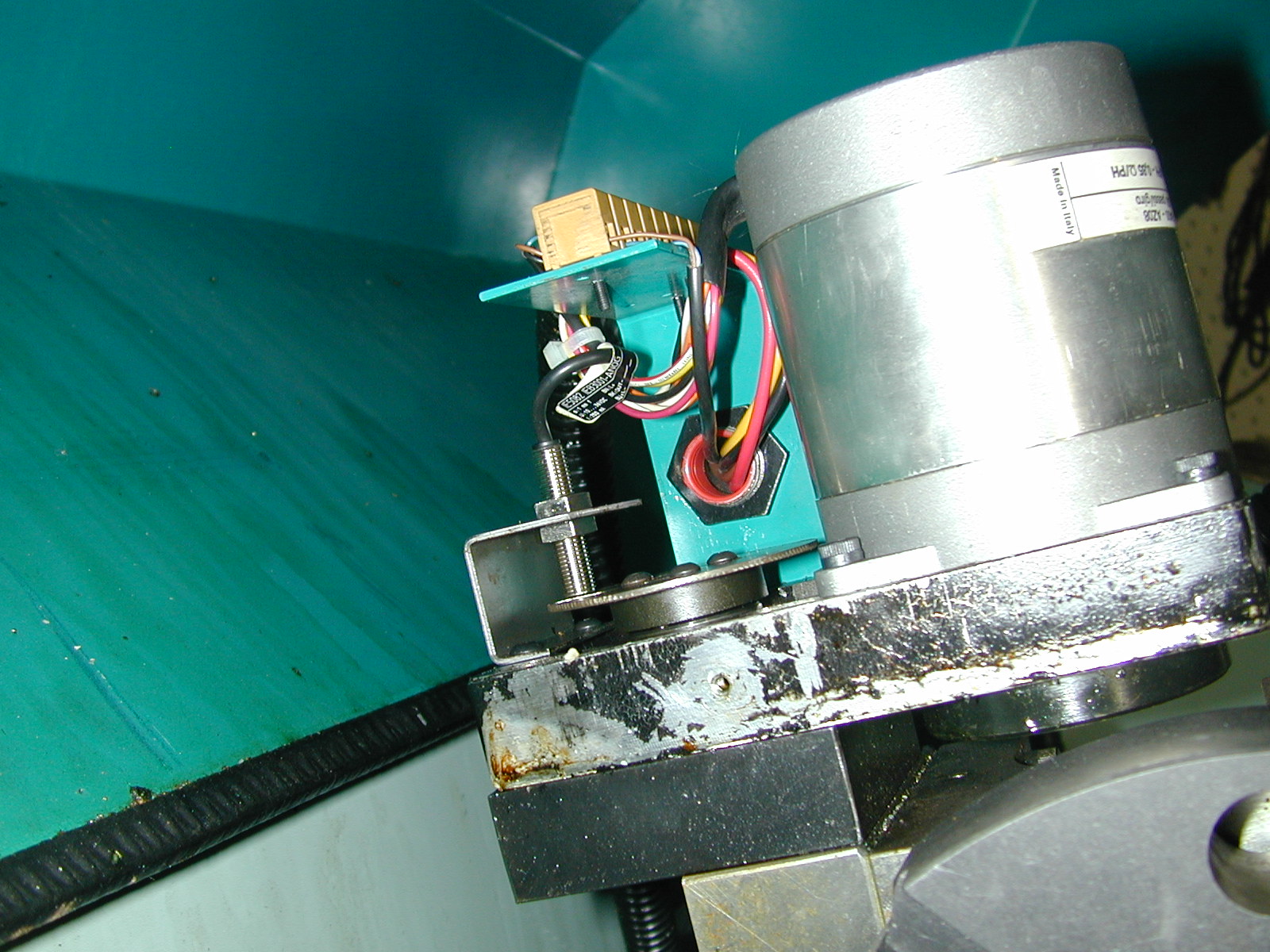

As far as I can find the machine have an inductive limit switch for Z that will sense both ends of travel. Homing is done as a combination of this and another inductive switch sensing a disc on the end of the ballscrew.
The X axis is the same, except the sensor on the slide is only activating on the home end of travel. This could be made to activate on both ends by milling a pocket in the X slide, but I don't want to do that. At least not until I find that necessary.

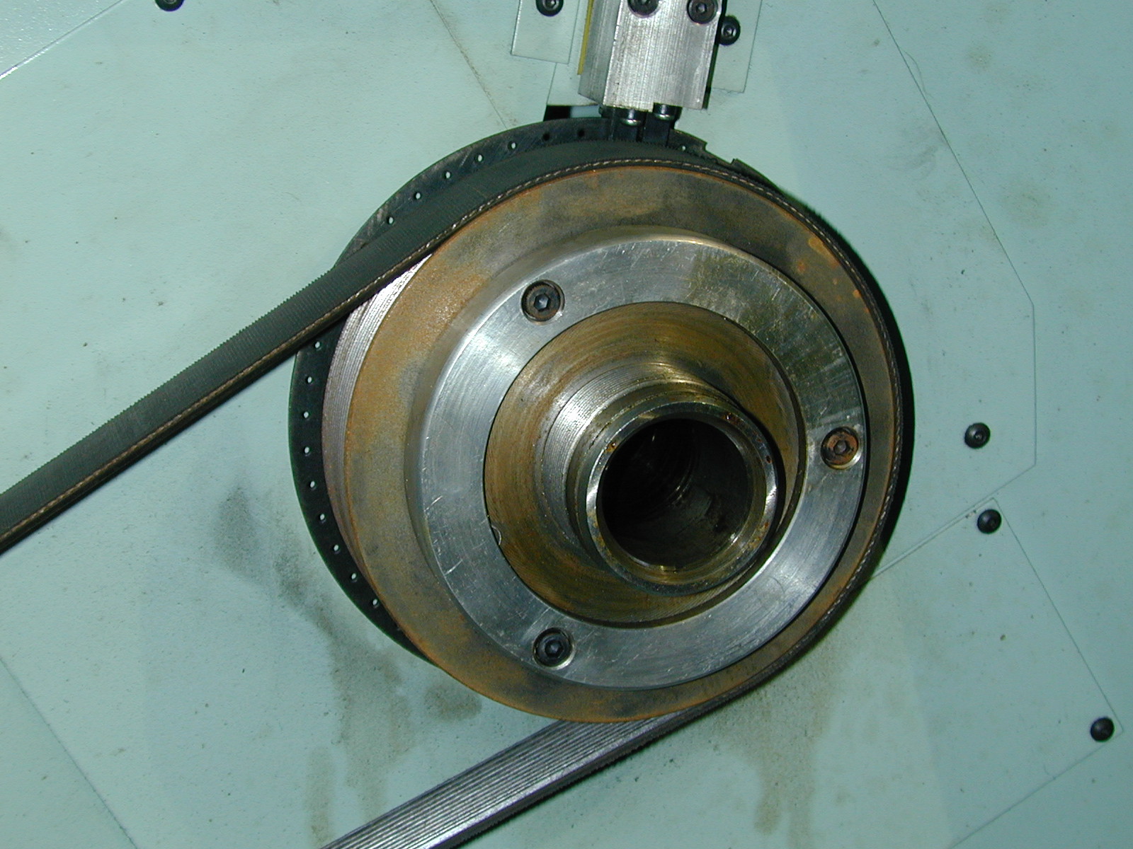

The spindle sensors are one index sensing a slot in the disc on the spindle. The other senses 50 holes in the disc.

The control panel is on the right side of the machine. Not very convenient if one wants to see what's going on.
I have a nice jog wheel rescued from the Okuma we scrapped. So I want to make a pendant with this and some other useful functions.
At work I design a handheld device with Modbus RS485, a small graphics display and some buttons. All I have to do on that end is to add more buttons, the handwheel and some lines of code. So I'm looking for how to connect into LinuxCNC using Modbus.
That should allow for very accurate homing. Depending on homing speeds, axis acelleration and how long the sensing disc is active for this might be easy to configure. If the axis can stop from homing speed inside the distance that both the bed-sensor and the the disc-sensor are active then you can just and2 the two switches together. If there is a danger of the axis passing out of the other side of the active region then you might need to get a bit clever, maybe with HAL components to make a latch (disc-sensor signal can only go low when bed-sensor is low, homing is a search, back-off find slowly).
That will work nicely for threading, but as it can't sense direction it won't support rigid-tapping. This may not be anything you ever miss, though. You will need to configure the encoder counter for single-channel + index, which I don't have enough experience with the USC hardware to know how to do. You could consider adding a 3rd opto-sensor or possibly swapping the existing hole-detecting sensor for a two-channel style. uk.rs-online.com/web/p/slotted-optical-switches/1711830/

Yes, I think it will be a pass both sensors, back up past the disc sensor, then slowly approach it again.
The slide sensor has a bit hysteresis, but on the disc sensor it is negligible.

I can easily add another sensor to the spindle to get A & B signals. But rigid tapping is probably not possible. The spindle motor is an AC Async motor. The slowest speed is about 300RPM at the spindle. Nominal speed (at 50Hz) is appx. 850 RPM at the spindle. So torque at tapping speed will be very low. Even if this is a 2.2KW motor.
