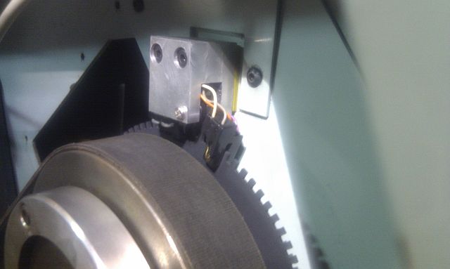

I made a new slotted wheel for the spindle with 90 slots. After several attempts with different opto sensors it finally works. The outputs from A and B are not optimal. At max RPM they are obviously at the edge of their bandwidth. The signal looks like shark teeth. Either I need to change the collector resistors, or maybe better: put an amplifier near the sensors. But it seems to work as it is. Using constant surface speed works all the way up.

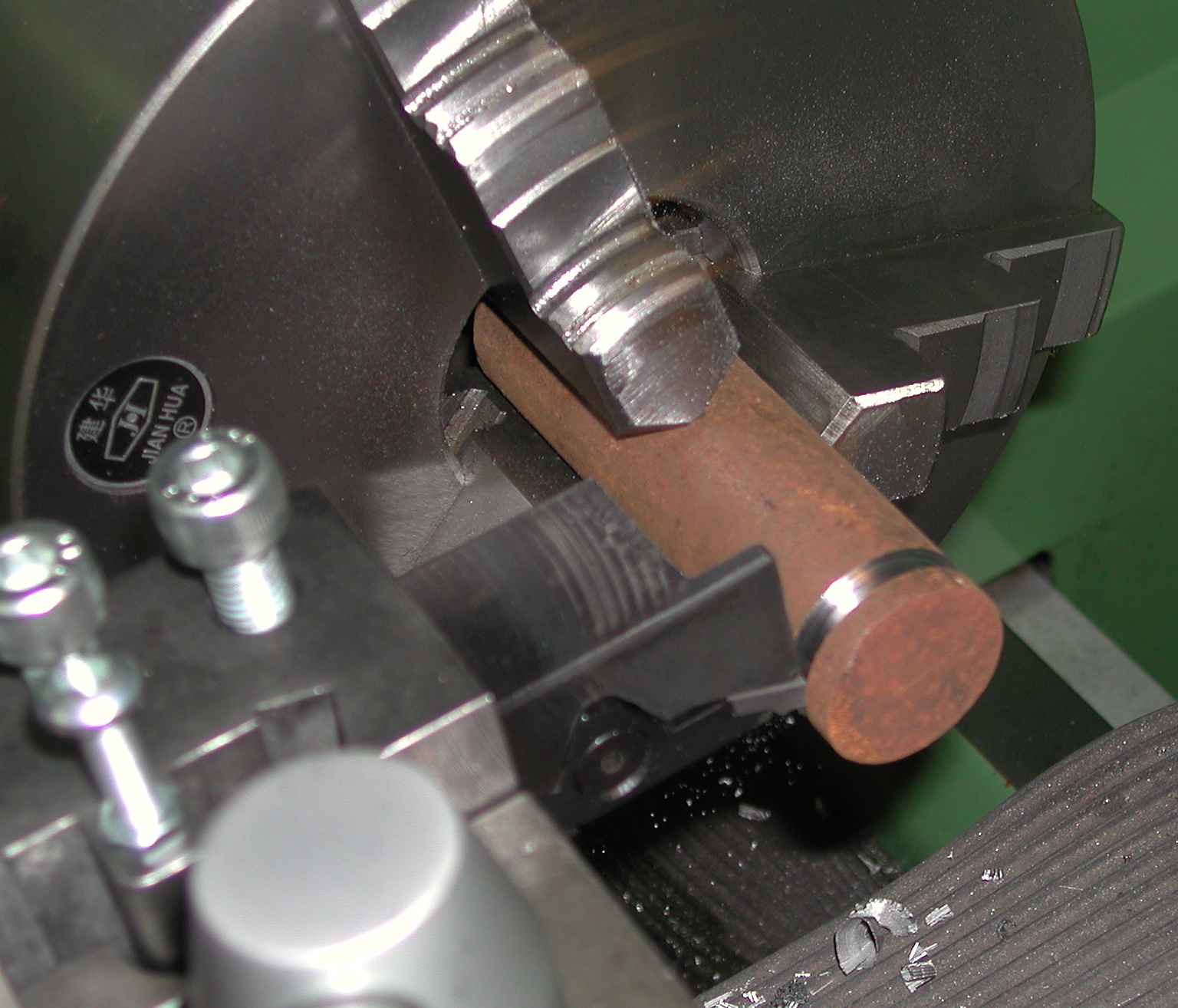

That is not necessary, this is what I do.
I have a toolholder which fits into one of the 20mm sockets and holds a threading tool upside down with the tip perfectly aligned to the workpiece centreline.
(I normally rub another tool edge across the end of the billet to scribe a centre and align to that)
I use M3 for conventional RH threads so that they are cut correctly, the tool being upside down is a real bonus because the swarf drops straight into the swarf tray
without any clogs you can get the other way up.
The tool is presented at 90 deg to the workpiece, so the cuts just need to be lighter than you might get away with if just cutting on one shoulder.
I have a 120 hole optical encoder with a hall effect switch triggered from a small rare earth magnet embedded in the drive pulley for an index.

20 Feb 2014 19:48 #44006 by ArcEye
Replied by ArcEye on topic Converting a Boxford 250B
A picture is worth a 1000 words......
21 Feb 2014 00:19 #44016 by Einar
Replied by Einar on topic Converting a Boxford 250B
I thought about that, but discarded it as it will drive the tool changer against the worm drive instead of the locking pawl.
But I did not think of your arrangement using the hole tool mounts. In that case if the cutting force is getting too high, the tool will be allowed to deflect by rotating in the hole rather than stripping the worm or wheel. Nice solution!
Alignment can be really simple and quick by making a gauge that have a height exactly the same as centerline above the cross slide. I have one for each of my manual lathes. I move this gauge against the cutting edge and when it is just about to catch the height is right. With an upside down tool it can be rotated until it rests on the gauge, then fixed.
I will probably also adopt your suggestion for cutoff tools. They really benefit from good swarf removal, and "overload protection".

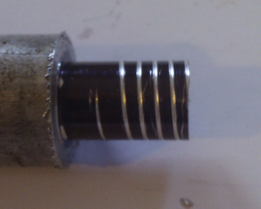

I have now tried some thread turning, and therein also some challenges.
The toolchanger is behind the spindle, so turning an outside thread it is done away from the chuck.
Often there will be a shoulder that prevents much of an entry move. So it becomes important that the thread pitch is correct as soon as possible.
It is not!
The first picture shows a thread done at 300RPM with 2.5mm pitch. The first revolution have a pitch close to 5mm. Then blending
into the correct pitch.
My first thought was that the PID overshoots. But no, then it would also have a section with too fine pitch as it swings into the correct feed.
I think it is something else. Come with me out of the workshop and go for at drive in the car. We'll take the fast one.
On our way we will have to enter a highway. When entering the entry ramp I start looking in the mirror for a suitable opening in the traffic. I target the last car before the opening and start accelerating so I will be at equal speed at the same time as it have passed me with a suitable safety distance. (I'm not a bumper rider.) This method I have found to be relaxed and withouth any large corrective actions.
I have sometimes seen another strategy: A driver stops in the entry ramp waiting for an opening. Then just after the last car passed him he take off with smoking tires and shoots onto the highway far behind the last car. Then he will drive at a much faster speed than the rest to catch up with traffic, and slow down again as he does. That's where his strategy stands out as not very smooth!
I now think that LinuxCNC is using the last strategy. Before trying it out I thought it would predict when the index mark would pass the next time and start accelerating before that. Much like the code in a petrol engine ECU that will time the preignition to a specific number of degrees before TDC by counting pulses from the previous index mark.
Well, long story, but can someone tell me if I'm right or wrong?
If the strategy is to catch up what is lost in acceleration I will have to cut against the chuck end, as there is little or no problem at the end of the cut. It will just retract and "slam the brake". But it's out of cut, so lost synch is not a worry.

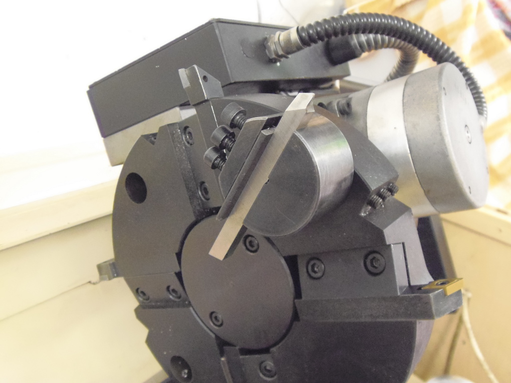

1. I can mount a toolpost in front of the spindle to carry screwcutting tools.
2. I can mount the tool upside down.
3. On the IRC I got an out of the box tip: Make a toolholder that hooks under the workpiece and ends up in front of it.
4. Also from the IRC: Use a Die in one of the circular holes in the toolchanger.
They have some warts though:
1. In my attempts to make the problem as small as I can, I started tuning speeds and accelerations. A lot could be gained in Z (which is what affects this problem the most). But in X the weight of the slanted slide really show one of the disadvantages of a slant bed. In -X it can accelerate fine, and to a high speed. But in +X it have to lift the slide, heavy toolchanger and the motor itself. So the speed and accel needs to be kept very low. Mounting another toolholder will not help!
2. The cutting force will not be against the locking pawl of the toolchanger.
3. If made for anything but small diameter workpieces it will hit the bed.
4. The cutting forces will be high. And my spindle motor have fixed gearing, so is very weak at low speeds. The original was from 200-3500RPM.
Hopefully someone can extend my list of options.
I'm not sure if I wrote this before, but my encoder (Picture 2) has 90 shallow slots for the A and B reading forks and one deeper slot for the index. The index reading fork hangs off the side of the block that carry A and B. That's just because the only reading fork I found that work a deep slot is physically different from the other two.
UPDATE:
I was using G76 threading. So I obviously left out a piece of important information. Sorry about that.
Now I just tried out G33. And the problem does not seem to apply to G33 !?!
Before, I started out at Z-15 and X 1mm outside the thread peak (also tried other offsets). 300RPM.
Issued code g76 P2.5 z3 i-1 j0.3 k2.5 r2.0 q-30 e0.5 l1re.
Now I blacked the surface with a sharpie, moved to Z-15, plunged the tool to a depth of 0.1mm and issued G33 Z0 K2.5
And the result looks just fine! There probably still is an error due to acceleration, I just can't see it since it is so short.
Checking the user manual the Technical Info says G33 does it just like I hoped it did. Rechecking the manual for G76 it just refers to Technical Info for G33, saying it is based on G33.
So either there is a bug in the implementation of G76, or I am not using it correctly. Can anyone please look at my G76 code?
I know the Q is probably wrong, but what is right when cutting towards higher Z?
So for now it seems I can do what I want. I just have to use a G33 loop building routine to make up the needed passes. I have seen one around here.
Last edit: 22 Mar 2014 17:32 by Einar. Reason: New findings.

I use a 120 hole optical encoder plate, which gave significant performance benefits over a previous 60 hole one
I would have thought 1 pulse per 4 degrees (90 hole) should be adequate.

I did try a G33 loop and it looked nice and synchronized. I will have to do some serious tests and see how my thread gauge agrees.
I can use a left handed thread. But not often. And I have no LH thread gauges, so I cannot check the result properly.
