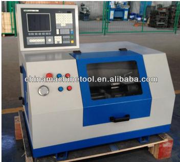

Questions:

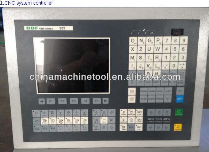

(1) can someone tell me if these parts are feasible on this type of machine. It is possible to order it with the stepper motors, or with a servo motor.
(2) if I order the machine with servo motors, the machine comes with a controller GSK or BBF. This causes me a problem, because it is not translated into French. Do you think it is possible to adapt LinuxCNC with these controllers?
Or is it possible to buy this machine without controller, buy the cards controller adapted to this type of machine, then to work the with LinuxCNC machine?

26 May 2014 20:06 #47345 by ArcEye
Replied by ArcEye on topic Micro cnc lathe and LinuxCNC
Hi
I have no knowledge of these machines per se.
The manufacturers web site shows 3 options, a stepper powered machine with manual tool post suitable for control by Mach 3
That one could be controlled by linuxcnc as easily
The stepper and servo powered ones with dedicated controllers are complete units and it would make no sense to buy one and convert it.
You would just use the supplied controller.
The things that might make me baulk at these are the price, which is high for such a small lathe and what if any after purchase support and warranty there is.
Unless you have a local supplier (re-seller), with spares and repair facilities for these machines, you might as well buy from someone on the moon, as try to deal direct with a firm in China.
For the same price you could buy a used industrial machine (probably too big for you though) and for far less you could buy a good ex-college CNC training machine that could be converted to Linuxcnc
Depends if you are interested in restoring your cars mainly and just want something that works out of the box, or if the prospect of a conversion interests you
Just my thoughts
regards

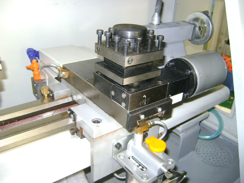

28 May 2014 18:06 #47448 by micoudic
Replied by micoudic on topic Micro cnc lathe and LinuxCNC
Thanks for the info.
I looked, and then query the BoxFord site. I asked them for information on their lathes. I have no answer :(
I have a few questions regarding LinuxCNC:
1) If the proposed machine is intended for work with MACH3, is it possible not to use MACH3 and use instead LinuxCNC?
2) a- And If the machine is equipped with servo motors, is LinuxCNC can work axes, in this case?
b- LinuxCNC knows manage the automatic turrets (auto control tool post)?
Thanks for your replys.
28 May 2014 18:26 #47451 by ArcEye
Boxford only deal with educational establishments, selling new machines at huge cost with training and maintainence packages, they are not interested in individuals.
You don't need anything from them to convert a 160, all the info is on the web.
The one Andy pointed you to was already converted I think.
Yes, it is quite simple to convert the config they supply to a Linuxcnc one
Yes Linuxcnc can control them, but there is absolutely no point in buying a servo machine or one with an ATC and converting it.
It already comes with a dedicated controller, which you have just paid through the nose for, you should use that.
regards
Yes. Anything Mach3 can do, LinuxCNC can do (with the exception of the USB-based controllers such as Smoothstepper, which arguably isn't still using Mach3)
Yes. I have a mill driven by AC brushless servos, with Resolver feedback, all controlled by LinuxCNC. That's pretty much as far from a stepper system as you can get.
Yes: wiki.linuxcnc.org/cgi-bin/wiki.pl?Contri...oolchanger_component

The seller told me that when the cnc lathe is controlled by a microcomputer, it cannot control the turret.
To fly the turret, he need a controller BBF or GSK, Siemens etc..
What do you think?
28 May 2014 20:03 #47457 by ArcEye
What do you think?
It is rubbish, but since they do not sell a lathe with a ATC that does not already have a controller, completely irrelevant.
