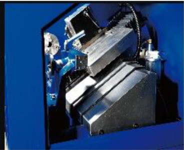

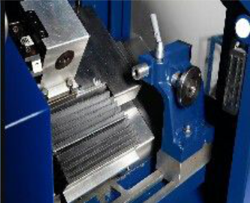

28 May 2014 23:15 #47464 by andypugh
Replied by andypugh on topic Micro cnc lathe and LinuxCNC
The seller told me that when the cnc lathe is controlled by a microcomputer, it cannot control the turret.
To fly the turret, he need a controller BBF or GSK, Siemens etc..
What do you think?
I think he is talking through his hat.

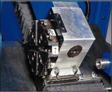

28 May 2014 23:44 #47467 by PCW
Replied by PCW on topic Micro cnc lathe and LinuxCNC
Is a rather nice example of linuxcnc controlling a turret as well...

30 May 2014 14:20 #47541 by emcPT
Replied by emcPT on topic Micro cnc lathe and LinuxCNC
What do you think?
Mine is fully controlled by linuxcnc, so what the guy told you is not true.
In fact before I make a few with the turret controlled by Mach3 also.

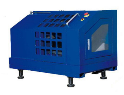

30 May 2014 16:56 #47543 by andypugh
Could be dangerous to guess, that is why I said to contact them.
Good point, the Axminster site with a very similar lathe says that it has an "operating system" build in, and that it can be connected by ethernet to any windows computer.

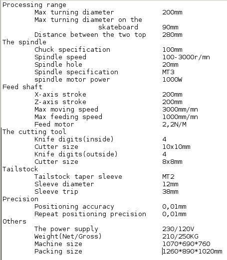

01 Jun 2014 14:27 - 01 Jun 2014 14:32 #47588 by micoudic
Replied by micoudic on topic Micro cnc lathe and LinuxCNC
Thanks for the infos. Nice videos :)
Here are more of my research:
I have find a tower with the following characteristics:
But the connection is made via ethernet. Well, I saw the message from andypugh. Effectively; Axminster sells a fully equipped machine. It works with the SIEGI controller. This controller / software is in English only (or Chinese).... My problem is that I do not understand English. I do not want to take risks, with a bad interpretation/translation. For this reason, I would like to work with Linuxcnc. It will be already quite complicated to set up.
I spent lots of time searching if Linuxcnc can work with an ethernet link. I found that Yes, it can. But how Linuxcnc works with an ethernet link? There, it's complicated for me.
I have seen the need to buy and install specific components, load software/drivers. It seems that there are a host of solutions. I am a little lost in all of this information.
Is someone using this type of machine with LinuxCNC and an ethernet link?

01 Jun 2014 16:31 #47592 by ArcEye
Replied by ArcEye on topic Micro cnc lathe and LinuxCNC
OK, I had not realised that the overriding criterea was support and documents in French, not any technical superiority.
There is no readily available ethernet connection component for Linuxcnc and no guarantee whatsoever that the SEIG system complies to any ethernet standards anyway,
since it is only being used locally with their own software
The easiest thing In that case, is just find a machine that does what you want and works with Mach and does not use a usb stepper board
It will be trivial(ish) to convert the config for Linuxcnc and it will already have all the controllers and connections you need to just plug into a computer.
regards
