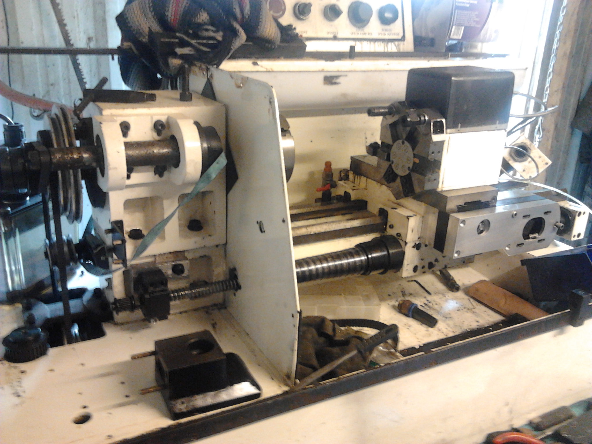

has anyone run a dyna 3000 lathe?the few conversions ive seen for these lathes all seem to be running on mach.
mine was going to be a straight forward conversion to mach and already had the tool turret macro that somebody give me but now I want the lathe running on Linux.

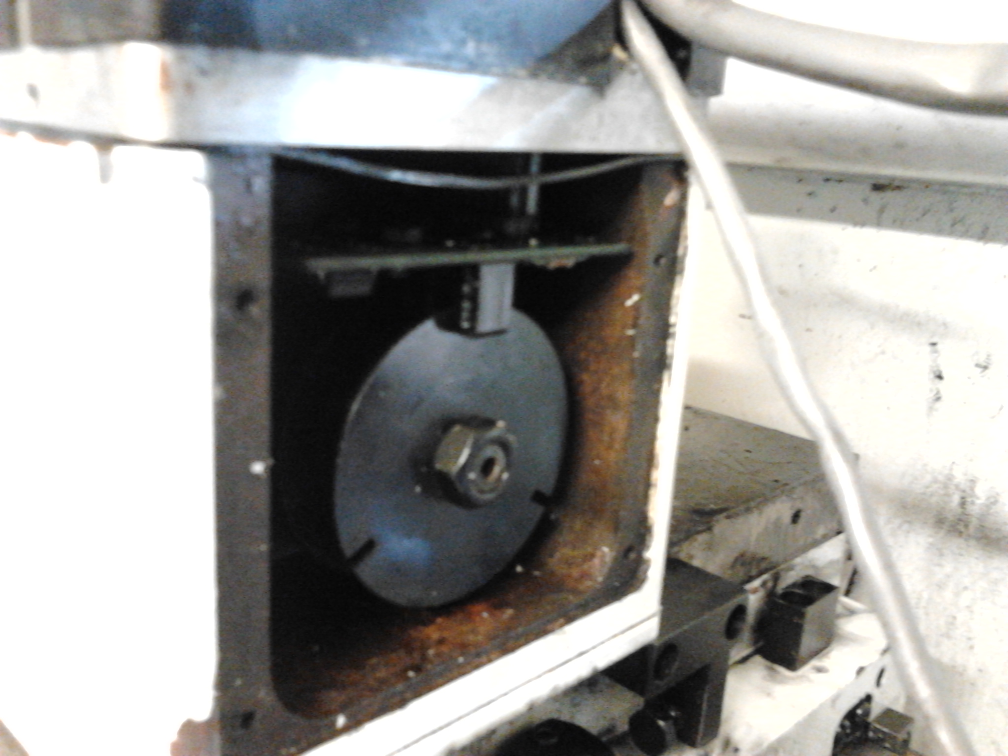

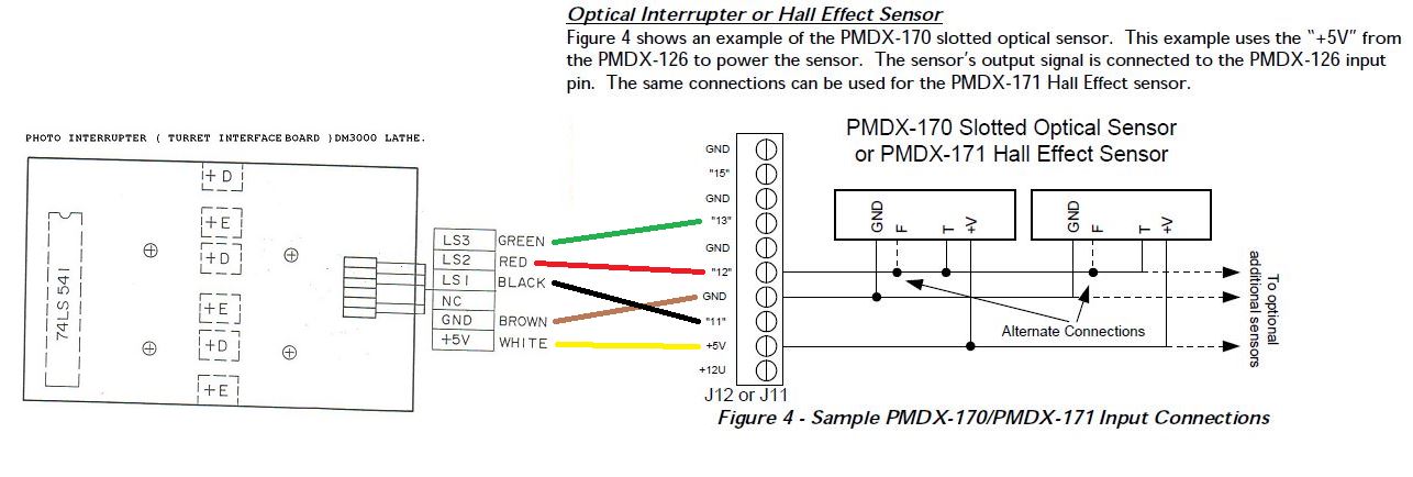

the tool turret has a board with 3 slot sensors and in each slot a disc with notches in it the board will be wired up to the pmdx 126 see image. theres also a 24v solenoid that lock and retracts a pawl,im told id wire this up to the k1 relay on the pmdx.
the turret it rotated via a nema 23 stepper.
id be keen to know if anyone has put one of these lathes on Linux,

The Orac toolchanger I wrote is probably the nearest to your ATC, although slightly different.
wiki.linuxcnc.org/cgi-bin/wiki.pl?Contri...oolchanger_component
If Mach can do it, then LinuxCNC can do it. And almost certainly better (LinuxCNC is better at threading than mach).
Was the lathe originally stepper or servo controlled? LinuxCNC can control most types of servos, whereas Mach generally needs step-dir interface drives.

thanks lads macro below that's all I was given ,its done the rounds I think and is being used by several on the zone.
the turret had a vexta pk 266-e2 OA 2 phase 1.8 step motor im hoping to still use, and on the axis's ive fitted nema 23 420oz steppers, originally both axis had escap steppers,thanks.

the orac toolchange component , should just about fit
apart from the operation of the pawl locking solinoid , which is easily controlled by the run relay output
the opto inputs may be in a different order , so that will need checking if you have the positional code
