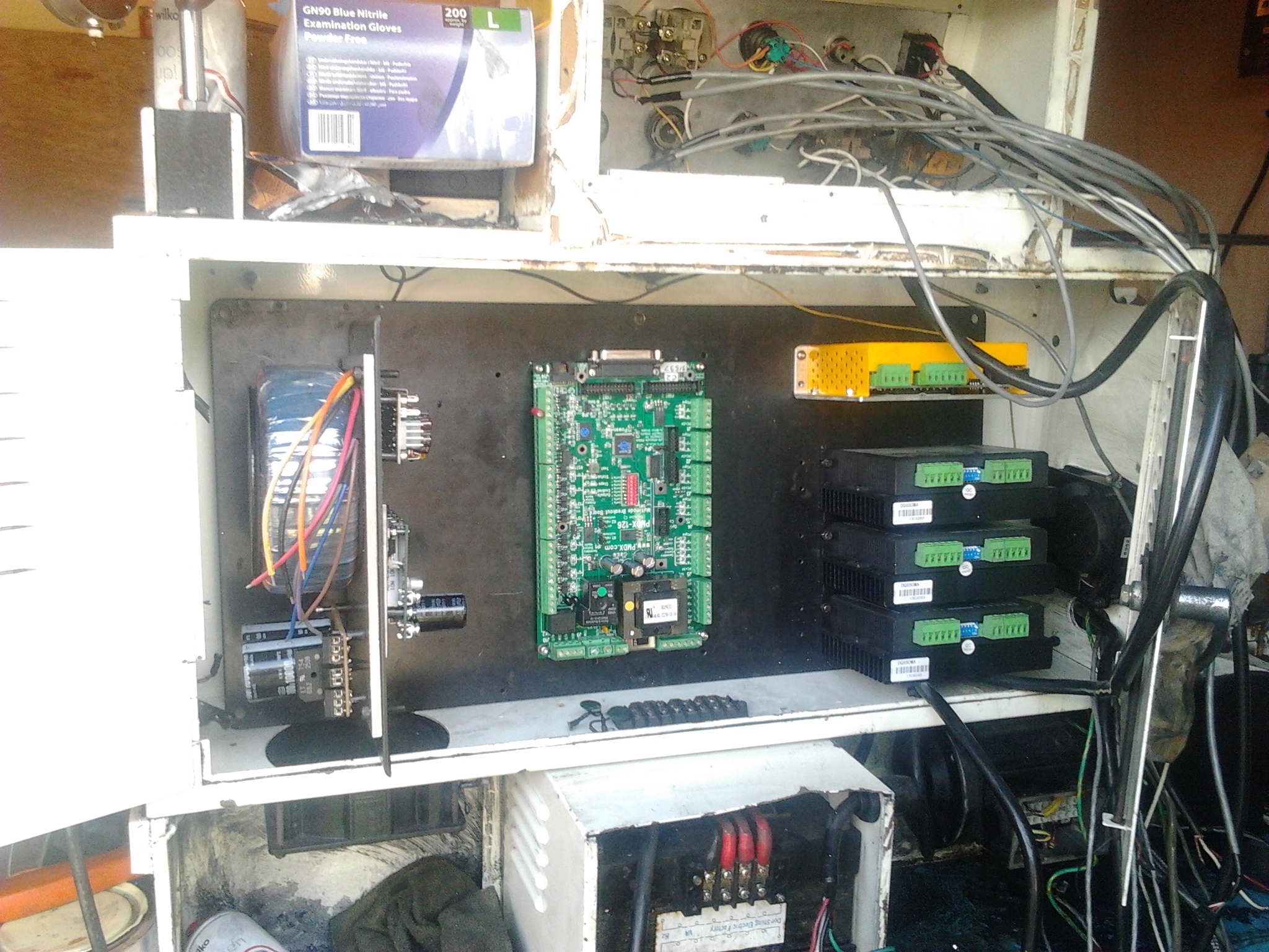

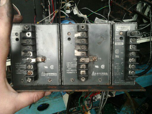

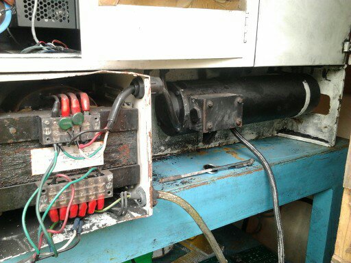

the spindle was powered by a big 240v to 110v transformer that's still on there.these are fitted in the back as standard
see image I still have things like spindle motor with its tach and brake the heds encoder the slotted sensor on the spindle and the turret board with its sensors
everything else has gone
second image you see a pair of 24v supplys and 1 x 5v
the parts I have so far are below
3 nema 23's 2 for axis's one for turret.
3 drivers- DQ860MA 80V 7.8A( I realise an 80v driver is excessive for the turret and will most likely change that)
70v toroidal power supply
pmdx 126 break out board and the 107 spindle speed board that plugs into it..
the dgs4 dc servo drive. and a braking circuit.

I wouldn't go for a second parallel port. Look instead at the Mesa 5i25. That can drive both sets of inputs to the PMDX board. The advantage there is that it can generate far faster, smoother pulses than the parallel port. It can also count encoders many times faster, and that might matter.
eusurplus.com/index.php?route=product/pr...ue&sub_category=true
It's a bit more expensive than a parallel port, but it does a whole lot more.
Normally I would suggest the matching 7i76 board as the breakout, but you already have the PMDX board, and that ought to work (albeit with less total IO)
I have met the PMDX guys at a LinuxCNC meetup and it is possible that they might have advice on LinuxCNC setup.
Do _not_ buy a Smoothstepper, that won't work with LinuxCNC.

A single parport is just about enough for a lathe, so I would suggest wiring things up and getting things moving with just the parport and PMDX 126.
Cross-referencing the PMDX and Gecko G540 pinouts (because the 5i25 is available with a firmware that matches the G540 pin arrangement)
So you can use the G540 pin allocations with the PMDX with no problems, and then if you later decide on the 5i25 you can use the G540 firmware without having to make any wiring changes.
(In fact you can keep two separate configs, one for parport and one for 5i25)
