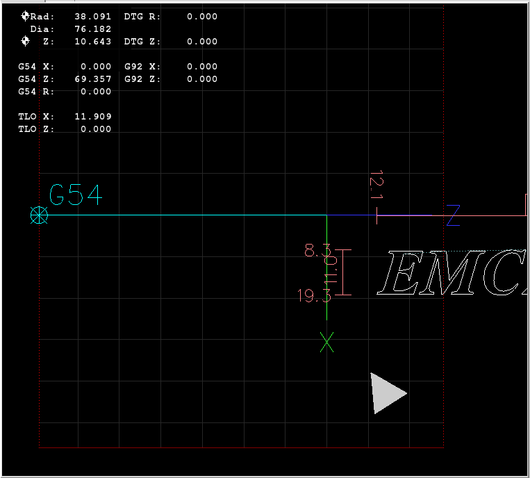

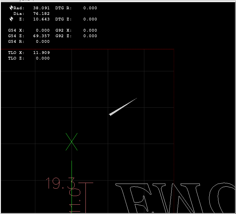

18 Jun 2015 00:10 #59916
by Simmsey
Replied by Simmsey on topic Lathe tool image not displayed - Rear tools
Attached some screen shots of the tool display problem as well as normal display when screen not flipped.
Does anyone else see this problem/bug?
Is there I can do about it? I can't find anything searching the forum.
I'm new to Linuxcnc. Should I raise a bug report?

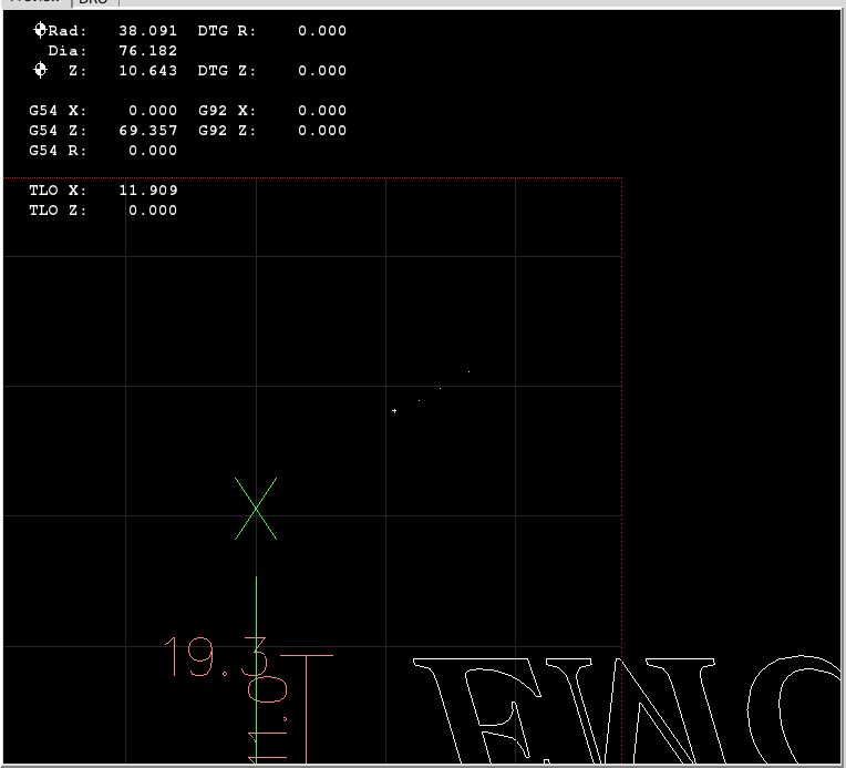

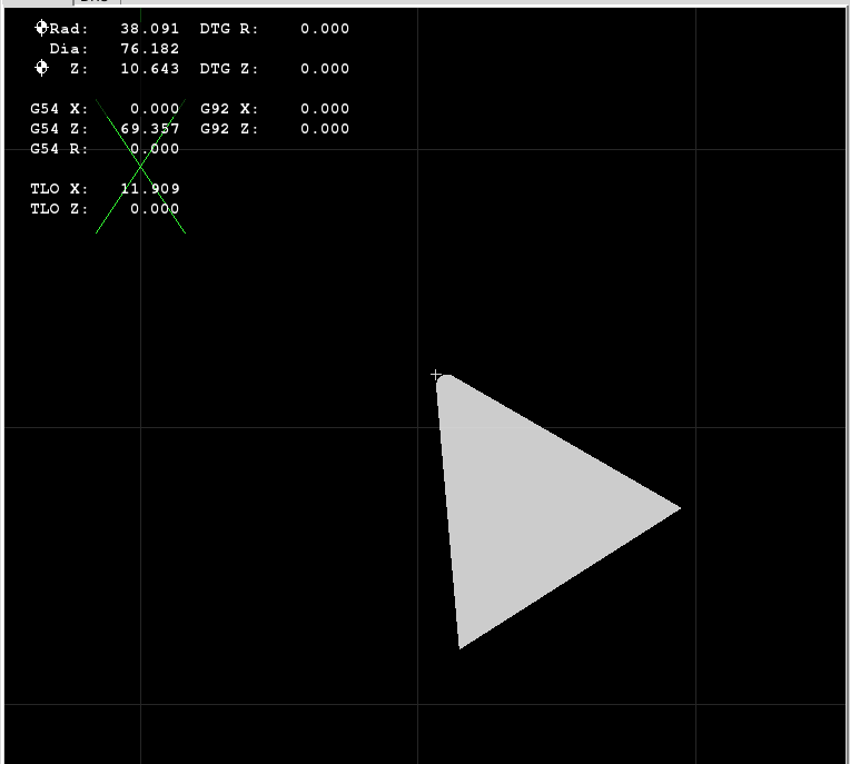

18 Jun 2015 00:17 #59917
by Simmsey
Update:
I've tried some random tool table changes to see if I could get tools displayed correctly or just modify behaviour to understand it better.
I have tried various changes to front and backface angles - display very similar but with pixels at different angles.
The most different display I could achieve was by trying a negative tool tip dia. I know this shouldn't be sensible but it did then display more than just a few pixels.
Attached is the tool display with this setting in case this helps someone identify what's going wrong with the tool display.
Simmsey

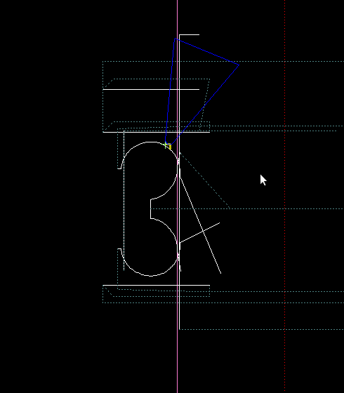

18 Jun 2015 23:09 #59952
by emcPT
Replied by emcPT on topic Lathe tool image not displayed - Rear tools
This is the best that I could do. It displays only wire frames.
If it interesting to you or someone else on the forum I can try to port my code to the latest development version and make it public. Maybe some one of the gurus can add it to the source code.
I also changed the tool direction to suit the "fanuc style" that is different from linuxcnc (for example tool tip direction on fanuc number 2 is on linuxcnc number 3).
