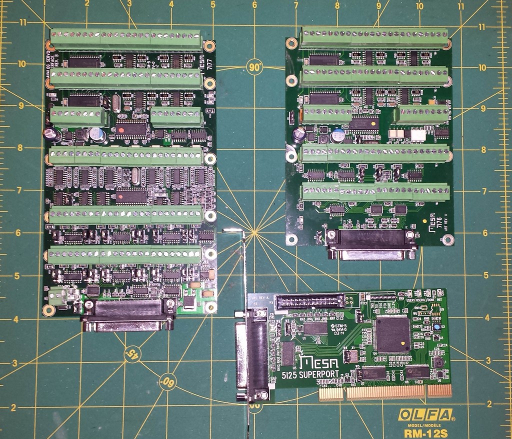

So do Tormach use a 7i76 on the other end of the 5i25 or do they use something else?
- cncbasher
- Posts: 1021
- Thank you received: 202
20 Sep 2015 17:25 - 20 Sep 2015 17:26 #62806
by cncbasher
Replied by cncbasher on topic Ditching Mach 3/4 LinuxCNC is The Plan!
they use their own interface using USB for some gpio functions , and the 5i25 for stepgens etc
easily modified if you wanted to use a 7i76 etc , or any other interface

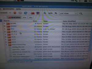

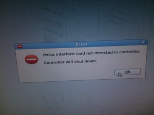

20 Sep 2015 21:30 - 08 Nov 2015 07:16 #62816
by Rhine_Labs
Replied by Rhine_Labs on topic Ditching Mach 3/4 LinuxCNC is The Plan!
Played around this morning for a bit,
You can get to the desktop just cancel out of the controller and use the Left ALT + SHIFT at the tormach screen on reboot.
That is as far as I have gotten, have to go to work! Will play more when i get home. I will try and figure out how to get it to boot and bypass the mesa card check and work from LPT port.
Why is post Locked from Replies?
Got My Mesa Cards! Will be rewiring next week.
Last edit: 08 Nov 2015 07:16 by Rhine_Labs.

10 Dec 2015 08:29 #66720
by Rhine_Labs
Got busy was not able to wire it up possibly this weekend, but I forgot to order my wire. Will Still play a bit.
