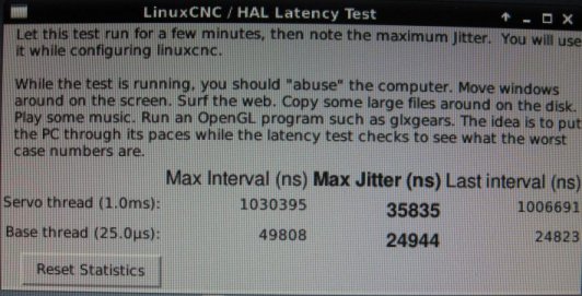

I am wondering if linuxcnc can do low rpm threading with just software and a low count spindle encoder and no external encoder counter hardware involved. In my reading I have not found anything that relates latency test results with encoder counting ability.
I realize the Mesa 5i25 + 7i76 would be the deluxe path but please hear me out. The discussion may be of use to others if only to warn them away from my path.
I have a typical bench top lathe already converted with a common setup. Mach 3 is interfaced through a PMDX 122 to Gecko 201 and steppers. Spindle is powered by a 2hp motor + VFD. Spindle control is manual with just e-stop, start-stop buttons, forward-reverse switch and a pot for spindle speed. So far the Mach control has just been used for manual jogging, no real CNC. I understand Mach is not robust for lathe control.
The spindle motor drives a double reduction belt drive with two ranges. In the low range the low speed torque is excellent and so I imagine threading can be done at fairly low rpm. Can linuxcnc keep track of a low count spindle encoder at low rpm without the assistance of something like the Mesa boards? How low can the spindle encoder count be and still give adequate threading capability? Is this futile? I think the Mesa boards are a good value but the budget is pretty tight right now. Thanks for any guidance.
Below is the results of my latency test.

Your CPU has rather poor latency specs so this will limit your maximum base thread rate to about 8 KHz
(1/ (max_latency*2) which will in turn, limit both your maximum step rate and encoder resolution in a parallel port system.
so if you have another possible PC you might try it.
Also have you made sure to disable all power saving option in the BIOS?
If this is an older PC, you might chose an older OS like the Ubuntu 10.04 linuxcnc distribution as it tends
to have better latency on older hardware

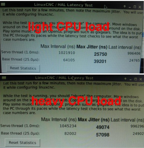

Thanks for the replies. Some real world feedback is valuable at this point. I do have a faster, dual core machine I tried last night. Latency numbers look better, I think.
