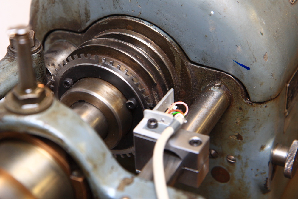

I didn't get change wheels with my Boley 4LV, so I have made up a bracket to run a Nema 34 stepper as an electronic lead screw.
I made a spindle encoder with 45 slots on the A phase, and a single deeper slot for the indexer (Z).
I have three issues:

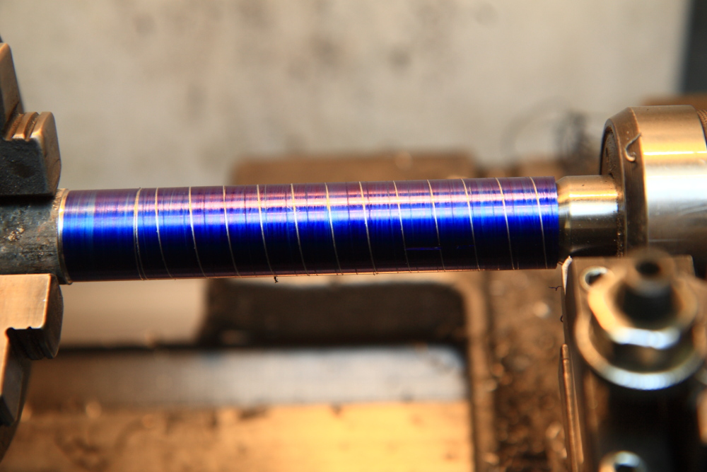

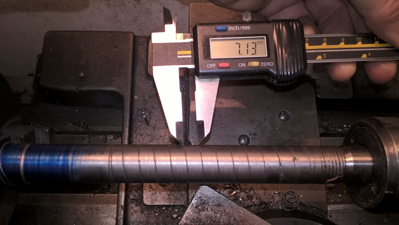

1/ Did a threading test and when commanded G33 Z-95 K 10, I am only getting a 7.2mm thread pitch. Linear moves are correctly scaled. The behaviour is consistant, as the two pictures show the first and second pass along the same thread, and they overlap. I have the .HAL set for 45 count encoder.

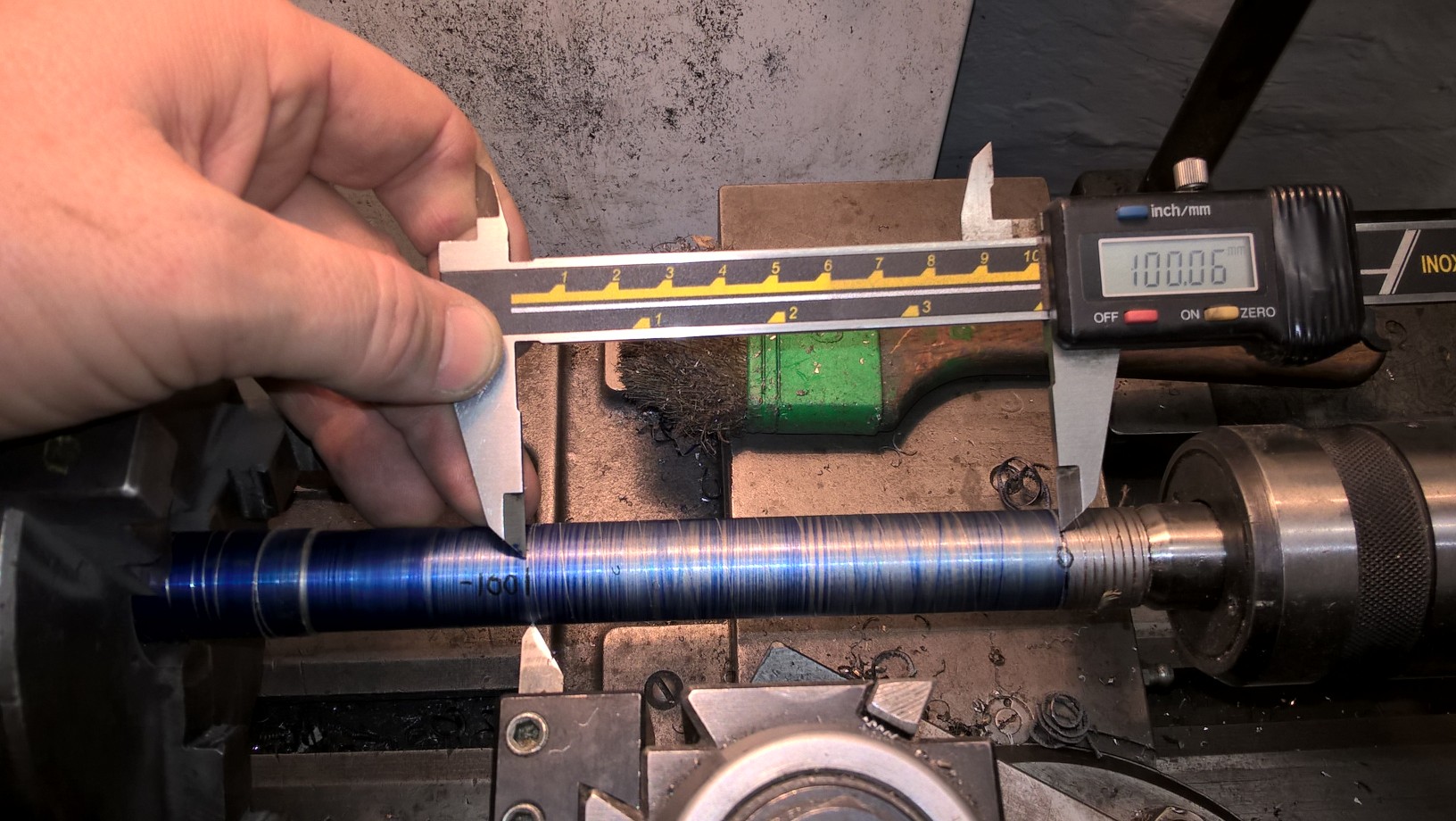

Hi Andy. Thanks for taking look. I tried G0 z100 moves and distance traveled against a ruler was 100mm.

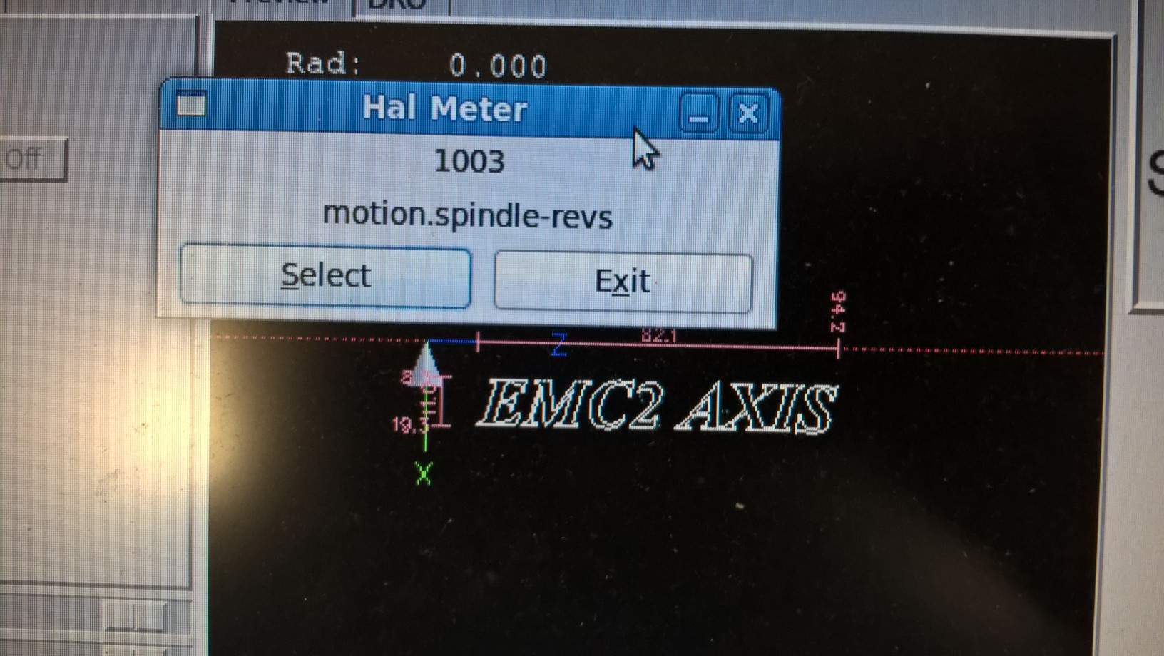

You know, 45 counts is very unusual. Can you check that motion.spindle-revs increases by exactly 1 for one turn of the spindle?

I used the Hal meter to monitor motion.spindle-revs. Whether turning the spindle by hand or when running under machine power at 900 or 1800 rpm it seems to keep sync fine. I ran 1900 RPM for about 985 rotations, and then turned it a bit by hand, and the index slot still lined up with it's starting angle as it completed each full rotation with the motion.spindle-revs clicking over as as an integer.
I ran G33 Z-100 K10 again three times. The Z move ended correctly after 100mm. All three threads were perfectly aligned, but at 7.2mm pitch. I was wondering if it could be stray light affecting the sensor, so I turned the machine light off and shielded the area of the sensor, but it made no difference.
