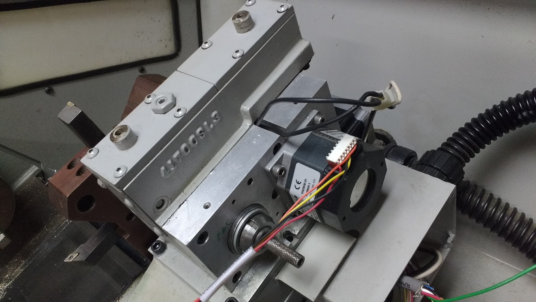

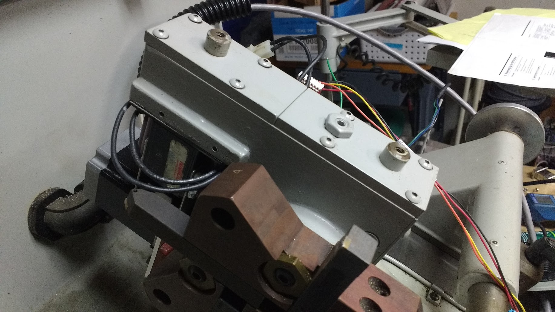

I acquired a SBL Magnaturn 612 lathe for a conversion project. I have replaced all of the controls and steppers motors for ease of later service. I have now completed the hardware conversion and have been playing with single tool cuts (So far so good). But, now it is time to add the controls of the turret. The Magnaturn has an eight position turret controlled by a Stepper and mechanical stop controlled by a 110VAC solenoid. It previously had an encoder on the turret axis for tool position feedback. This seemed like overkill to me (Maybe I am wrong), so I removed it. I plan on adding a single index position sensor for tool 1 position with the remaining tools being X number of steps away from Index.. I have been running straight out of the paraport, but now I am using a 6i25 and 7i76.
So, my questions are these:
1) Can I simply load a configuration that someone has already determined that will work out of the box? Yes, might be the answer... If a configuration exists, but needs modification, I am up for the learning opportunity... I just need some direction on how/where to learn. I know PLCS, I have piddled with python (online exercises only), I have some programming experience, etc... I might struggle, but I can learn if needed.
2) If no configuration exists, Where do I start? Looking for general direction.
3) I have seen a few mentions of conversational lathe tools within linuxcnc. Are those available to add?
4) I almost decided make it gang tooling or have a QC post and manually change tools as needed since either would be tool offsets only. But, I thought that was defeating the purpose. Any thoughts here?
Thanks!

One of the existing HAL components here might fit:
wiki.linuxcnc.org/cgi-bin/wiki.pl?Contri...oolchanger_component
You could also consider re-mapping the tool-change to a G-code subroutine to withdraw the pin and move to Tool degrees on a suitably calibrated G-code A-axis.
Setting up the toolpost as an A-axis is just a simple way to get it added to the homing sequence. Set up as a locking-rotary I think the lock-pin operation would become automatic too.
An example of a tool-change using re-mapped M6 can be found in sim->axis->Vismach->VMC_toolchange. That is a vertical mill, but much of the config will be identical.
