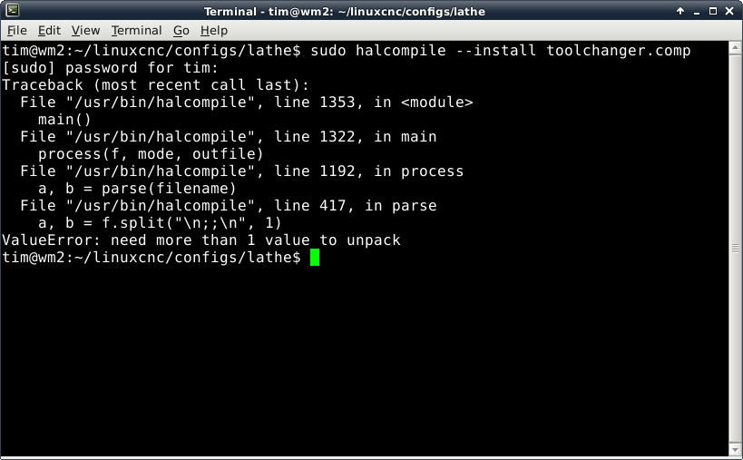

When I originally installed the toolchanger.comp I modified it slightly to work with my turret. What I did not realize at the time was that the behavior is good only until the turret position accumulates to 360 degrees. At that point, it rotates in the opposite direction. All tool changes are in a single direction until that point. This is causing an issue that I am having trouble fixing.
My real issues is that I have been unable to get halcompile to work again.
I am within my directory with the component, but I get the error seen in the image.
I am including my toolchanger.comp file, but my expectation is more that you can help me understand if I am compiling incorrectly. I know at this point my toolchanger.comp file likely has issues, but without being able to get halcompile working, I am stuck.
What am I doing wrong with halcompile?
Any help will be greatly appreciated.

The problem seems to be that halcompile is failing to split the .comp file at the ";;" token.
Opening your .comp file in Note[ad++ it seems that your .comp file has visited a Windows machine and all the line endings have been converted to CR/LF.[1] The Parser is looking for "\n;;\n" but the file actually contains "\r\n;;\r\n"
I can see a good argument for halcompile dealing more politely with this problem.
As I already had the file open in Notepad++ (In Windows, as it happens) and that has a menu option to change line endings, I converted the ile back for you.
[1] See en.wikipedia.org/wiki/Newline if this needs explication.

My ignorance is being showcased for all to see.
I have been using Notepad++ on my laptop. I never paid any attention to the EOL.
I will now.
I really appreciated your help...Again!
