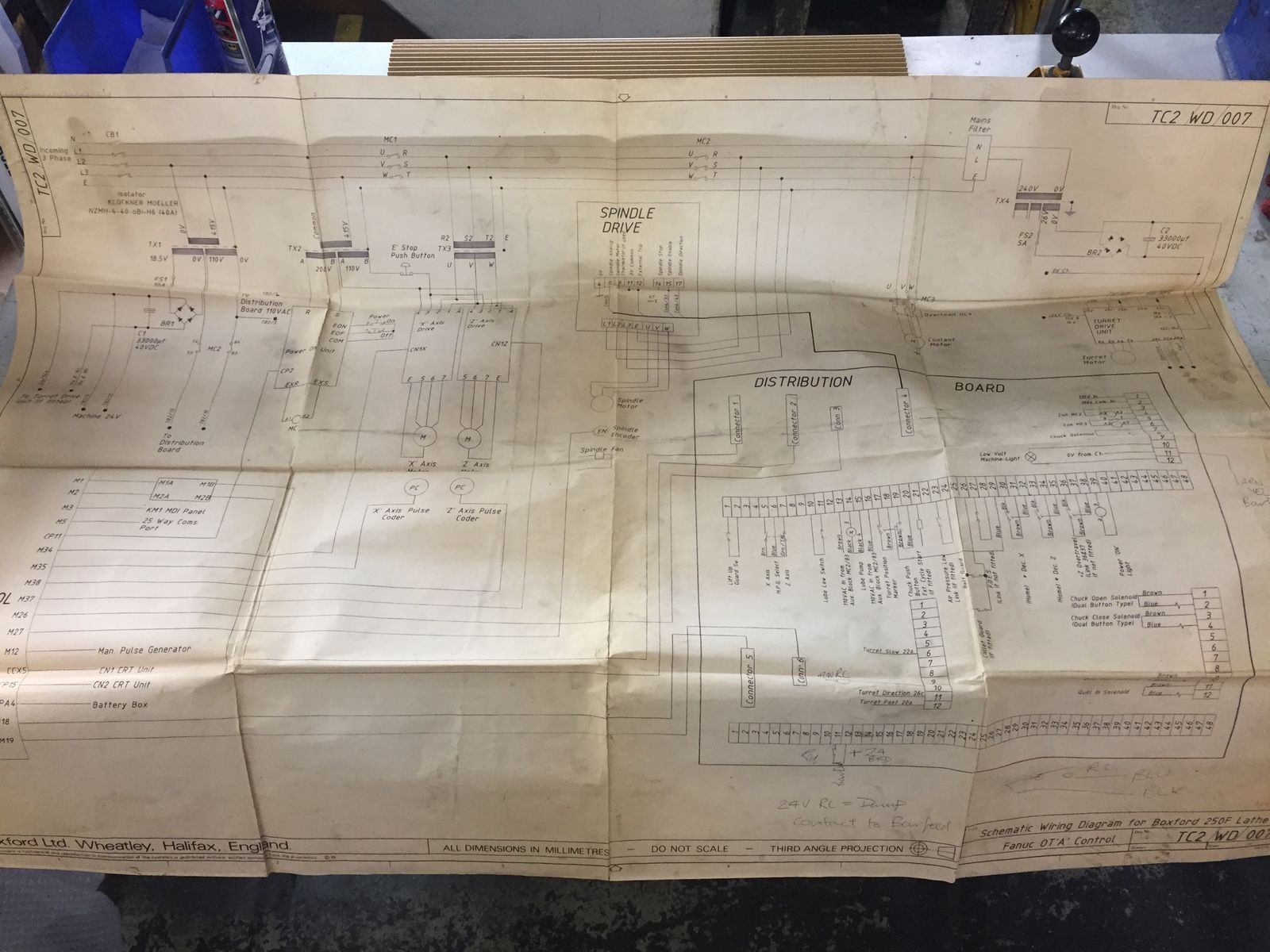

by Ross77
Replied by Ross77 on topic Boxford 250F options?
only a basic schematic show the connection to the 3 phases but nothing for the drives them selves
- Posts: 19897
- Thank you received: 4651
28 Feb 2018 14:05 #106702
Replied by andypugh on topic Boxford 250F options?
Try googling for the drive models, there is an astonishing amount of stuff out there.

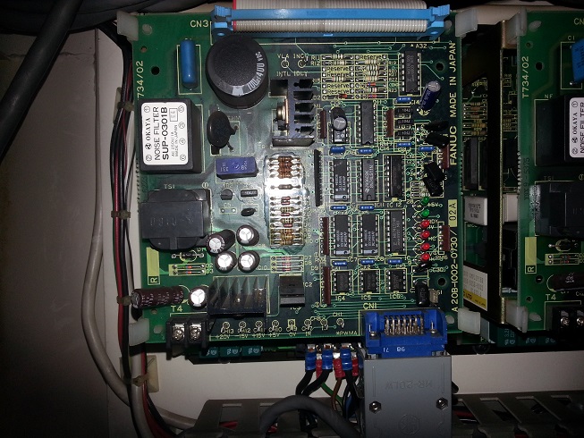

- Ross77
- Posts: 110
28 Feb 2018 14:29 #106704
by Ross77
I did try but nothing came up except people selling the same or similar.
model is A20B-1002-0730/02A
- Todd Zuercher
- Posts: 4782
- Thank you received: 1472
28 Feb 2018 15:24 #106706
Replied by Todd Zuercher on topic Boxford 250F options?
I think part of your problem finding any info, is that part number isn't the part number for the servo drive, it is one component of the servo drive. I think the sticker with the drive part number should be somewhere on the side of the metal frame that that board is mounted to, and should start with A06B-.

- Ross77
- Posts: 110
26 Mar 2018 22:48 #107927
by Ross77
Just got the machine back from a friends lock up so I have finally been able to check the motor drives. They are A06B 6058-H002.
I still cant find much info, some seem to run off 240v and just use the second phase to boost the power when needed.
So if they can run off 240v is it a simple case of tapping into the 10v control line?
