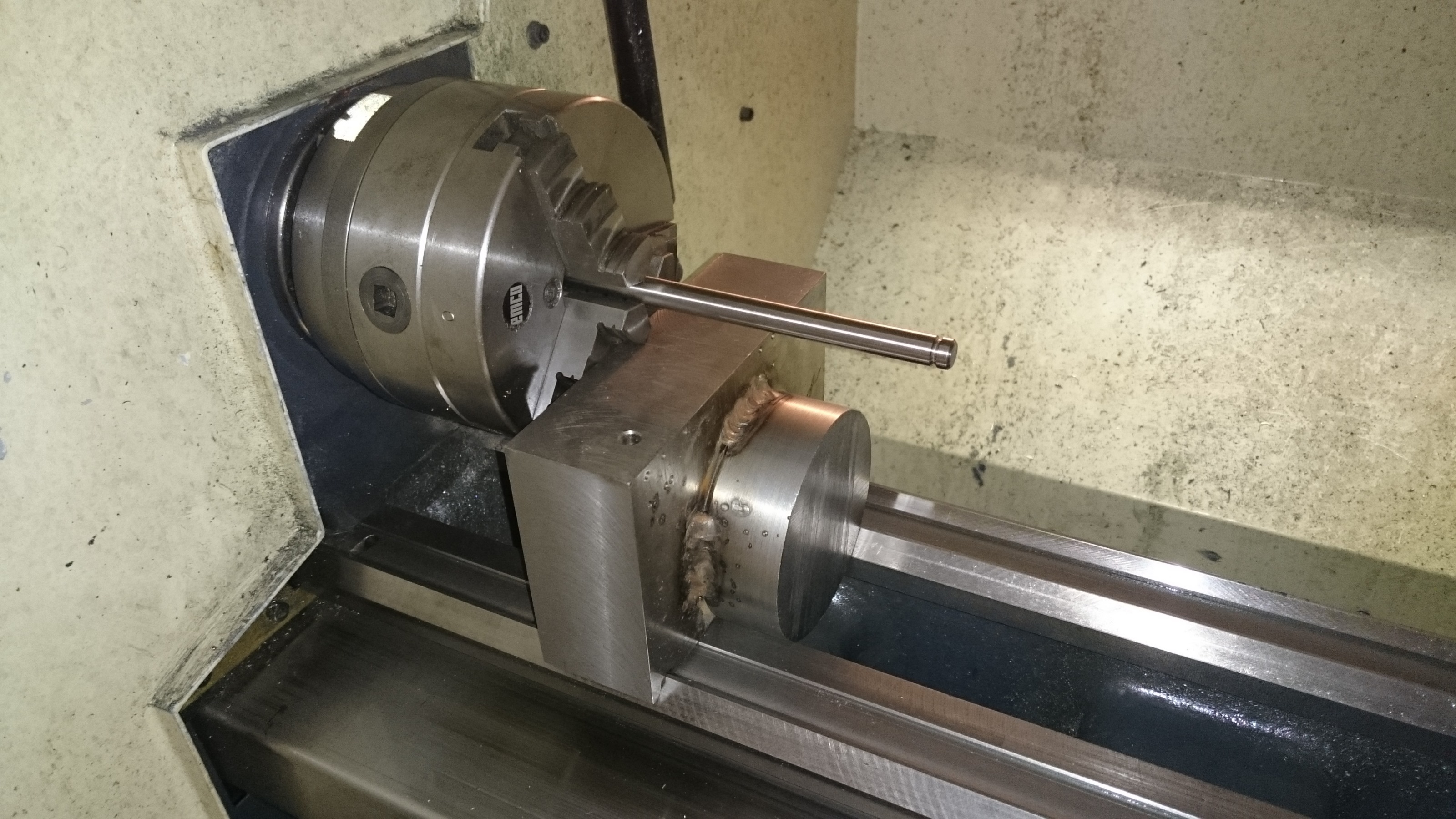

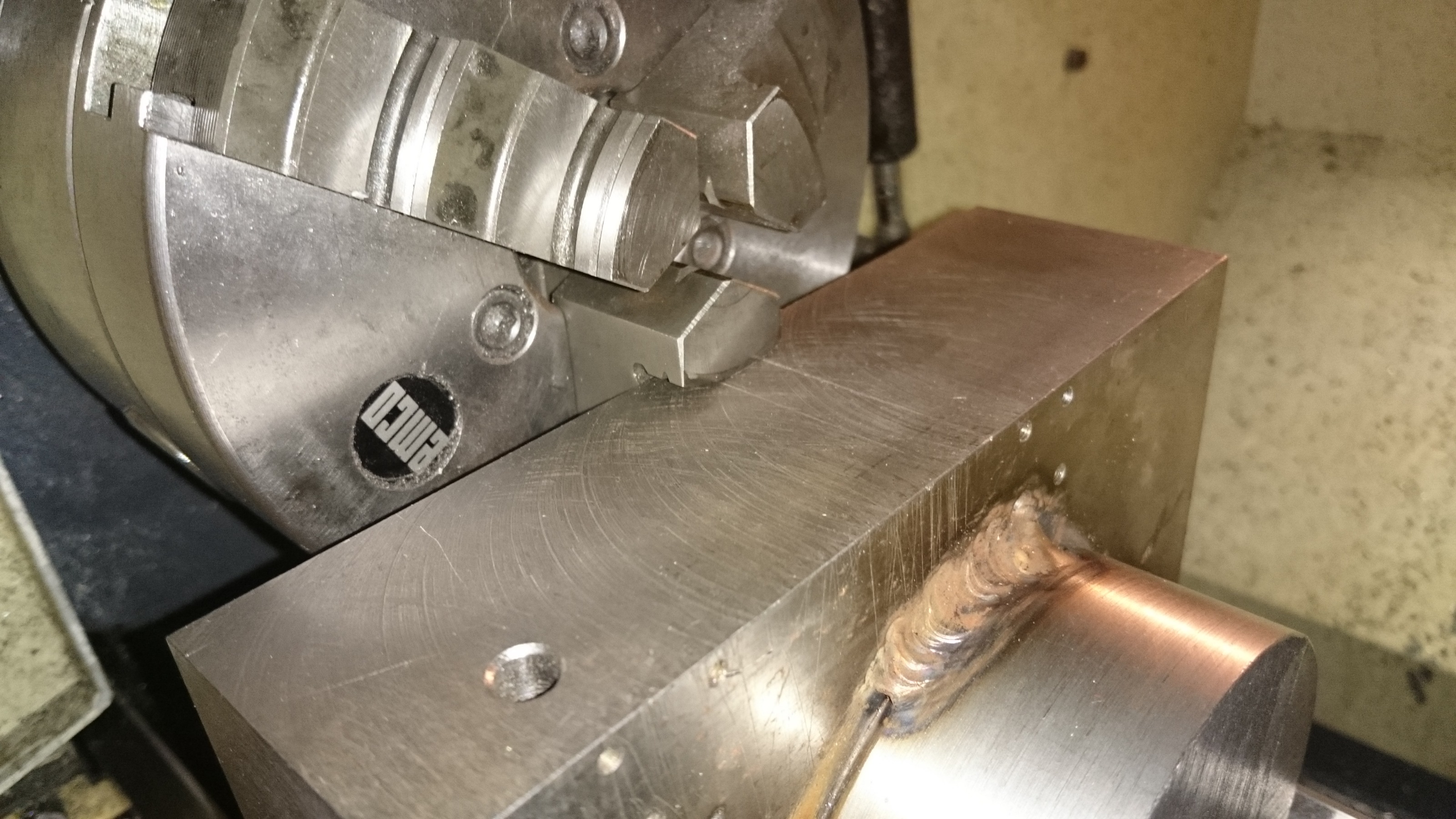

Started a small project years ago when I was using Mach but never got time to finish.
Made this base for a probe, it is heavy and very sturdy and will register to same position. Mock-up with bar to show probe tip.
Need to fix a fixture for the probe, probe tip will be flat quadrant type that should be easy to line-up.

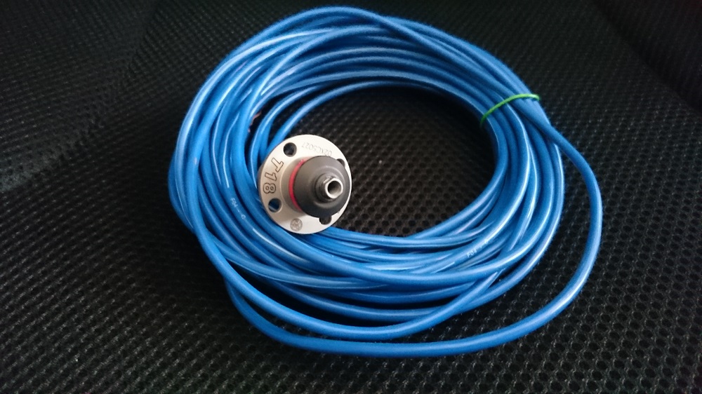

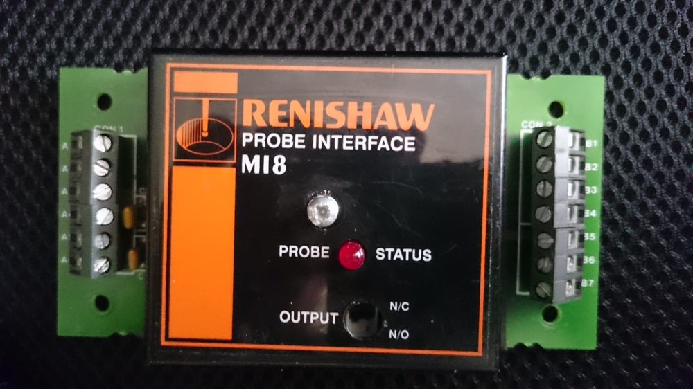

Will be using a Marposs T-18 probe with a Renishaw inteface board.

Why I decided to go with a *block* to fix the probe in Z is that whatever chuck I have mounted I will always have the probe Z in same position. Work in progress (very slowly
I also have one of those *arms for lathe* from Renishaw but I can not find a good way to mount this, but still contemplating a rebuild if the arm.
