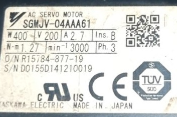

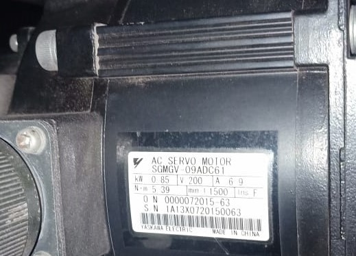

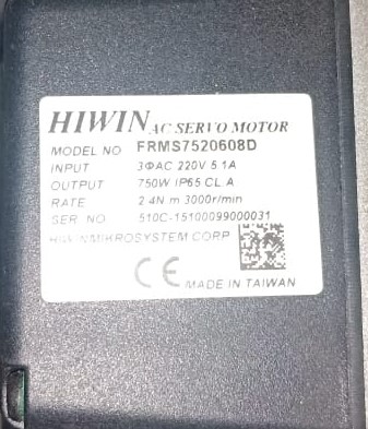

I'm using Universal stepper controller made by pico systems.
i'm using a 3 servo system, 2 angular and 1 linear ,all are running in open loop.
2 angular are yashkawa make.
axis 2 (in my ini file) 400 w (1.3Nm rated torque/rated speed 3000rpm) reducer of 5:1 //
servo pulse / rotation =72000//
axis 1 (in my ini file) 840 w (5.39 Nm rated torque/rated speed 1500rpm) reducer of 10:1 //
servo pulse / rotation =36000//
1 linear servo
axis 0 (in my ini file) 750 w (rated torque 2.4Nm//rated speed 3000rpm) ball screw pitch 25 mm /
rotation //servo pusle/roation = 100000//
i cant get it to move to speed of motors capabilites
max it moves is at 70 mm /min
above that it throws line 2 following error.
please guide me in pointing out my error.
i'm attaching my ini file with this thread.
and also the name plate of all three servos.
