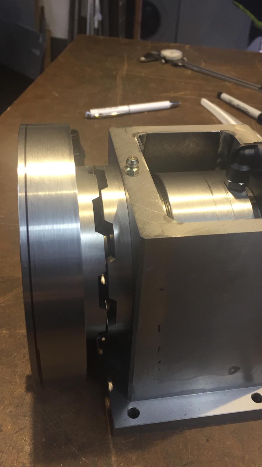

Myself and a friend are currently building an 8 station ATC for our lathes. its uses a Hirth style connector instead of the ratchet and pawl so all the holding force is managed by that.
The tool plate will be rotated by a stepper motor so in theory it just needs an initial index and then move a set amount of steps to the desired tool position. we have based it on the Denford ATC which uses a 3 ch greyscale to confirm tool position and my mate wants to copy this design so we can confirm tool position at the end of the change sequence. Whilst its not a massive amount of work Im not sure it is required when the tool plate is self centring and using a stepper motor for position.
Are there any other ways to confirm tool position or it complete over kill in use?
You could use just a single home position sensor, but the added complexity to add a gray-scale (and strobe, ideally) isn't huge, and adds a fair but more robustness to the system.
As far as I can remember the linuxcnc "carousel" component needs at least an index pulse for each tool and a home sensor for tool 1. So if you reduce complexity in the hardware you will be adding some in HAL to deal with your system.
I imagine that your reluctance to add multiple sensors is due to using a parallel port and being short of pins?

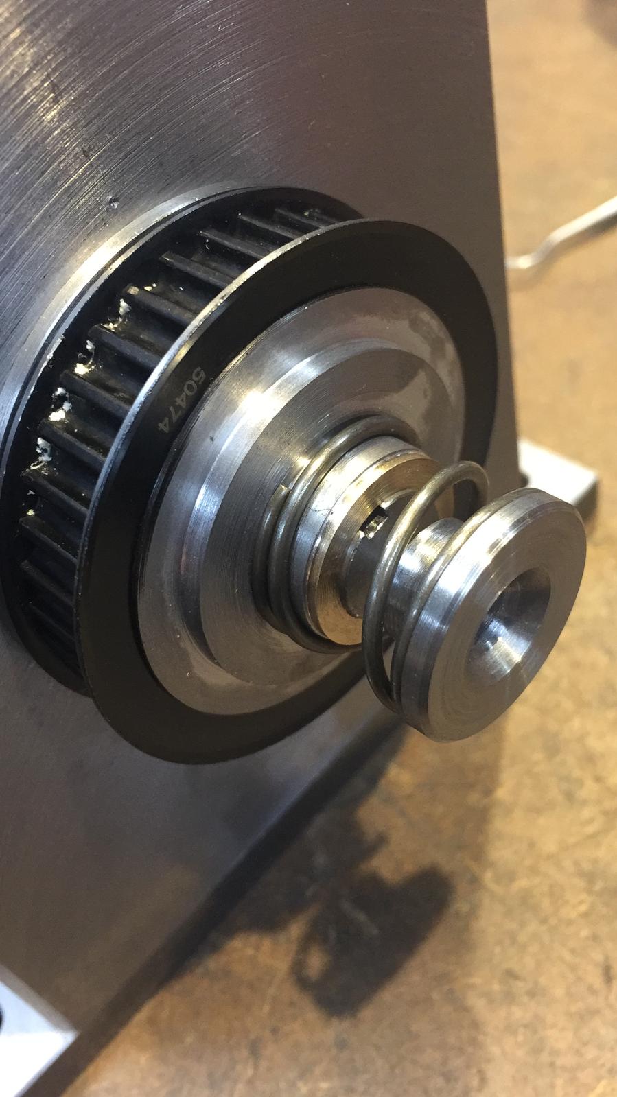

I did consider that but we cant get an encoder on the main shaft and the stepper is on a 3:1 ratio so the index wouldn't work. The Hirth coupling is self centring so the stepper doesn't have to move perfectly to the desired position. its more just to confirm it is in the correct tool before the cycle starts.
