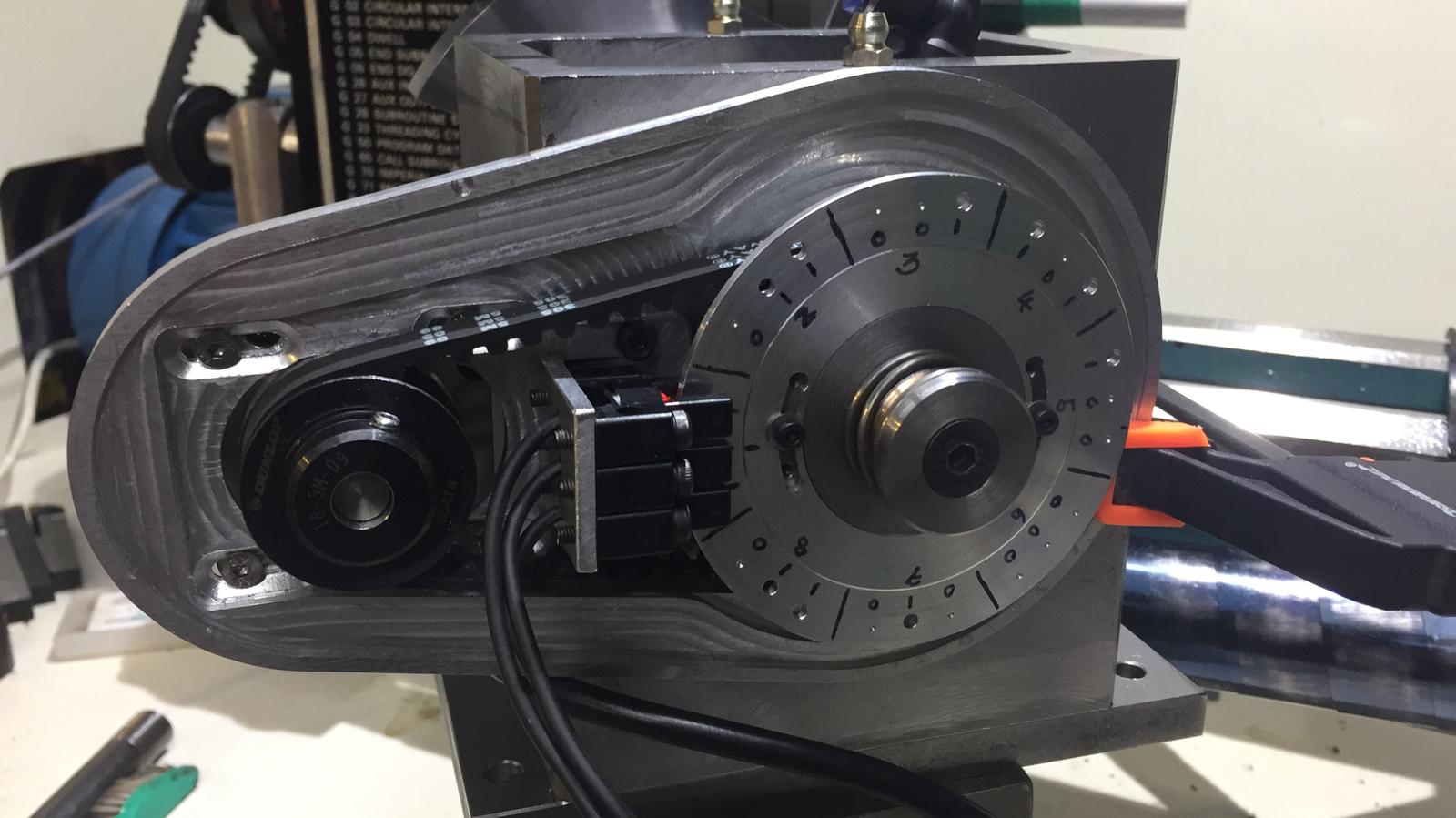

The pulley remains stationary (axially) and is on a key way to allow the shaft to move in and out. the flange on the pulley is machined to take the encoder disc.
I agree that a machined disk is the way to go. going to test how much depth there is on the edge sensors to provide 3 different radial sectors.

19 Aug 2019 18:10 #142527 by Ross77
Replied by Ross77 on topic ATC senor options
Slow progress but we are getting there. Went for 3 sensors all in a line and the corresponding Gray scale code holes in the same radius.
We are only using it as a check once in position rather than identifying the position to stop at. works well so far and have it running ok on the bench.
The last issue is the home switch. we have planed to add a 4th sensor purely as a home switch but space is bit of an problem. the sensors a have dual outputs so one option is to feed the second O/P's into a 3input NAND gate and generate a home signal for tool position 1 (all On) Does that sound like a good idea or overkill and it could be done in classic ladder of similar to generate the home signal?
Or any other ideas that I have missed, problem is getting it to work on Linux and Mach3, cheers
20 Aug 2019 05:37 #142573 by andypugh
Replied by andypugh on topic ATC senor options
I think that a 4th "strobe" signal to indicate that the disc was in a valid position would have been a good idea. With the current arrangement it is hard to tell the difference between 001 and (for example) 111 that is just coming in to position. (Also, in this application there isn't really much point using Gray-code, but neither does it do any harm).
Without a strobe I would say that you do need to synthesise a home signal, and the all-on position does seem like a good way to do that.
For the LinuxCNC application I would not bother with any external circuitry, do it in HAL or inside the component that controls the changer.
I don't think that the LinuxCNC "carousel" component can work with this encoder style, as it looks like there are times as the holes move in to place where (for example) the bit2 hole is in front of the bit0 sensor?
If this isn't the case then it probably can be made to work. Are the forks deep enough that the holes can be drilled on three different radii so that each sensor only ever sees its own hole? if that can be done then the strobe signal can be synthesised in HAL from "NOT all off".
Thinking about this, it would probably be good to add a new parameter to the carousel called something like "ignore-zero" for systems like yours, where if no sensors are active the position feedback is ignore (as when strobe is not set) . I don't think it is too late to add this for the 2.8 release.

20 Aug 2019 15:57 #142644 by andypugh
The index sensor was going to be a single slot for accurate homing, are you talking about a 4th bit of grey logic to confirm position?
Yes. If you had that then there would be no need to home, the system would know where the disc was any time that it was in a valid position. That would require a slot at each position, though.
So would that work with our current config?[/quote]
Not if you can have the disc part-way aligned with a sensor active. You either need no sensors active if out of position, or a strobe to say when the disc is in-position.
Much smaller slot detectors exist: uk.rs-online.com/web/p/slotted-optical-switches/6666511/ is almost certainly _too_ small but would potentially work nicely with a 3D-printed target disc: a360.co/2ZpE9sM
(That design is actually for a slightly bigger version with a 3mm slot width, and is binary coded.)

20 Aug 2019 17:36 #142652 by andypugh
That's a pretty neat solution, I suppose it really needs the sensors on a PCB for alignments, compactness. and to add the transistors to boost to 24v output.
Yes, but then a batch of 10 PCBs costs $5 from China:
www.seeedstudio.com/fusion_pcb.html
If I can get out current 3 sensor arrangement to work on 3 separate radi then could we get that to work with Carousel and then rework the sensors later?
Yes, I think so.
I also see that carousel is for dc motors with Geneva gears, is it easy to modify the code for stepper motors?
Take a look at the enhanced 2.8 version of "carousel", it has a lot more pins and can be connected directly to a velocity-mode step-generator:
linuxcnc.org/docs/2.8/html/man/man9/carousel.9.html
