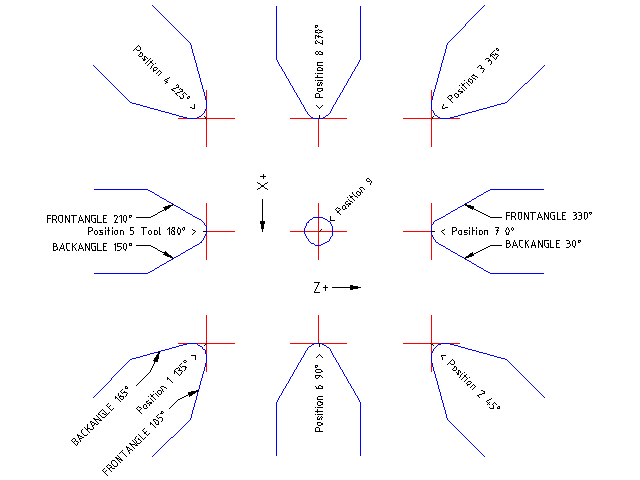

I want to use my diy cnc lathe tool orientation like we do everyday work in manual metal lathes.
What are settings?
3. Lathe Tool Orientation
The following figure shows the lathe tool orientations with the center line angle of each orientation and info on FRONTANGLE and BACKANGLE. The FRONTANGLE and BACKANGLE are clockwise starting at a line parallel to Z+.
linuxcnc.org/docs/html/lathe/lathe-user.html
What are settings?

you can have the tool on the front or on the back of the part
therefor the settings are different
gnipsel.com/linuxcnc/g-code/lathe02.html

My tool orientation like manual lathe.
Where is it?
I couldn’t find it!
Where is it?
I couldn’t find it!
