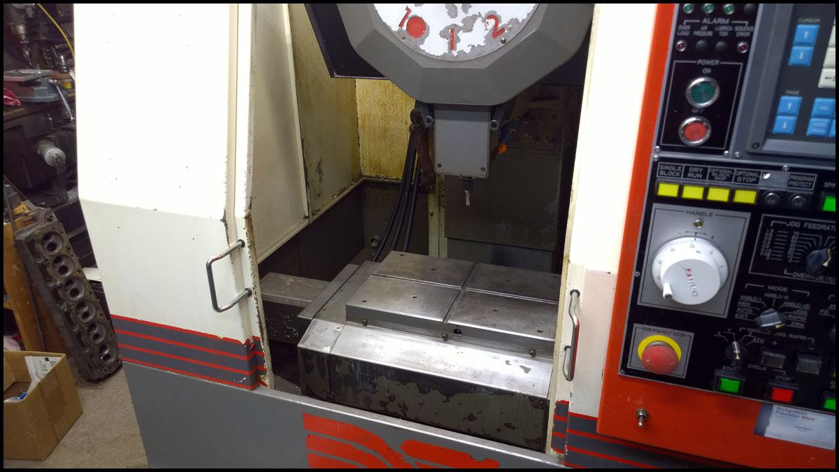

Hello:
This is my first post to the forum, but I'm not a complete stranger to Linuxcnc. In the early 2000's I converted a Sherline mill with EMC2 and had enough problems with unstable computers to get a fairly good education by the time it was working well. Since then I have built up a fairly nice manufacturing center at my home including a Hardinge DSM-A automatic turret lathe with bar feeder, two Omniturn Hardinge gang tool lathe attachments, a 1992 Kira mill/tap w/Fanuc O-mate control (same footprint as Haas Super Mini Mill), Dyna Myte 2400, Manual support equipment...etc.
I've managed to do pretty good biding my time and buying old machines for cheap that have significant life left with a little know how.
That being said, one issue has been driving me nuts for about 6 years. My first Omniturn, which has given me flawless money making service for 15 years is quirky and old, but simple and easy to use, I've upgraded it with an LCD screen and an SSD, and I'm satisfied with its performance at this time( except it could use a poly V belt conversion). My second Omniturn was purchased because my product lines were keeping the other machine to busy to use for prototyping new products. After a new ball screw and a few electronic upgrades, I fired the machine up and promptly found out something I had previously unknown about Omniturn lathes...
They had an early version of there control, produced for only a year and a half from 1991-93 or so, that is frustratingly different and annoying to use. The setup procedure for the tools is esoteric to say the least, and you must call a G92 after each tool call. There are also quite a few minor differences in the controls that make it difficult to determine if you have set your tools correctly. Anyway, I hate using it, and only set it up if absolutely needed. I thought I had bought a replica to my other machine, but it just looks the same, even the control screens, the little differences make you realize why they changed it. Even Omniturn said I would hate it...however, they want more than I paid for the machine to upgrade the control.
Finally serious about fixing the problem, and since I'm considering other upgrades in the future such as C-axis and live tooling, I figured doing it myself would be the best option. Linuxcnc lathe support is much stronger now than when I first looked into this years ago, and I'm not fond of Centroid or other companies offerings.
Parts have arrived and more on the way, this is the new hardware:
AS Rock J3355B-ITX MB
4GB 1333mhz memory
3GB Industrial SATA Dom SSD
Mesa 6I25/7I77 combo
Old parts to be reused:
All four motors on both machines are the same and I can't find any detailed info on them...company long gone and no datasheets.
However, I was able to piece together information from various sources and took them apart to figure out the encoders.
The two motors in the machine to be converted are:
Quality Motion Control QMC 33DCMTE 2514-1
These are DC brushed servo motors with analog tach and TTL encoder output. Powered at 34V DC in this machine.
Encoder is a Renco 77822-033 which is also obsolete and I can't find data sheet. However, I did find a pinout. And it is a 5V TTL quadrature encoder with 1000 PPR
Interesting thing about the wiring for the encoders. they cut back and disabled 3 of the signals. A-, B+, Index- ...
Doesn't this mean the usual 4000 counts are 2000 for this application? I guess it doesn't matter since I can attach the extra wires to the 7I77, but it would be interesting to hear any thoughts on why this was done.
The servo amps in this machine are Z-axis:
Glentek SMA 7110-1. I can't find a full datasheet, but I did find a PDF product flyer here: Servo Amp Data
The amp appears to be wired for velocity control using an analog tach feedback, but is capable of torque control.
I called Glentek, and they confirmed the amp series, but said it was an OEM part number and he could not release the option settings, however tracing the wires and a voltmeter should tell me whether active high or low on the pins that matter.
X-axis:
Advanced Motion Control 25A8D-NC1 25 amp 80V
Can't find much of anything, but is wired the same as the Z, might be a later replacement. But I am going to assume they are meant as equivalent because my other machine has two identical Copley amps on the X and Z.
I'm not to worried about the electro mechanical retrofit, I've been doing this kind of stuff for 30 years in both home and commercial industrial environments...but as anyone who has tried this kind of stuff before, the devil is in the details.
My questions and reason for writing all this, is I'm trying to decide about the overall setup configuration.
So given what I have said here, would it be better to stay with velocity with tach feedback, or try to implement torque control? I don't really understand the ramifications of the differences for my application.
Is a touch screen worth the investment, or is a keyboard and MPG better, or both?
Is there anything I haven't thought of I should be?
Anyway, thanks to anyone taking the time to read this and respond if any insight is to be had. And I'm more than happy to provide more info if I forgot anything important.

HI
so as yoiu got alot of expiriance
and with the Help here you will be running soon
the cutback is as the old electronics from fanuc does only suport a positiv A/B and a negativ Index
they dident change this until the 2010 production change in control
is the mashine equipt with the 12ATC as the Haas is

I would use the drives as configured if they are currently working on your machine. They are tuned to match your setup.
Just simply read in the encoders either single ended or differential to the 7i77, hook up the analog control 10v signal, add a drive enable and estop circuit and you should be good to go.
For best performance you'll have to do final tuning to match linuxcnc to the machine. Which will be easier if you didn't tamper with the drive settings.
Replied by OT-CNC on topic Early Omniturn gang lathe to Linuxcnc?

Thanks OT-CNC, that's exactly the kind of thing I need to hear. I figured the smart thing was to leave it be, but just wanted to make sure there wasn't a significant reason to change.
I received the Mesa cards today, downloaded and burned an ISO, cleaned up my work bench, hooked up the MB and PWR supply, and...nothing. Power and fan come on for a split second,red led on 6I25 card on for the same split second, then it all shuts down.
I am not used to hooking up systems outside of an enclosure, so maybe I'm doing something wrong.
Unfortunately, since I've never had a new bad power supply, I made the mistake of cutting the wiring harness back and soldering in a 5v lead for the SATA Dom SSD. So at this point I hope it's the mother board so I can return it. No other ATX power supply on hand. Oh well,
back to the drawing board.
