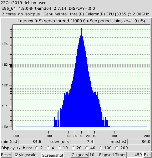

22 Oct 2019 00:39 #148506 by PCW
Replied by PCW on topic Early Omniturn gang lathe to Linuxcnc?
Looks like something is not setup right on your motherboard
Do you have all speed switching and cstates > C1 disabled in the BIOS setup?
I get this with the Stretch ISO on a ASRock J3355B, no isolCPUs
(youtube video running and 10 glxgears)
22 Oct 2019 01:51 #148510 by PCW
BTW the way to get the tmax values is
halcmd show all *tmax*
(those are not quotes but asterisks)
