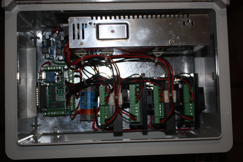

I am planning on controlling a Sherline lathe with Linux CNC. I will be using the Sherline Nema 23 motors, and I have a computer. What else do I need? I see Sherline has a '4 axis driver box', but I think that is expensive.
Unless I am missing something, I only need 2 axis, but I am not really seeing much labeled as such, lots of 3 and 4.
I also see driver boards, breakout boards and power supplies, I am not sure which of these I need.
I am thinking I can just initially set up the motors to whatever to play with Linux CNC and when I get everything working connect them into the lathe.

You would need
Breakout card(there are some on eBay for as low as 6 dollars)
2 stepper drives(1 for each axis)
2 steppers
1 switching power supply( will support 3 drives some are adjustable for voltage)
Some 18-22 gauge wire.i used 18 for power and motor wires and 22 for limit switch.
Motor mounts,
Sherline has a couple CNC kits, I think they have one with just adapters for bolting up the steppers.
Also if the PC doesn't have a parallel port will need a paraport card, and cable.
2 steppers
Motor mounts,

I have this one(one like it )
rover.ebay.com/rover/0/0/0?mpre=https%3A...2Fitm%2F282099594144
A Chinese power supply from Amazon
You could probably use a lower voltage one a little less expensive
MYSWEETY Adjustable DC Power Voltage Converter AC 110V-220V to DC 0-60V Module 60V 8A Switching Power Supply Digital Display 480W Voltage Regulator Transformer Built in Cooling Fan www.amazon.com/dp/B07HGQXW9V/ref=cm_sw_r_cp_apa_i_Hid0DbYCE88CM
One drive option
www.automationtechnologiesinc.com/produc...pper-drivers/kl5056/
One drive option
Last edit: 16 Nov 2019 17:42 by Leon82.
