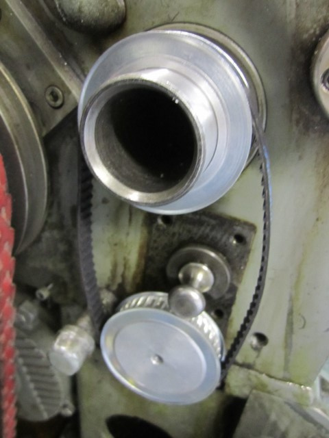

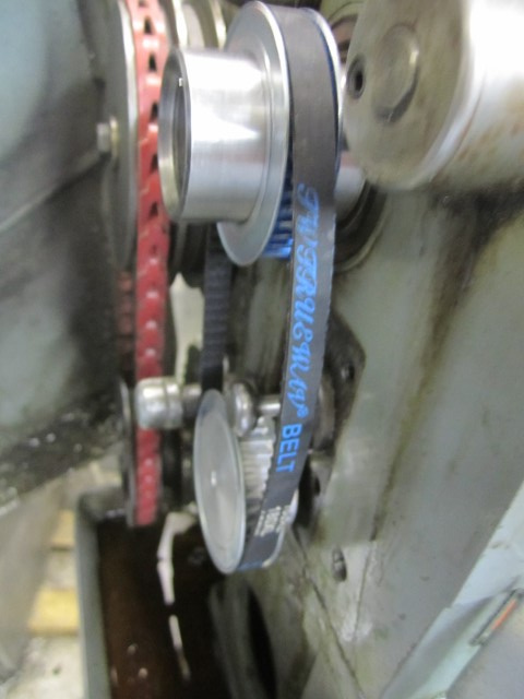

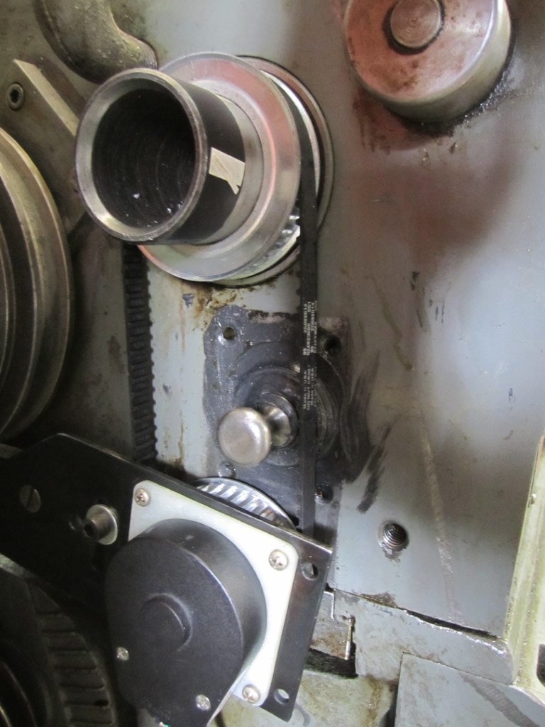

Another small step forward
Timing gears showed up yesterday and I've got the one bored out (lathe works but pretty awkward without a pendant or any form of MPG:) and fit to the spindle tube. Hod ot machine off the existing hub completely but it's the smallest one I could find that still had enough meat left once opened up
Now to make some form of bracket to hold the encoder down below there and run some wires.
Once the encoder is working I thing can move on and tackle the gears
